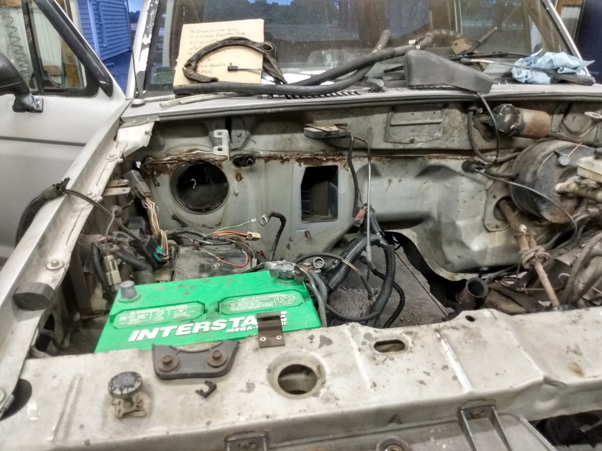

Hate cheap new parts but sometimes there really are no options. Trying to be preventative in repairs and replacing parts while the drivetrain is out and get the "best" heater core I can find online wrong size, have to bend the tubes to get it to go in place, had to replace the isolator with a thinner one to let it fit, all around cheap junk.... Probably should have left the (clearly) original one on place and would have been better off. I kept it don't worry..
On the positive side...
If you ever have to replace the core in the future... it's probably the easiest heater core to do.

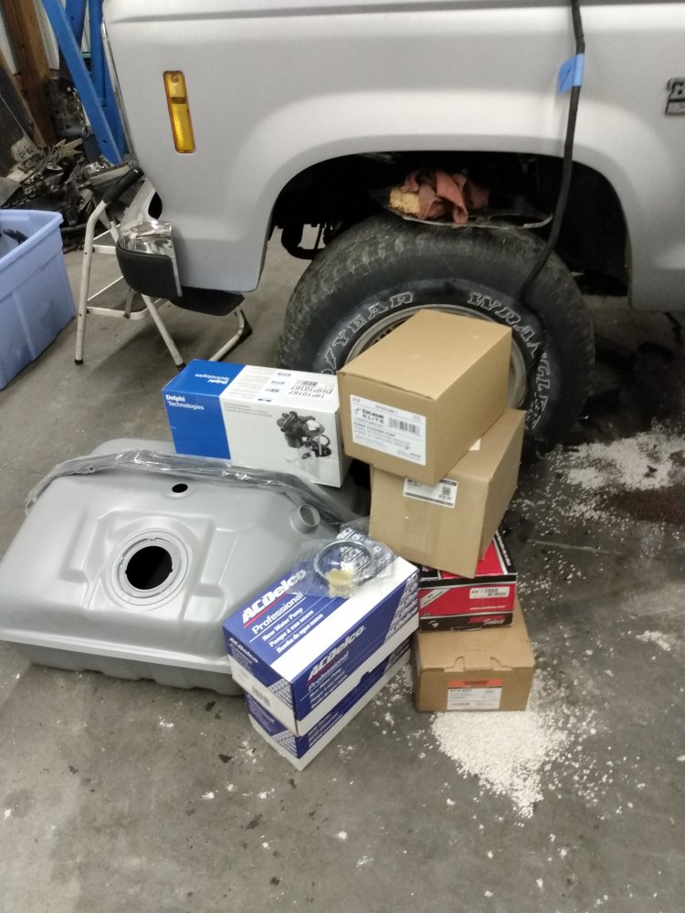

Well parts are coming in and there is a pile waiting on me.. still waiting on the heater box I ordered off of eBay weeks ago and the USPS is just steady not working so it's stuck in Richmond less than a 1/2 hour from me... And some free time, that sh!+$ hard to come by.

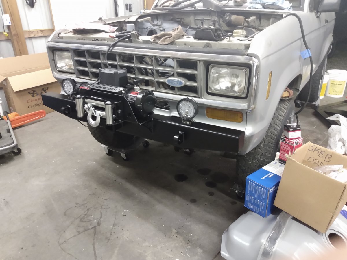

So the powder coater called and said my bumpers were done.. Now don't get me wrong I am NO where near the need for bumpers, but they are motivational and mounting the front one cleared up a little room in the garage (that's my excuse for mounting it tonight). Pretty pleased.

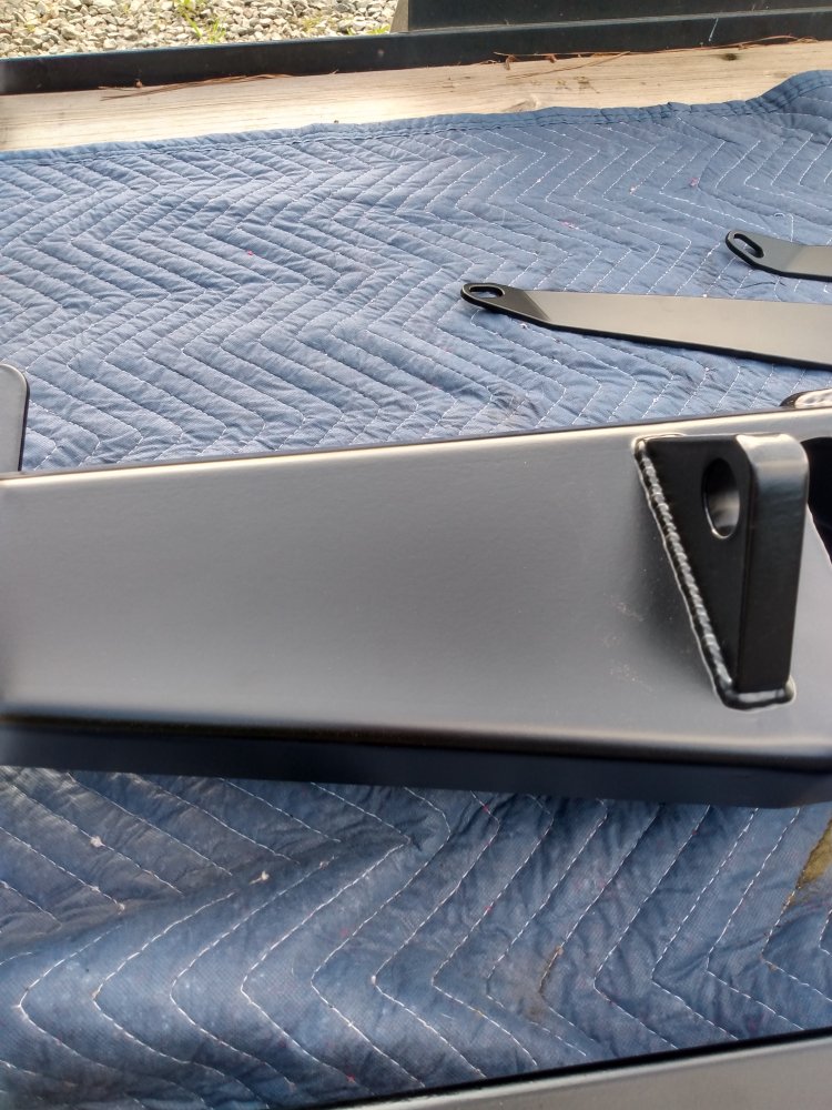

I'm going to be curious how well that rear bumper holds the weight of the spare when swung out. I have their earlier style rear bumper and did my own tire carrier and I get a lot of flex in the bumper. I also see some brackets next to the rear bumper... those appear to be for mounting the rear bumper? Did you fab those or are they an offering at AOR? They appear to be spaced for a body lift... no? Maybe if you have time you can tell me more about them.

So the rear is the bumper/carrier for the Rangers... I spoke w/ Brady when ordering because I wanted the front bumper less light /pre-runner style tube and asked if they would fab one without it which they did no problem. He said they have had people use the rear from the later trucks and make it work so I wanted to mock it up and see what changes would have to be made but when it came in raw steel I didn't want stuff sitting around and rusting up and I am sure I will be quite a while before I get it mounted so I just went ahead and got it coated. All of the brackets came with it so I am not sure how exactly they will work or if I will have to modify any of them. I am hoping running a 32 I wont have to stiffen the carrier up but if I do it is what it is... The bumper has the pivot shaft welded all the way down the inside so hopefully it will be strong enough, but again we will see. I will be rather sad if I have to weld on them and grind the coating away but that's my fault for not test fitting. But t will be doing fuel tank, lines and brake lines before I put the new bumper on while the old ones off.. I just couldn't resist last night mounting the front on. :)

Well I sent them an email asking about the brackets and braces. When I bought mine it didn't come with mounting brackets. I see on their site that if you buy the bumper w/carrier it comes with the brackets. I used the factory mounting brackets and added the factory braces and did some welding to try and reinforce the factory stuff. I think most of the flex is coming from the bumper brackets and planned on making a new set to try and correct it. If I can just buy theirs... it makes life a bit easier. In my opinion they do super work and they probably have the flex/twist thing I'm having already figured out.

To me... those brackets look they are made for a bit of body lift... di you order them for a body lift or no?
@Uncle Gump I did not. I didn't specify anything and did not see any option for that when ordering. I can send you some better pics when I get home tonight if you want. Hopefully not but if so we'll break out the cutting wheel :rolleyes:, and rattle can I guess..
