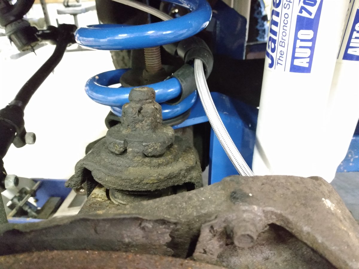

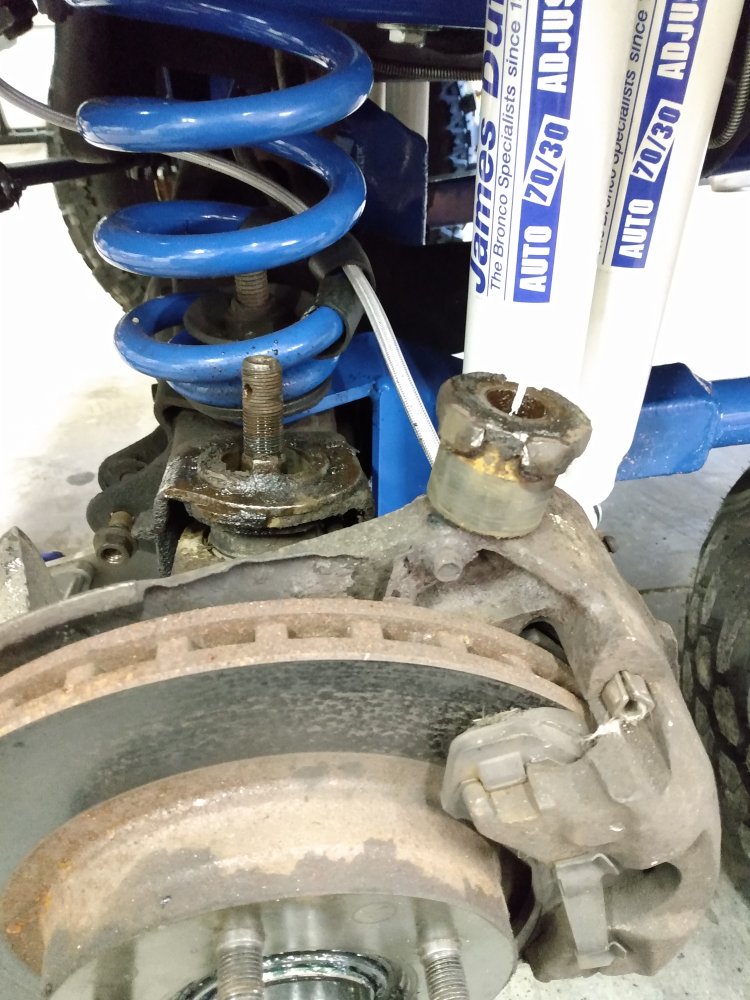

Give me your thoughts. I am hoping by going on the lowest coil it should be fine as far as compression of the spring.
I would try to clamp it to the spring so it cannot move into a place to be crushed. Or move it elsewhere and clamp.

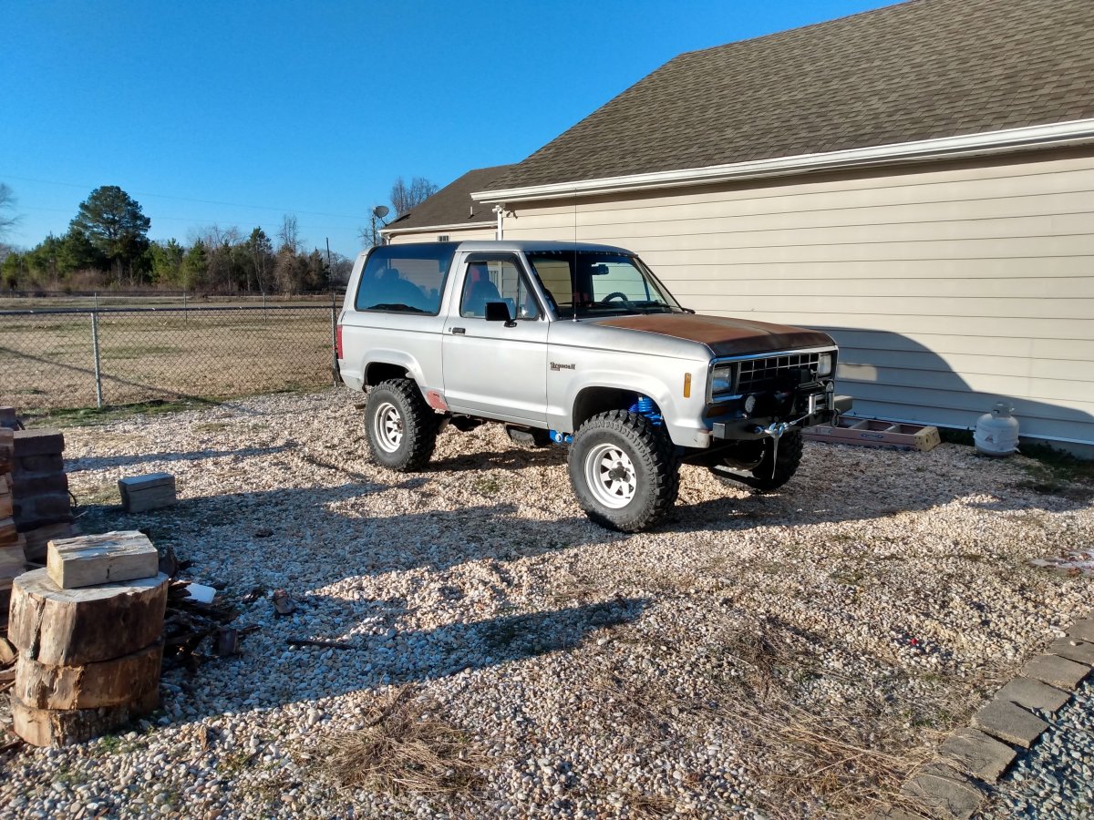

So the ditch in my front yard was perfect for checking clearances. Pretty happy. Everything seems to clear fine.

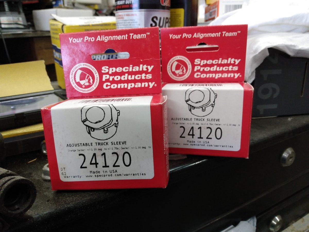

Well got the axle pivot shims in, forgot to get pics, and caster camber bushings. Pretty pleased. Time to get it aligned now!
Axle shims were 2.5 degree. Between those and the u joint style shaft angle looks perfect. I'll get pics.

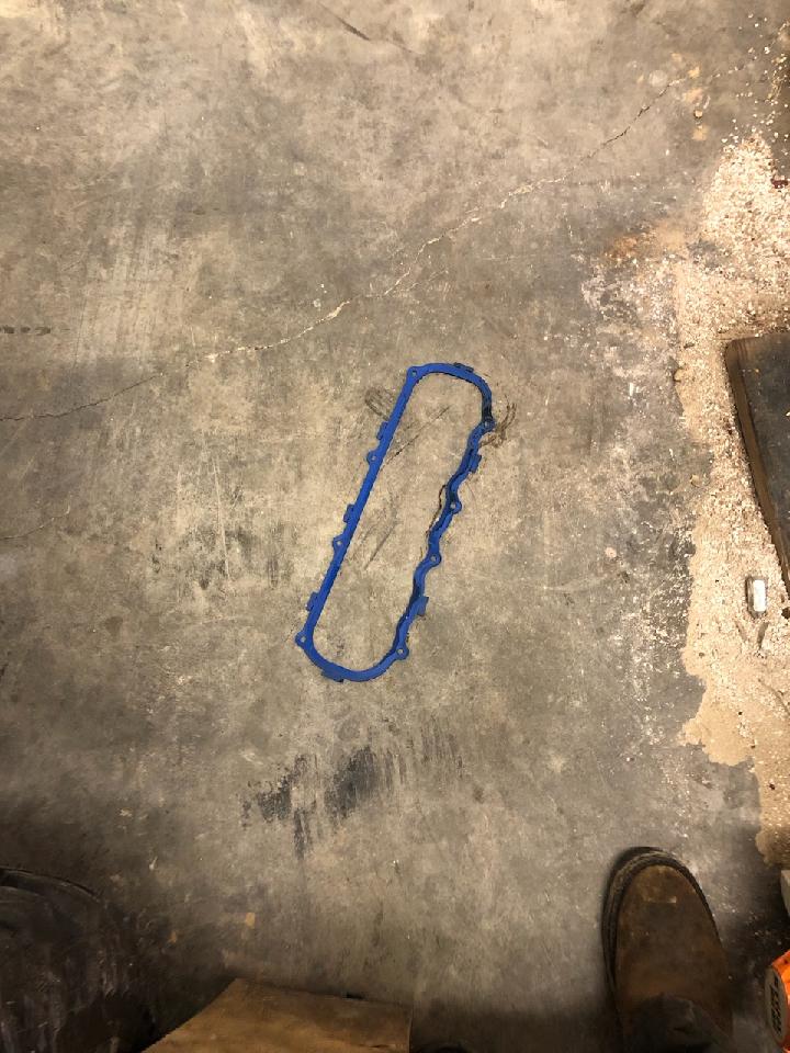

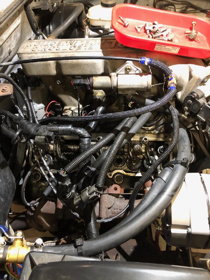

Resealed the valve covers. Got some Permatex gaskets. Don't buy the reinforced ones from Rockauto. You'll get silicone all rubber ones... Repainted them as well but forgot pics.
Old gaskets removed
Worthless silicone gaskets
$50 gaskets from Rockauto that are reinforced
Nope just kidding same shit you had, worthless
Correct # from Napa. Sorry for lack of pics...
