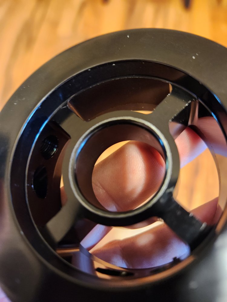

Yeah... I think it's gonna be a problem. Two wire sender or mechanical gauge... no issue. Single wire sender... problem.
I'm gonna try to drill and tap a hole in one of the pipe plugs to add a ground. Unless there is enough meat on the adaptor to drill and tap.
Yeah I mean in theory the threaded adapter should provide a ground but I am sure there is resistance. I could check with a meter tonight and see what it is from sender threads to g post I bet it's a decent amount.
In fact I believe I will test that, and start by removing my sender and I am going to run a tap into the thread holes and retest. If that doesn't clean up the reading enough I will then debate on how to add a better path.
Well... my thoughts were that the threaded adaptor should provide enough ground too... but... it tightens up against the powder coated surface of the sandwich adaptor. Not knowing how conductive powder coating is why I figure it would be a problem.

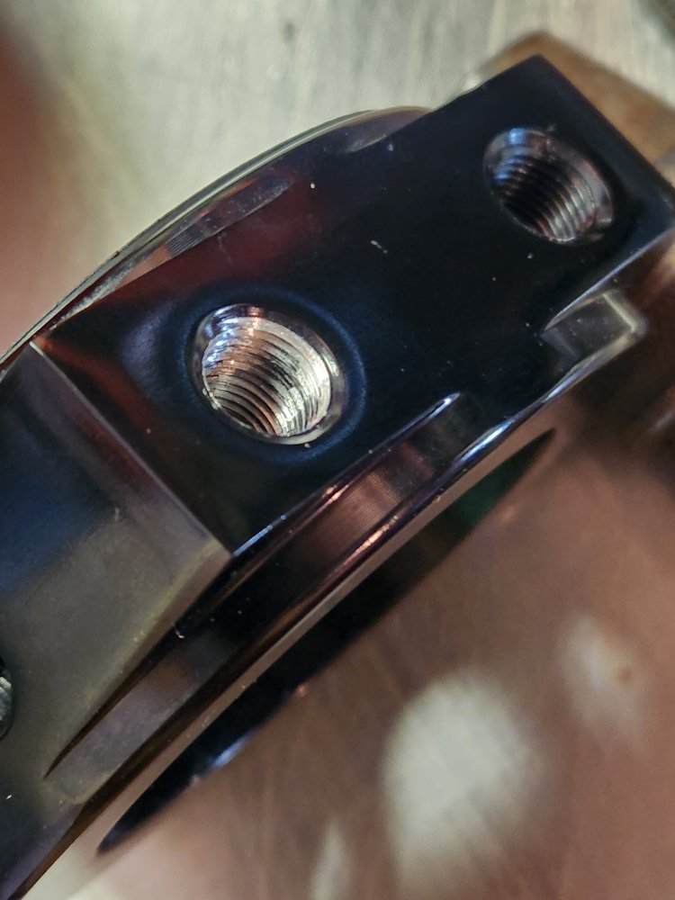

I just pulled my adaptor out of the package and had a look. It appears on mine that there is a ring around the threaded adaptor bore that has no powder coating. That itself should provide a path to ground once the threaded adaptor is tight. But... always a but... all the drilled pipe thread holes are all completely covered in powder coat. So... with a wrap of pipe thread tape and the powder coated threads the sender might not get good contact with the sandwich adaptor. So I'm going to run a 1/8 pipe tap down the hole that I will use for the sender and see where that gets me.
I just run an 1/8" pipe tap down a sender hole and cleaned up the powder coating.
I also lightly hit the adaptor fitting hole to define that a bit. I think I will test it before it ever goes on with my ohm meter.

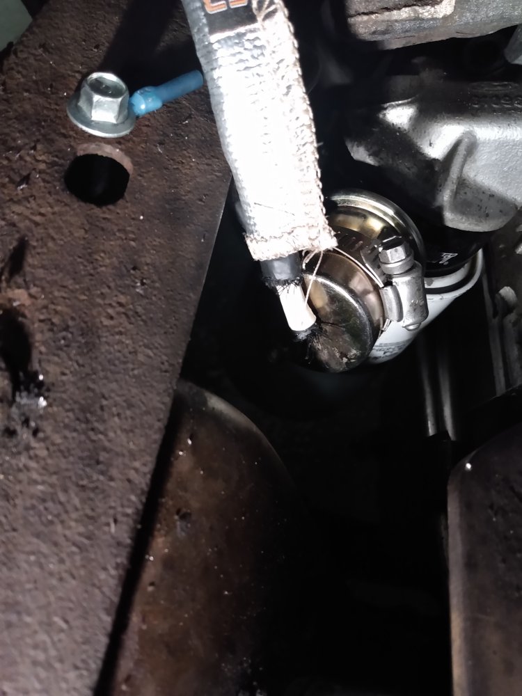

I don't recall.. I wasn't the happiest with it's installation seemed like it always wanted to leak so I Loc-Tited the inner threads. I came up with a "solution". I can't say it's one of my more proud moments but I think it'll work fine. No name calling for this either! I got a hose clamp that fit nicely around the sender body. I then stripped back about 1/2" of insulation on some 16ga wire and fed it through one of the thread slots of the clamp and soldered it back together then shoved heat shrink down as far as it would go and sealed up what I could, only solder showing. I know it's prone to corrosion but what a simple easy fix. Ran said wire to frame tapped a hole and put an eyelet on it and boom, I got ground. Dare I ask, thoughts ..? I know it may fail but I bet it'll last quite a while and super simple fix in the future.
I'm surprised it leaked. I've even had mine off on my truck when I switched from mechanical to electric gauges. It's never leaked.

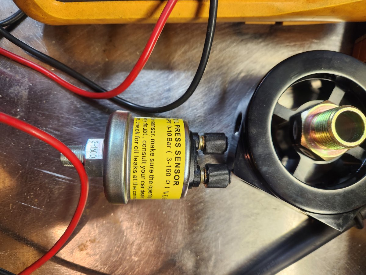

I was going to bench test mine but when I grabbed my Fluke meter it had a dead battery... cause I left the damn thing after I tested my fuel sender. I can't find another 9 volt so I'll have to pick one up tomorrow.
As for your "repair"... at least you know it works. Lol. You got some plow boy in ya son.
I'll let you know what I find out with mine when I know.
Haha whatever works right. Honestly not much different than a grounding strap on the back of the head to the firewall, they don't fail. Long term fix I'll probably try to find a two wire sender and ground out one side to frame and other to gauge. That thing had a ton of resistance through it though.
So I got a 9 volt battery and checked my adaptor. It ohms out at .1 ohm. So I thought I would Teflon tape the sender and screw it in and see where I was. I dug to the bottom of my parts box and what do ya know... it's a two pole sender... I could swore it was a single pole.

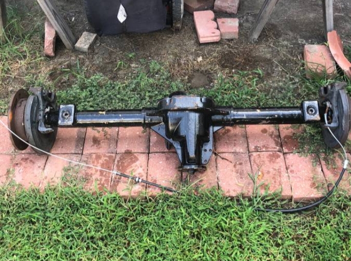

Can anyone identify this if it would be a safe pick up for me to use in the Bii? I am more concerned with finding a D35 but of I can get this for $100 or so may be worth it?
I don't know enough about them to give you an expert answer... but I didn't think they came with rear disc brakes back in 92. But I could be wrong.
I will do a bit of looking at mine today for comparison.
Free would be a good thing.
AFAIK the change to rear disc came with the body change in 95. Seeing as how one rotor is on backwards tho... Who knows what they have there.
