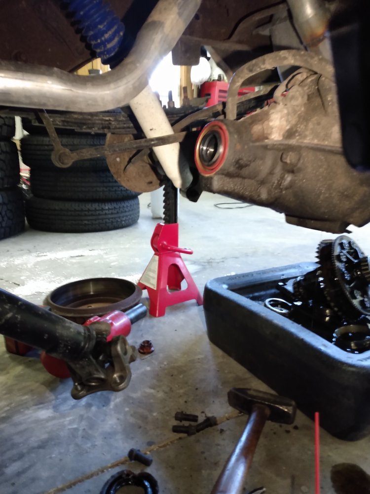

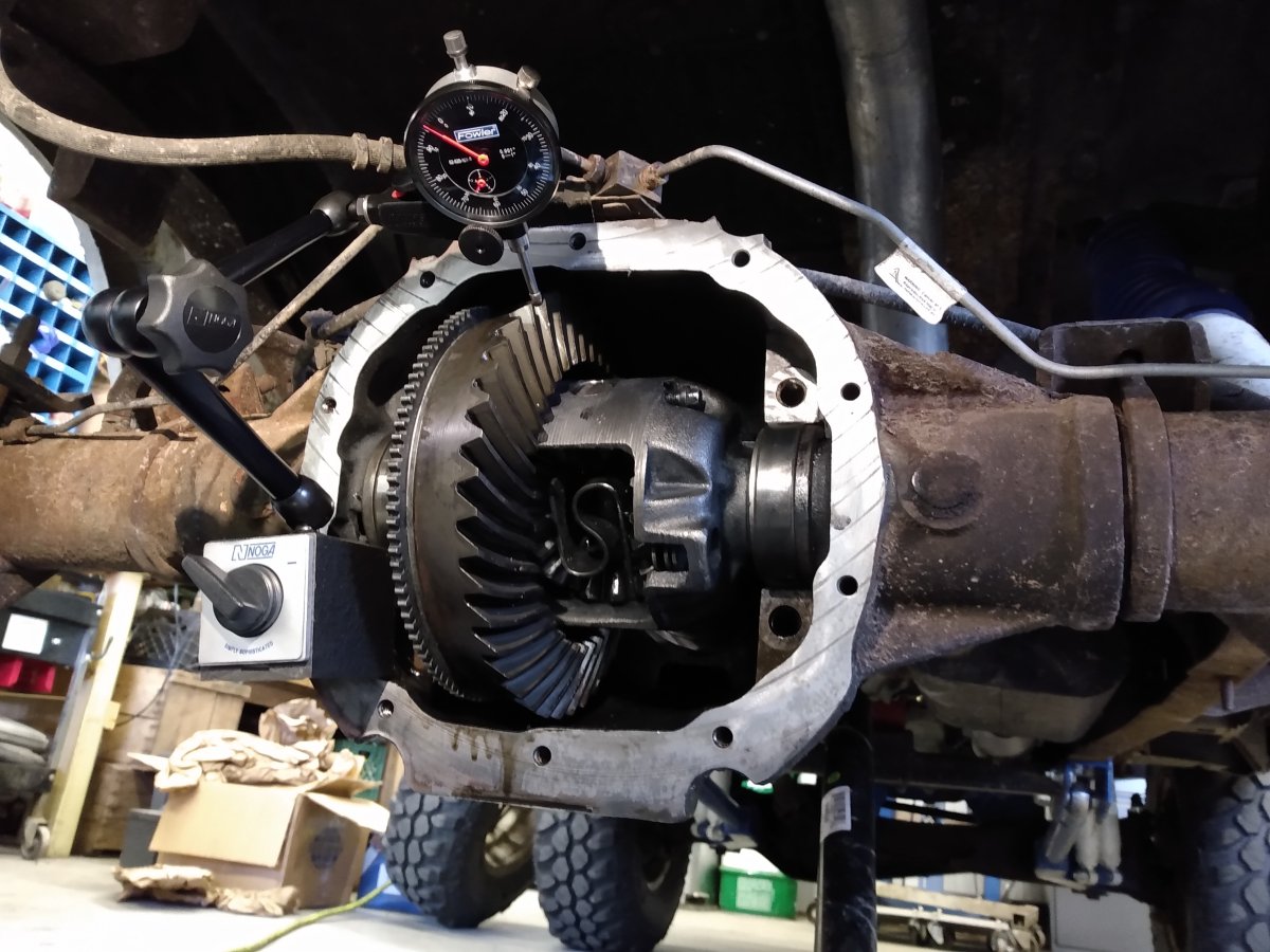

Well it's back in the shop tonight. Feel bad taking my 250 out but only for the day. It's supposed to be in the low teens overnight ( I was running in shorts and no shirt Monday night with the sun going down).. gotta love The Commonwealth. Anywho plan to swap in the limited slip carrier I got from @corerftech. Can't wait! Guess I'll be burning some propane.

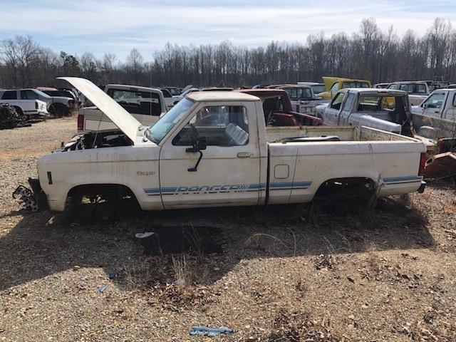

You gonna pack an extra clutch disk in on each side while you’re at it?
I just put new clutches in the one for my green Ranger and added an extra clutch disk by pulling one of the steel plates
Hmm never heard of the technique. I honestly don't know that the little 2.9 has enough power to need much more but, do tell. Can you explain thought/theory? Just packing clutch tighter?
So there’s a write-up in the tech archives, but basically, you pull the clutch packs out, and swap a steel plate for a clutch plate.
Center pin comes out, S spring comes out, rotate the spiders out, then under the side gears on each side is a stack of clutch and steel plates and usually a shim. Keep the shims separated by side (mine actually stuck in the carrier). The stack of plates will be something like clutch/steel/steel/clutch/steel/clutch/steel. Pull one of the doubled steel plates and then add a clutch to the end so it’s clutch/steel/clutch/steel/clutch/steel/clutch. Re-assemble the way it came apart.
Supposed to make it work more like a locker and less like a limited slip. My choptop has a 7.5” in the rear that supposedly done that way. I will say, it digs with both rears and does act more like a locker in that truck. That said, the un-modded limited slip in my 92 worked really well, but I think there is a little unpredictability to the un-modded.

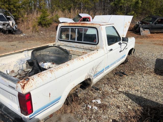

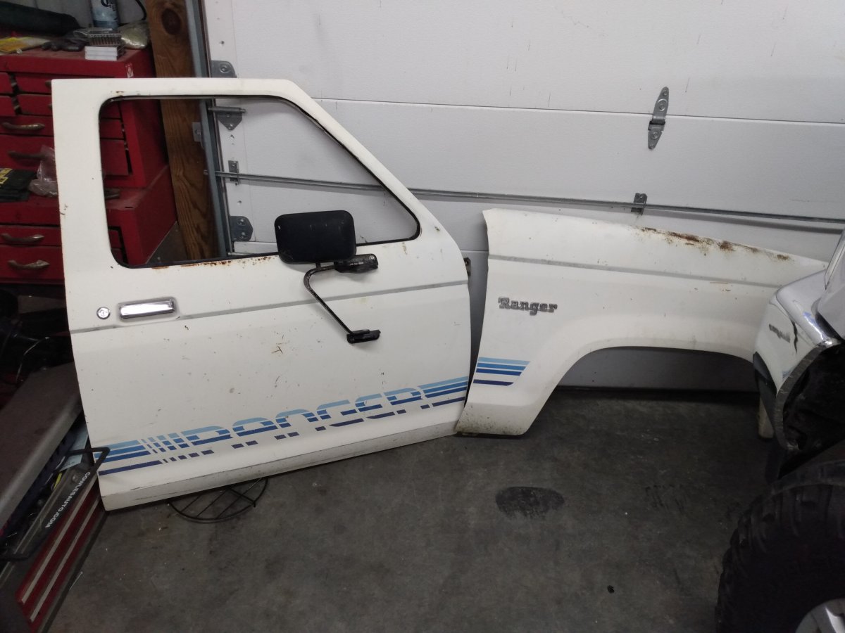

Well I am not sure of others opinions on this "lack of style" I guess you could call it. But when my main harnesses had to be swapped and I lost all wiring going to my power windows (which I prefer manual crank anyway) I didn't feel like tackling window regulators and windows etc.. that being said I have made equal work for myself with this project.. But I decided probably be pretty easy to find some donor manual window doors, found a good driver one in NC a while back, manual crank 0 rust and a vent window, who knew what a hard combo to find. But once that was placed on the truck the multi color grew on me as well as the fact of not hiding the donor vehicles history. Honestly too, I just kinda like the look. Not for everyone and don't care of criticism. But I decided with the look growing on me and knowing it wasn't going to get painted I chose to find or attempt to find some really cool either patinad or graphics door from another poor RBV left to die in a salvage yard, and let one more live on a little longer in my Bronco project. Well luckily I get to travel a good bit and my trip last night to Greensboro NC revealed EXACTLY what I hoped to find. Only wish I could have saved the whole truck. The 80-90s graphics be it cars, trucks, signage or boats has always been a favorite and that's just what I found. Came away with the door and fender( had to take it off to do the door and mine is cracked up around the mounting bolts) for $115. I am stoked with this, although I do have to convert it to a vent window if I want it to match. Either way I know there will be criticism on my decision or at least unspoken criticism but I don't care. It's what I wanted! And now that I'm $10k plus into this little thing I'll make it just how I want 🤣🤣

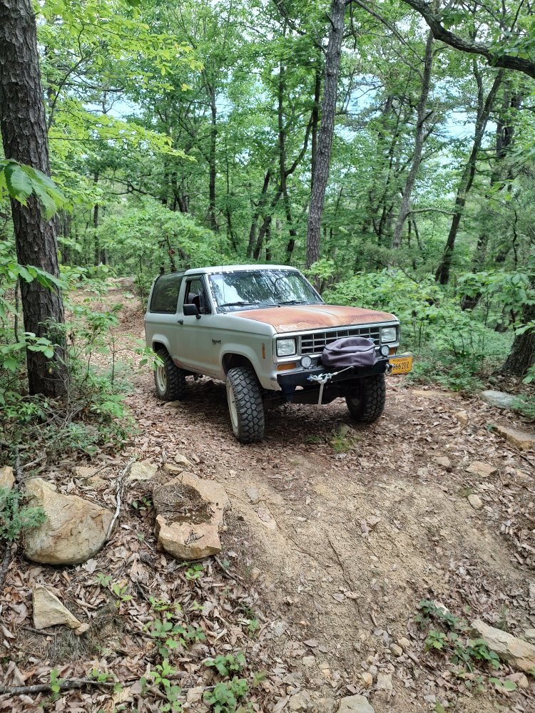

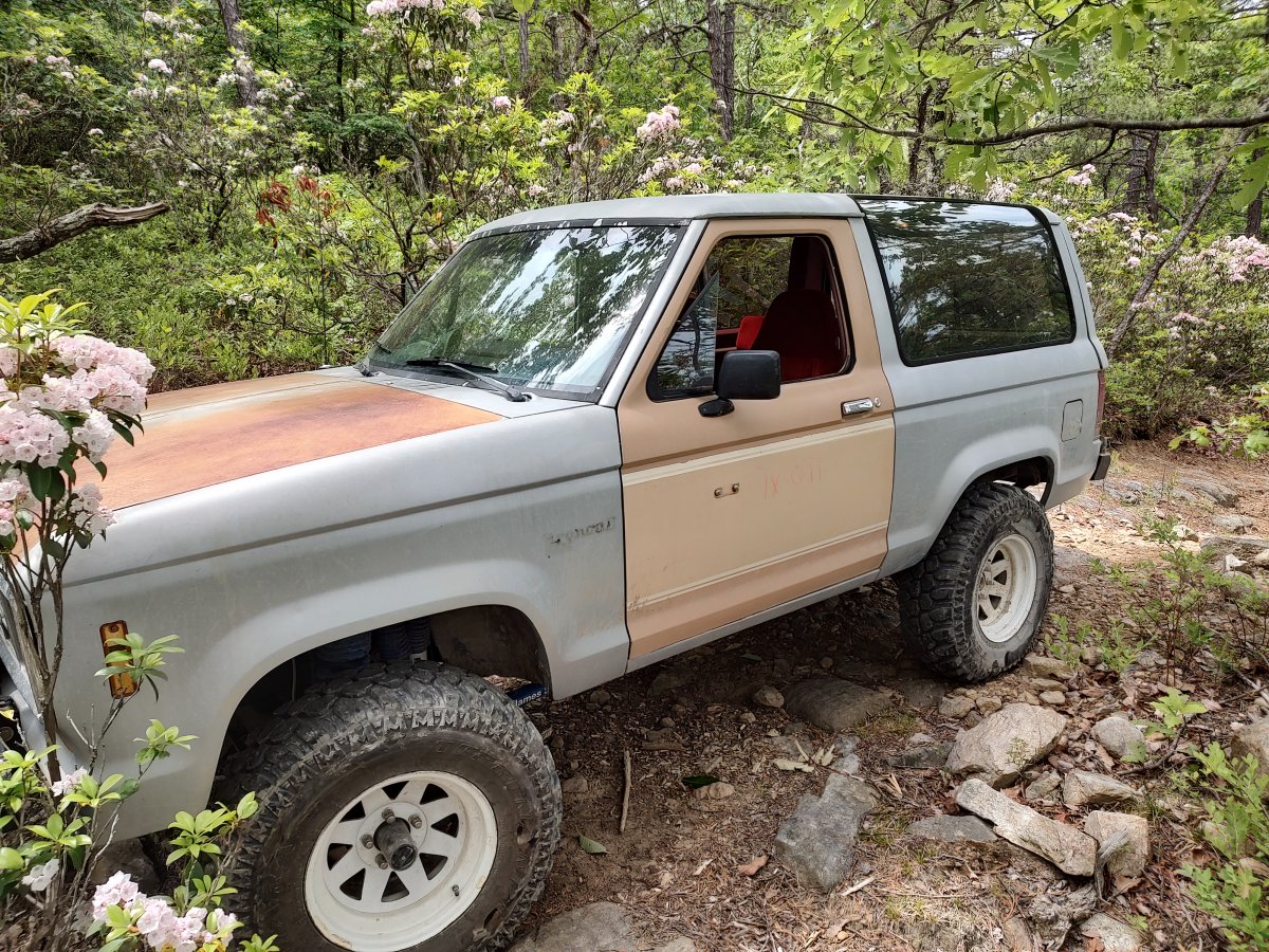

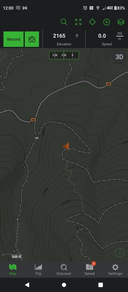

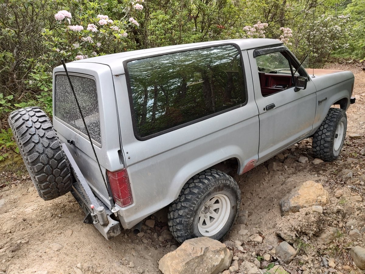

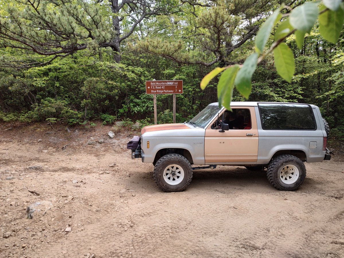

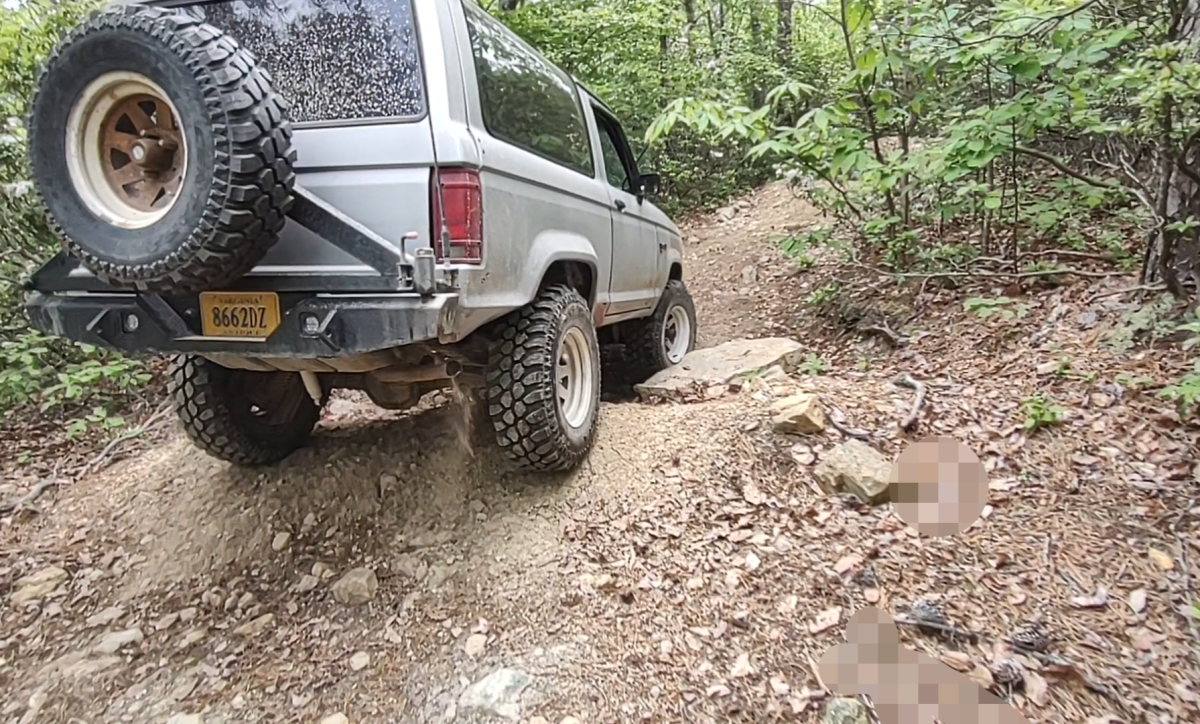

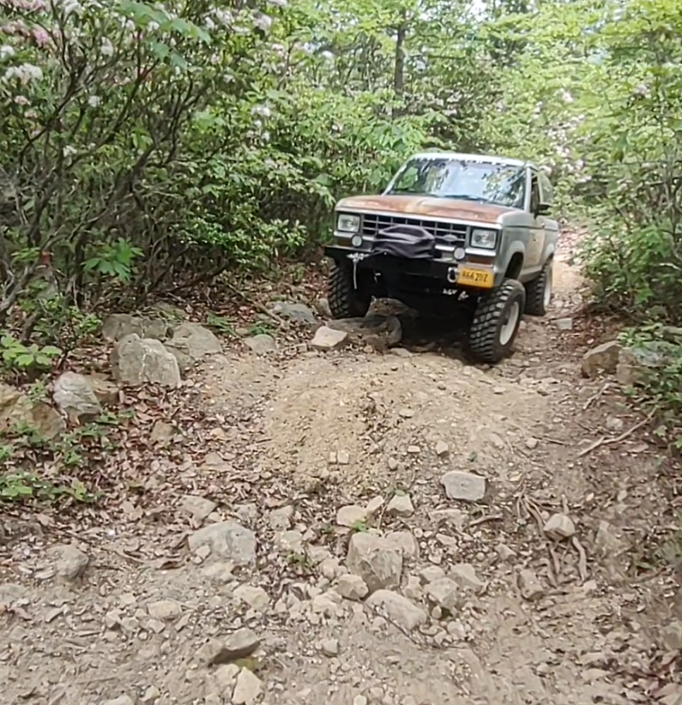

Well after over 2 years I finally got to do what I set out this little trucks life for. Last minute before a 2 day rain storm packed up late last night and headed to the mountains this morning. Couldn't find single rider, until my coworker who let me park at his house couldn't pass up the ride. This is Big Levels jeep trail in Waynesboro. I would say the main trail system is totally moderate, passed a JK on 31's a stock jeep truck (new one) and a new Tacoma, oh and some super motivated bicyclists! But with peer pressure I opted for the short cut trails that were at least moderate in difficulty. I was VERY pleased how it did. Ran up a few minor issues but I'm happy, it made its own way back to the trailer!! :ROFLMAO: I'll try and load some videos not sure how they'll work! Ohh only minor cosmetic damage to the exhaust and right quarter that I straightened by hand.
Note: We came in from the north so this is the end for us, and turn around.
Body damage seen above 😁 bumper saved a LOT!
