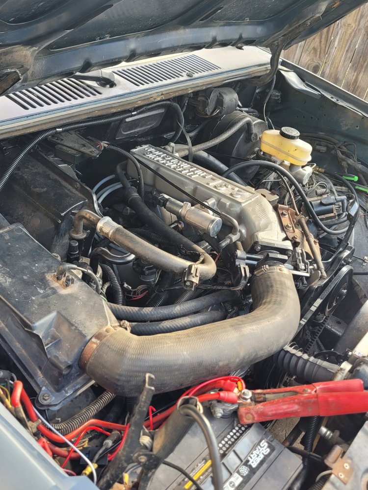

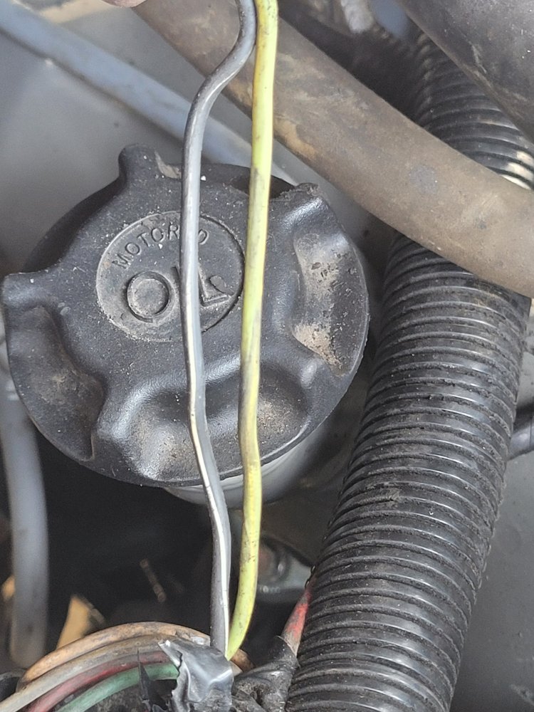

Pictured is a 2 wire connector, the wire colors look to be a black with white stripe, and what appears to be a green-ish with maybe a yellowish wire. Any idea what I missed, and where this may connect? With the pictures, I take a close up of the wires, then the connector, and I back out to show location
If you look at the pictures. The connector goes on the same side behind the hoses into the top of the manifold. You can see the black end of the connector in the pictures.
