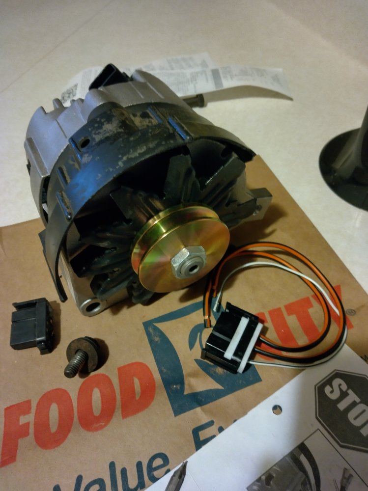

My 87 ranger 2.9 4x4 alternator went out. It had been replaced once before by me PN 7725-2. Took the alternator to Autozone where i had got it years ago. Seems that all the alternators have been modified ,changed or deleted. One remains in place for all (AZ DL7725-2). After cutting the pig off and soldering in the two black wires i noticed i have no place to connect the white wire that comes off the new alternator(DL7725-2). Is this something that is in the archives? I haven't had any luck so far. Any help is appreciated. Dirty

Same Alternator? I hooked the first one up and nothing. Of course the white wire coming out of the Alternator was left not connected. No sure where to connect it to.(Being the one on the bottom diagram on TT-545). If this can be accomplished where do i place the white wire? Picking up the replacement that has a connector not a pigtail today. Ill post results. Think ill start with a different parts store next time, Thanks RonD Dirty

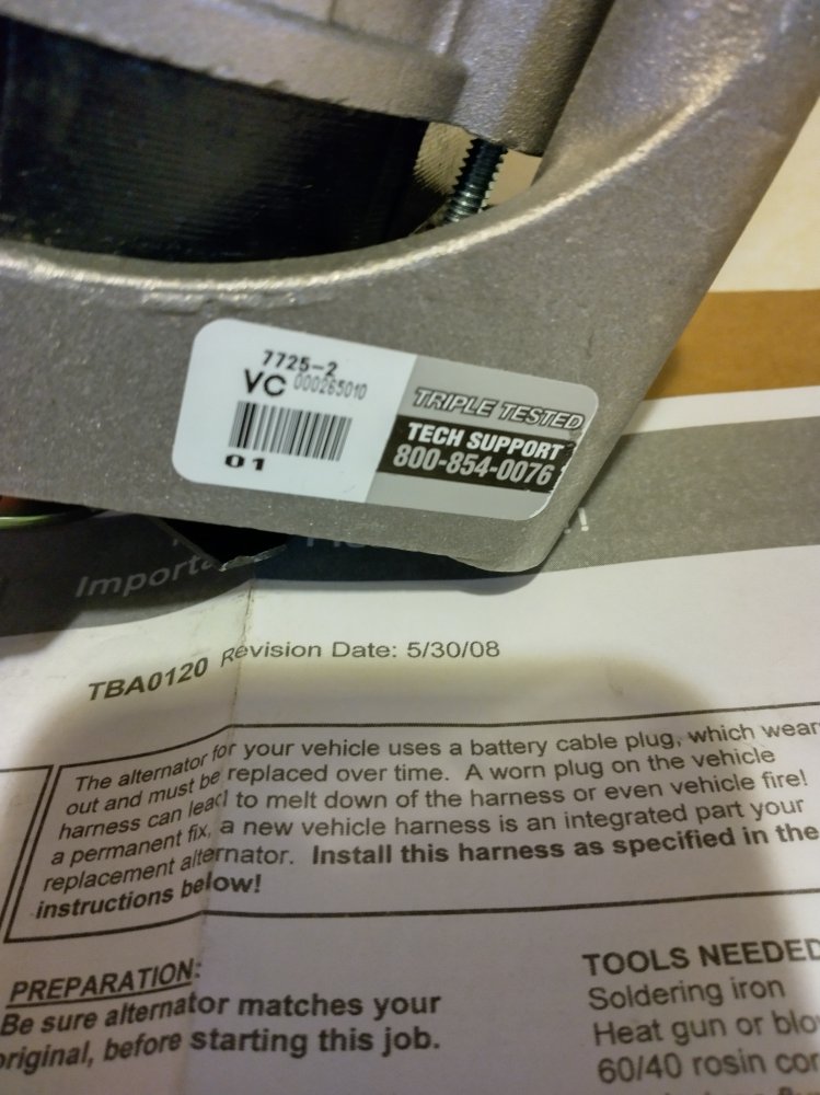

Picked up the reman autozone (7725-2) alternator with no indicator lamp. No DL in front of the part number. Seems these are harder to find and the others with a pigtail (DL7725-2) are given in place. Confused on how others have have accomplished the wiring task to get them to charge. Autozone cant even test them(DL7725-2).

Thanks RonD for your quick response and the TT 545. Think the man behind the counter was a bit confused. Had to solder in a new connector. (duralast pn 232) with 3 leads, 2 black with brown strip, 1 white with black strip. The white with black was capped off. It had 7.4vdc. Charges at idle, 13-14.
