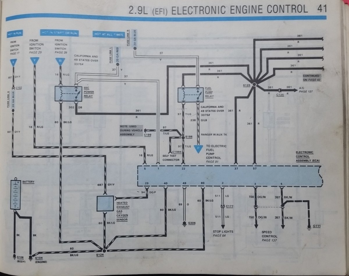

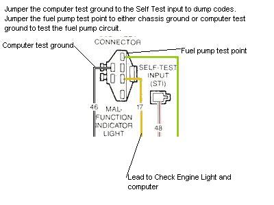

I'd try the fuel pump relay bypass to see if you can get the fuel pump running. If that works, I would suspect the EEC power relay (which supplies power to the positive side of the fuel pump relay coil) or the ECM/computer, which controls the fuel pump relay. I've attached a couple pics that may help.
Thank you Paulos , you were right,it was the EEC power relay. We are all set and running again. I appreciate it , take care
You're welcome. I'm glad it was a relatively simple/inexpensive fix. ECM's aren't cheap.
