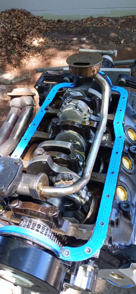

Picture is a great start but now give us some details (& more pics).
break it in slow them shred them D28s

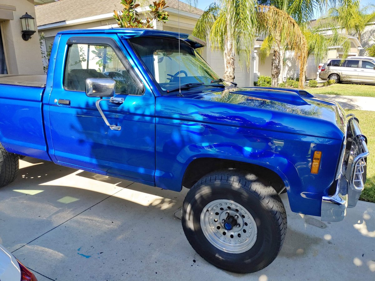

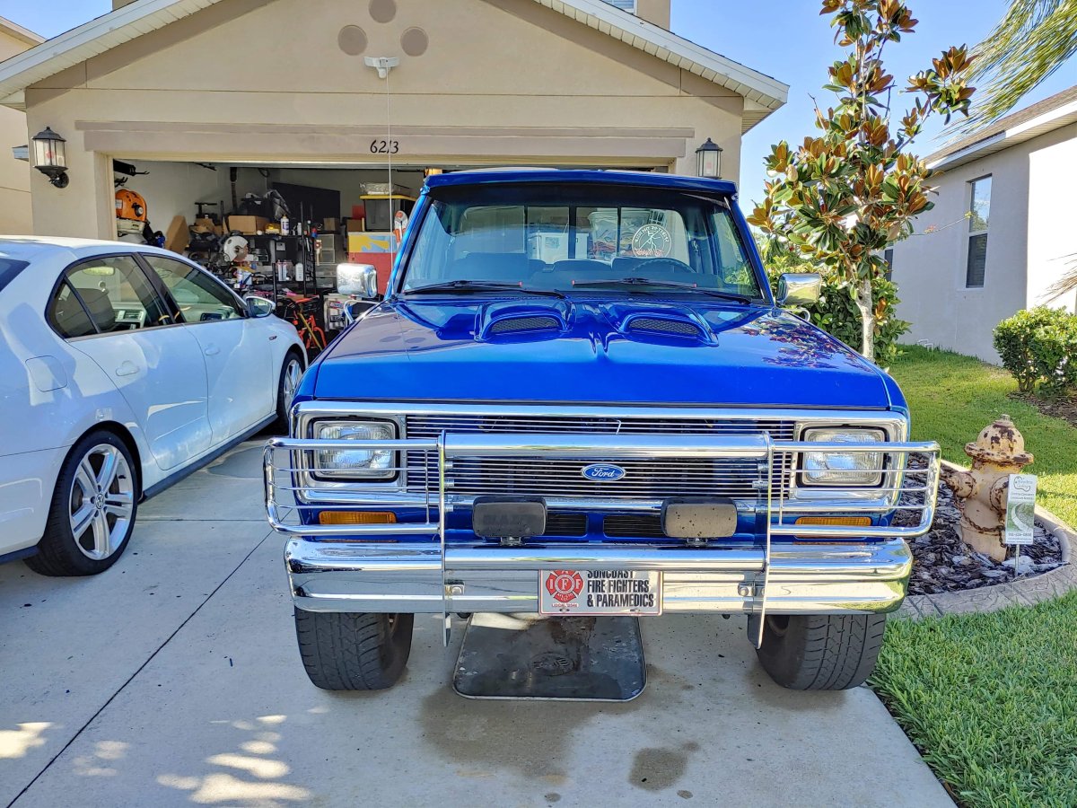

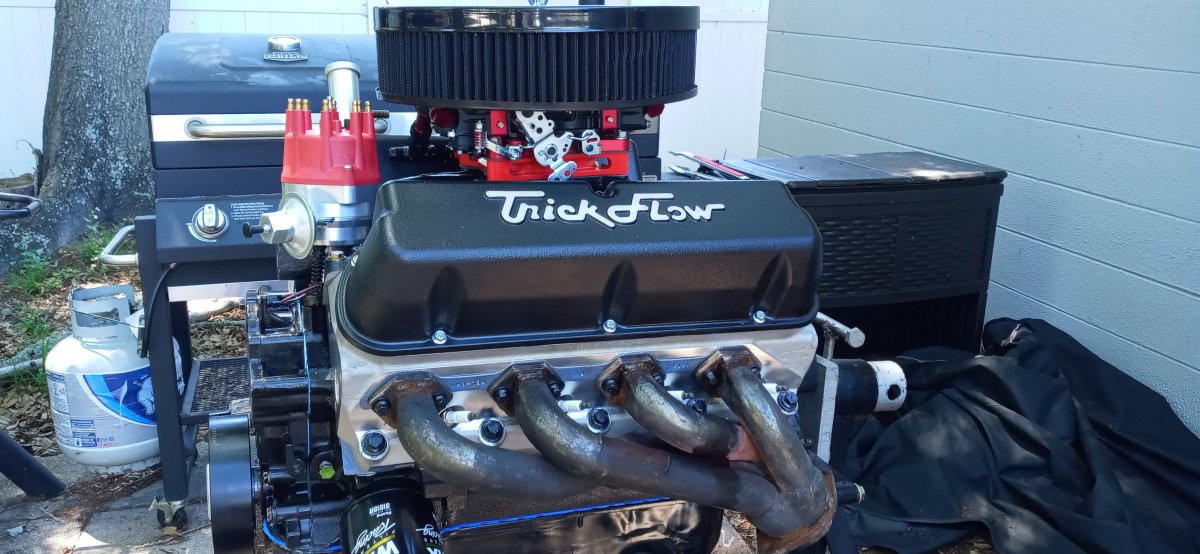

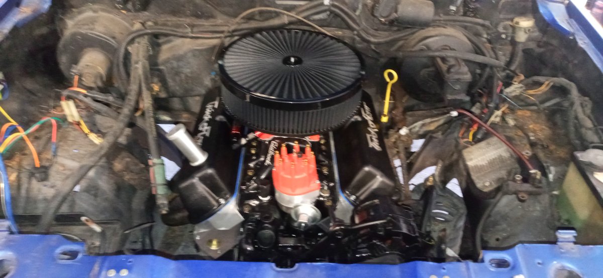

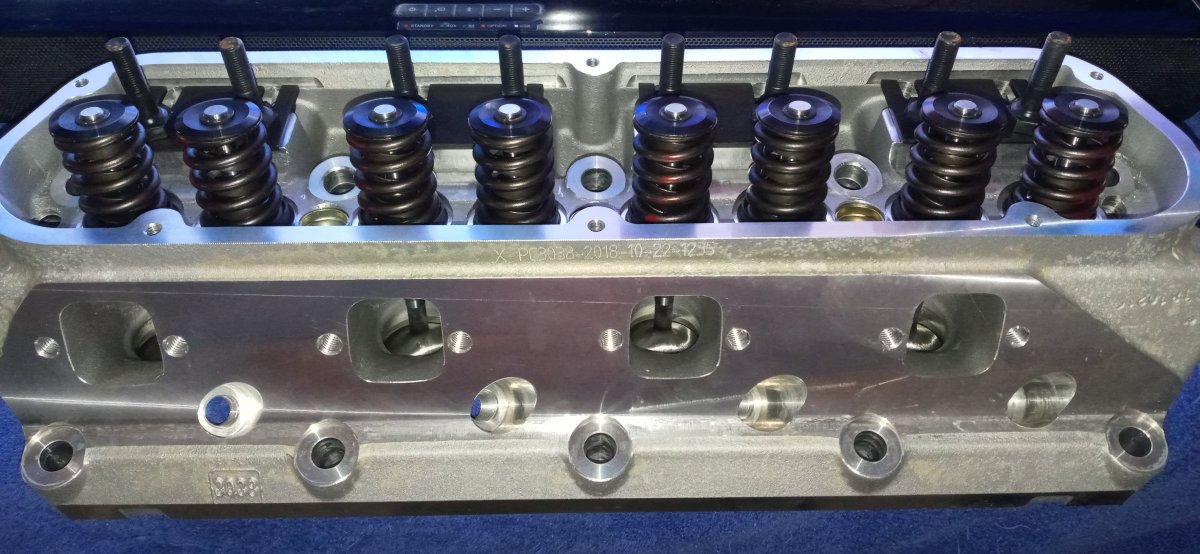

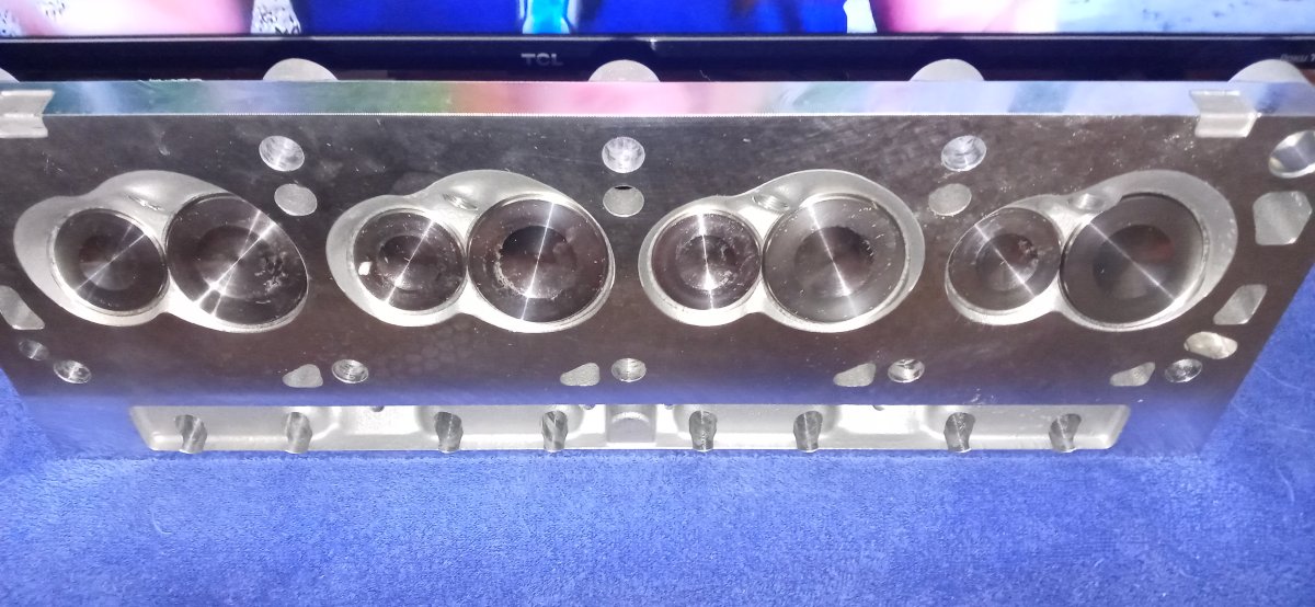

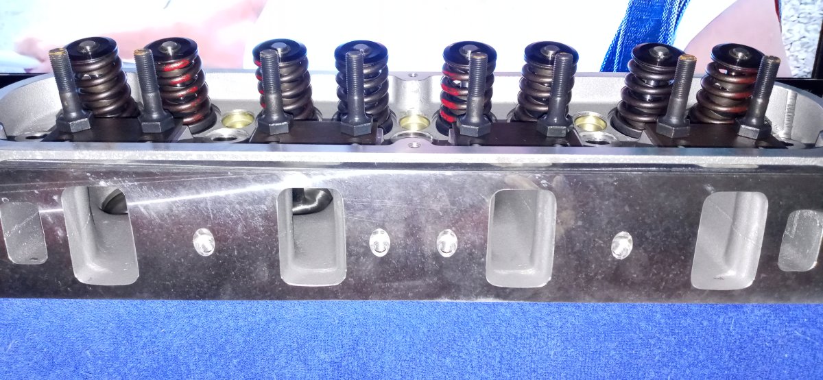

Paint & ghost flames are beautiful. Head work is awesome (GT 40?). What's the dyno say?
Nice truck! Welcome to TRS

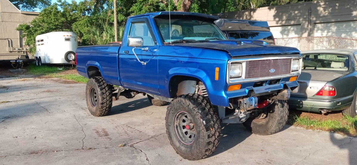

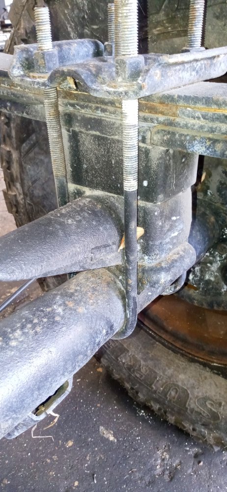

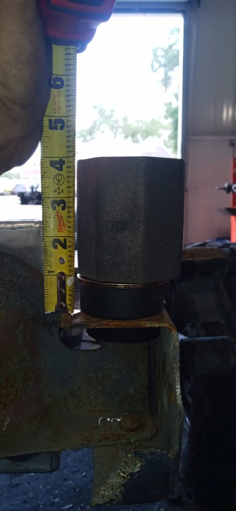

I'm seeing a TTB front axle assy, surely not a D28.
Looks good!
That said, I'm with the others, if that's still the Dana 28 front axle it isn't going to be happy, I would look into swapping to a Dana 35 with the mods that should be in the tech library...
I would also highly recommend a traction bar with near 6" of blocks in the back with stock leaf springs, my turbo 2.3 doesn't make near the torque of a 347 and I've bent leaf springs and twisted an axle housing... much nicer with a traction bar
