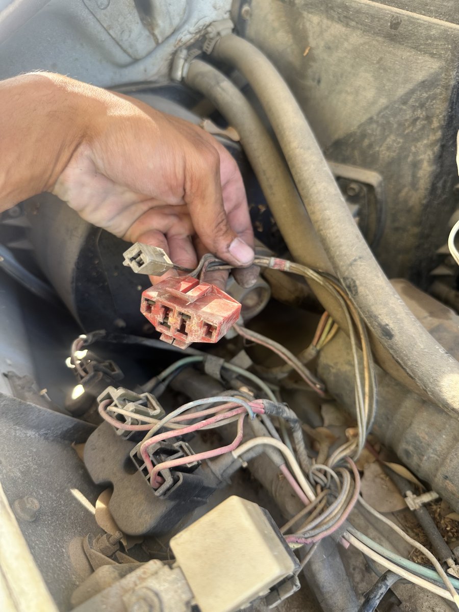

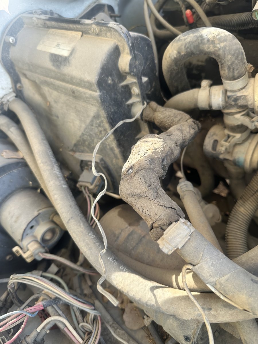

Any ideas what these are for? Cant figure out whats what the engine bay is awful, ill take my thread to 2.8 section as theres other harnesses unplugged, which isnt a big deal id just like to know whats what.
#1 No earthly idea. Looks like speaker wire or lamp cord, and I love how it's ran into the evaporator case. Hackery at its finest.
#2 OBD1 test connector.
