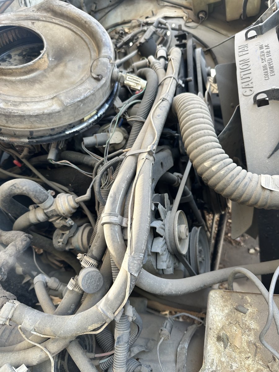

Anyone with v6 1st gen rangers have working AC?
1985 ford ranger v6 AC

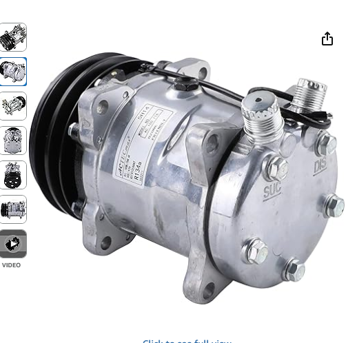

is this the correct compressor i need for r134a swap
I dont have original compressor, just everything else
Just buy a replacement compressor for your truck. What refrigerant it uses does not matter. They were designed for R12 but will work fine with 134a. Just be mindful what oil comes with the compressor and what oil you are going to use. You have two choices; PAG or Ester oil.

Thanks for the info, yeah im seeing lots of different style compressors with different mounting points, and pulleys, the one i posted , fairly certain that would work. If i remember correctly someone mentioned replacing condenser to a newer one as its more “efficient”? Maybe im over my head, ill do the compressor and go from there. How do i also make sure clutch isnt constantly engaged? Are they built internally to kick on and off as needed? I heard theres a adjustment screw

Problem is finding a original one isnt easy, so im just gonna go with one from amazon , looks like it should fit and has the proper connection for my fittings.
That's all that matters.

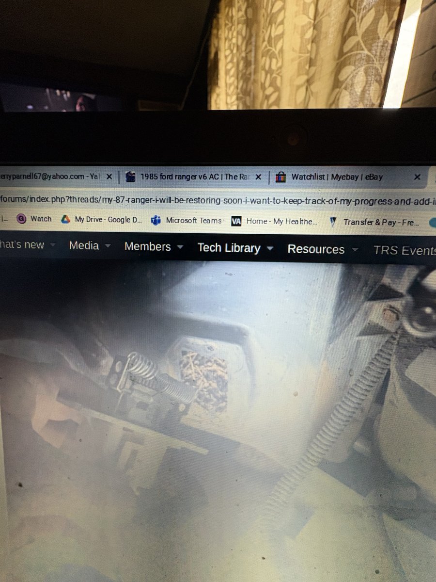

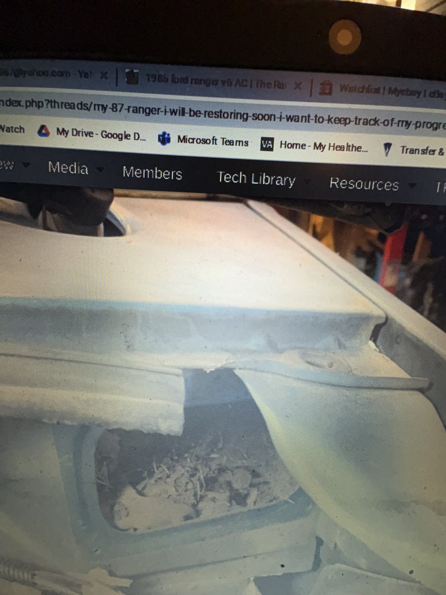

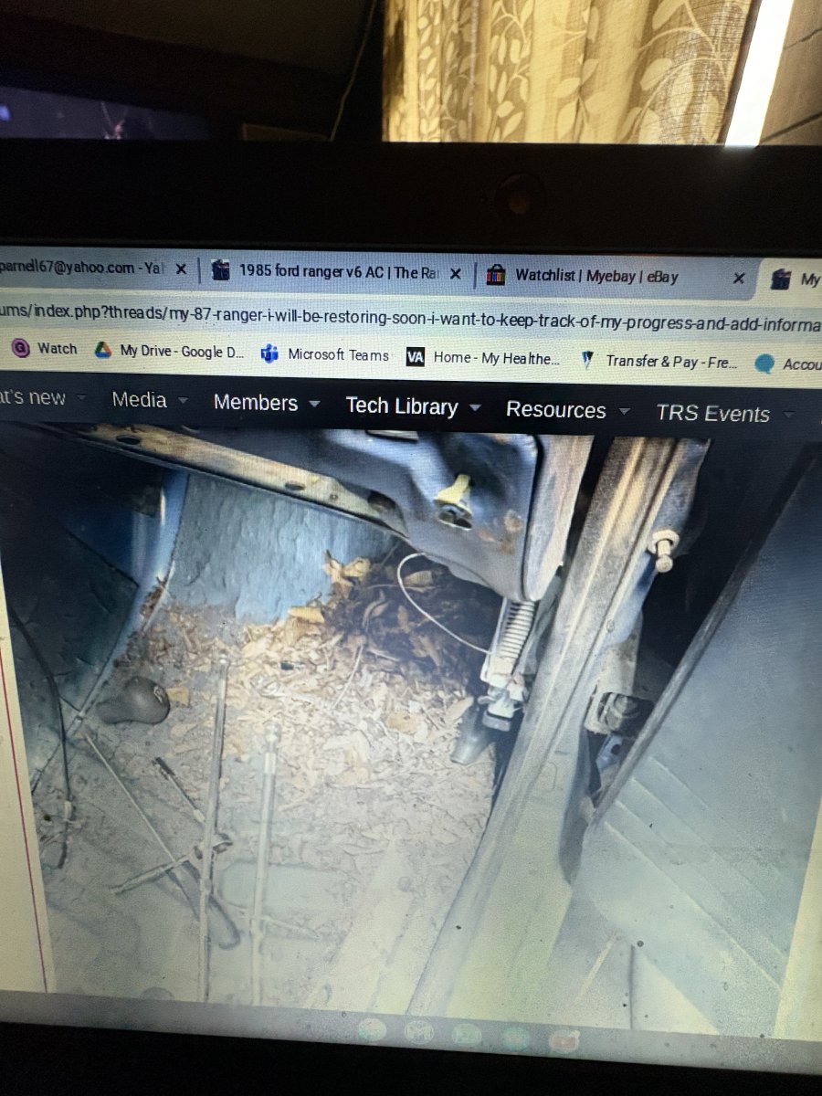

Here is just some of the stuff you can find in your Evaporator, I really dont know how to post pics from threads. This is on my thread. Your new replacement compressor will not come with the hose connectors. You will need to move them from your old compressor.
I dont know how to copy my pictures from my thread, but remove your blower resistor and see if there is debris in there. To access the evaporator, you remove the cover which is easiest by pulling your inner fender. You can recharge your ac by guessing, but I sent mine to a shop so they could install the correct amount of oils and the correct weight of coolant. They will do a leak check, vacuum check and then fill correctly.

You are totally correct on debris on the evaporator EXTERNALLY. What you will also find is a mud like substance since the evaporator sweats when it runs, and then all that dirt sticks to it and turns to a mud and blocks the airflow.
In my post about the evaporator and the orifice valve with the screen, I thought you were commenting on INTERNAL clogs and debris. My comment on the condensor getting clogged easily would be on the inside of the condensor.

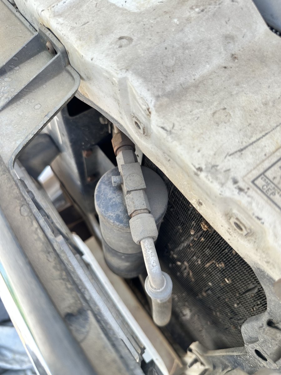

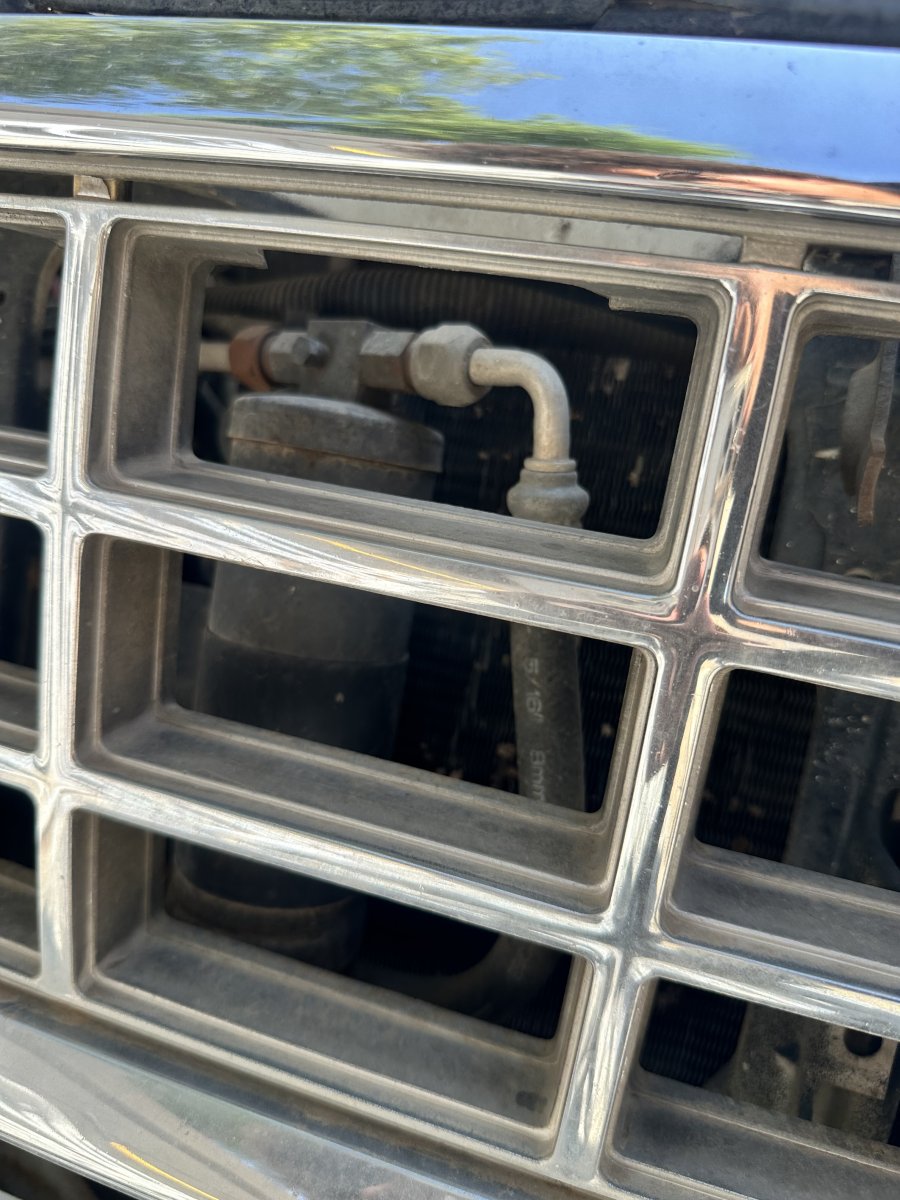

I did not know the dryer was located behind the grill in 85. 87 and 88 they at the firewall. Behind the grill would be easier to access,.
