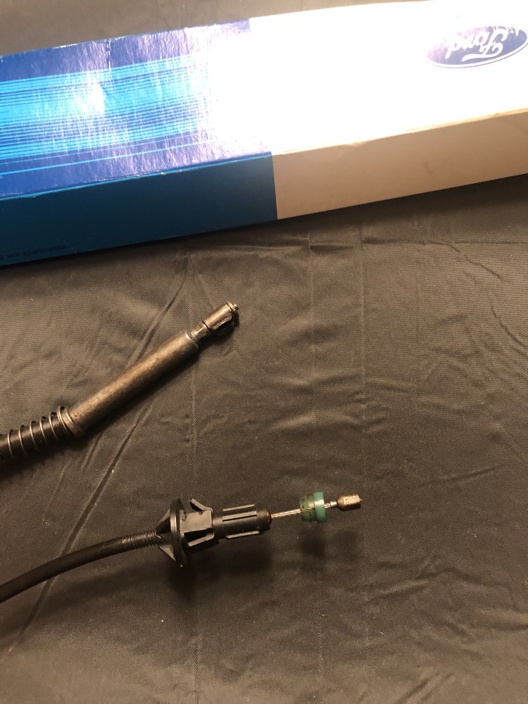

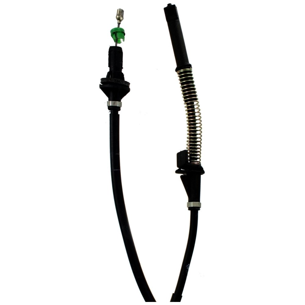

Judging by your picture, I'm going to have to do some more investigating on my truck. My cable looks a bit different than that one.
GB :)
My cable is an odd one indeed. It's like one foot long. All factory crimps and parts from what I can tell. All of the parts stores can only get ones for the 2.0 or 2.3 trucks, and they're like 30+ inches long. I had Oreillys go ahead and order one to see if I can make it work.

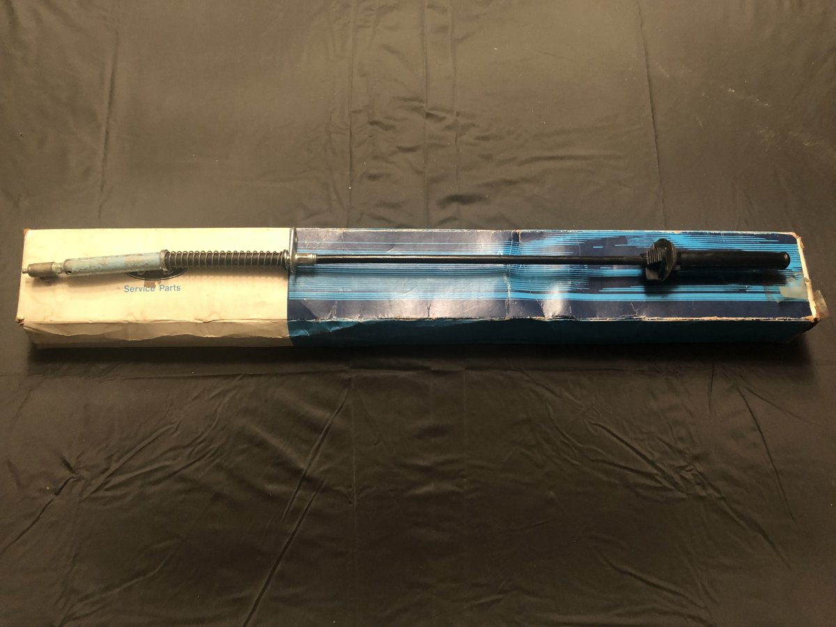

I'm supposed to pick up the (35-1/2 Inch) very long 2.0/2.3 cable (vs my 1ft cable) tomorrow after work, so we'll see what happens. I think I can put a large loop in it and run er. I'll try to inject plenty of grease to counteract the friction from the loop.
If nothing else research what people use on carb V8 swaps. The 2.8 one works great on my 302 but I know most guys that don't have a 2.8 are not tracking down 2.8 cables.
