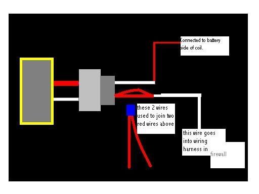

I figure the ignition switch is faulty but instead of taking it apart I managed to change some wires. The 2 pin plug that goes to the module...(1) coming from the module I attached the white wire to the white wire on the other plug, (2), I attached the red wire coming from the module to the battery side of the coil, (3) The 2 red wires that split out of the back of the plug I cut right off the plug and kept them joined together. Seems to start excellent and keep running. I even noticed the white wire from the module does not even seem to need to be connected to anything to make everything work but I attached to the other white wire instead.
