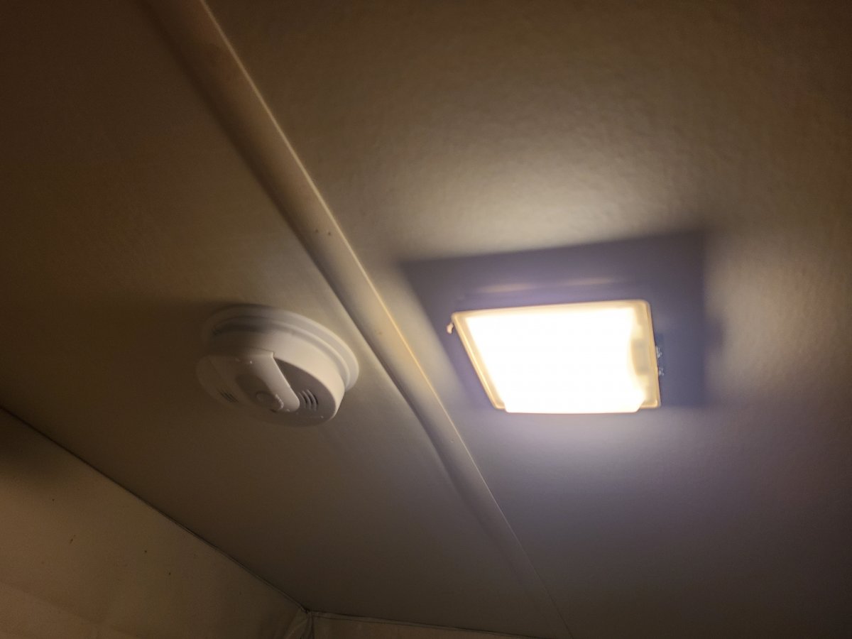

Hard to add the holes but if something goes south in the middle of night I just as soon know about it. Combo smoke/carbon monoxide alarm.

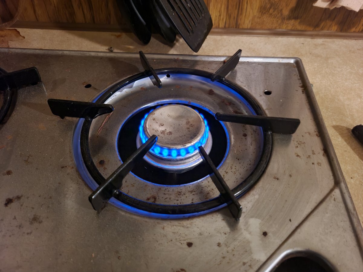

Acts like I am just not getting enough gas, I can get one burner to barely light. It goes out if I try to light a second.

The one in the first picture of my last post was a $39.89 smoke/carbon monoxide combo. :icon_twisted:

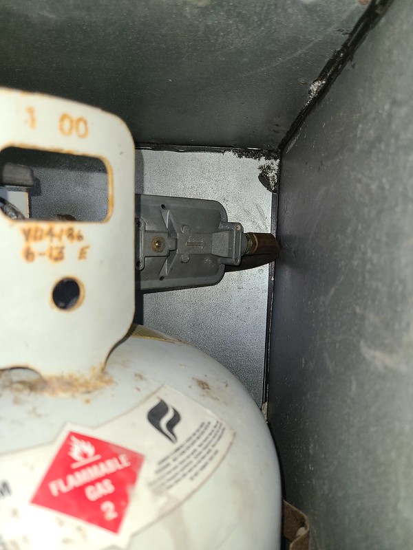

I have been trying to wrap my head around the propane hose routing, with the big two stage regulator it has to go out so darn far it hits the side and put a hard kink in the hose.
So I pulled it out and stuck the tank on a stand so maybe I could get a little more fire air flowage.
Lit a burner, it took off with a vengeance.
Well lets see how many can eat...
Before one burner would barely run and would fade out if I turned on another burner (which wouldn't really light)

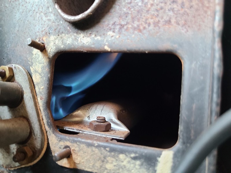

Tried the heater again, I think the pilot light looks better but it still won't do anything.

Going to try to find a hose tomorrow, I don't have super high hopes as all I have is regular home heating/AC places to pick on, nearest camper place is over an hour away. I tried to snag a BBQ grill hose tonight and everything about it is way smaller.
Get yourself a 1/4" NPT street 90 fitting for the outlet of the regulator so the hose doesn't have to go straight out of the regulator, you could put the 90 at the inlet of the regulator too, might make things nicer... In plumbing lingo "street" means male to female so you only need one fitting... You'd be safe with brass or galvanized, the working pressure of propane is like 350psi max which is in the realm of everything but nylon fittings...
A 45 degree fitting may be a good choice also.
I need to find a hose first, this one has seen a better day... and that was a few days ago. Doesn't leak though.
For some reason it was routed up through the band that secures the tank too so it also got smashed flat in there.
