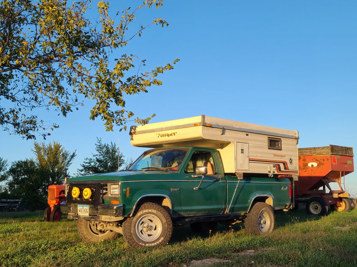

1984 Skamper 072S
Hopefully there is enough reinforcement material around the opening that you don’t have to start from scratch.
The foam is the reinforcement. Some kind of structural foam.
Well it's on...
Tried the spare tire carrier... it laughed.
Tried the heater, pilot light and the fan run but the thing won't take off. I suppose it needs a thermocouple. Oh well, probably won't need it this weekend anyway.

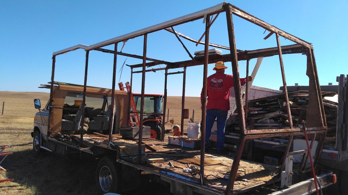

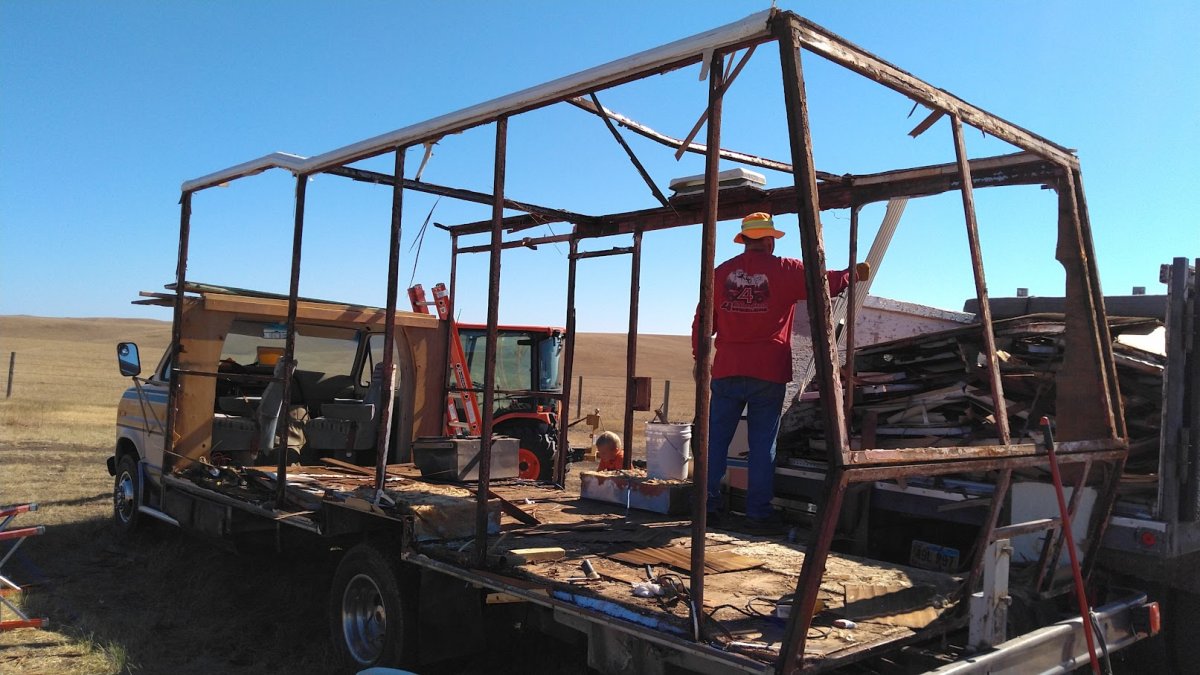

Semi related, (the "structural foam" comment) have you ever wondered what the walls of your camper look like with the covering stripped away? Well...they look like this.
1x2 square tube, very thin wall, C channel roof braces (missing a bunch that rusted off as we were taking it apart.) The spaces between the "studs" were filled with styrofoam, then the whole thing was covered with 1/4" plywood on the outside and paneling on the inside, and fiberglass siding glued to the outside over the plywood. I really understand now why I always heard that these were like driving a cooler down the highway!
