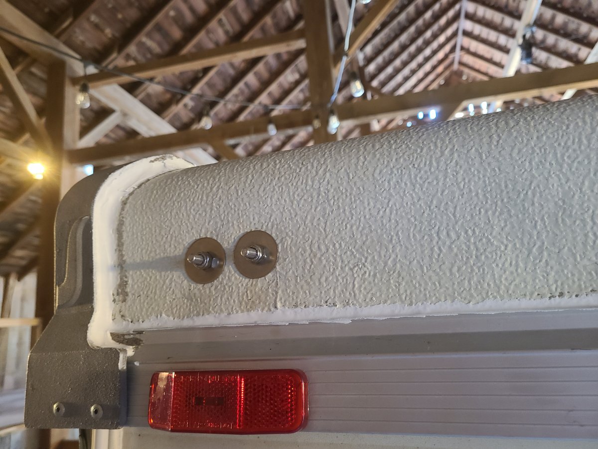

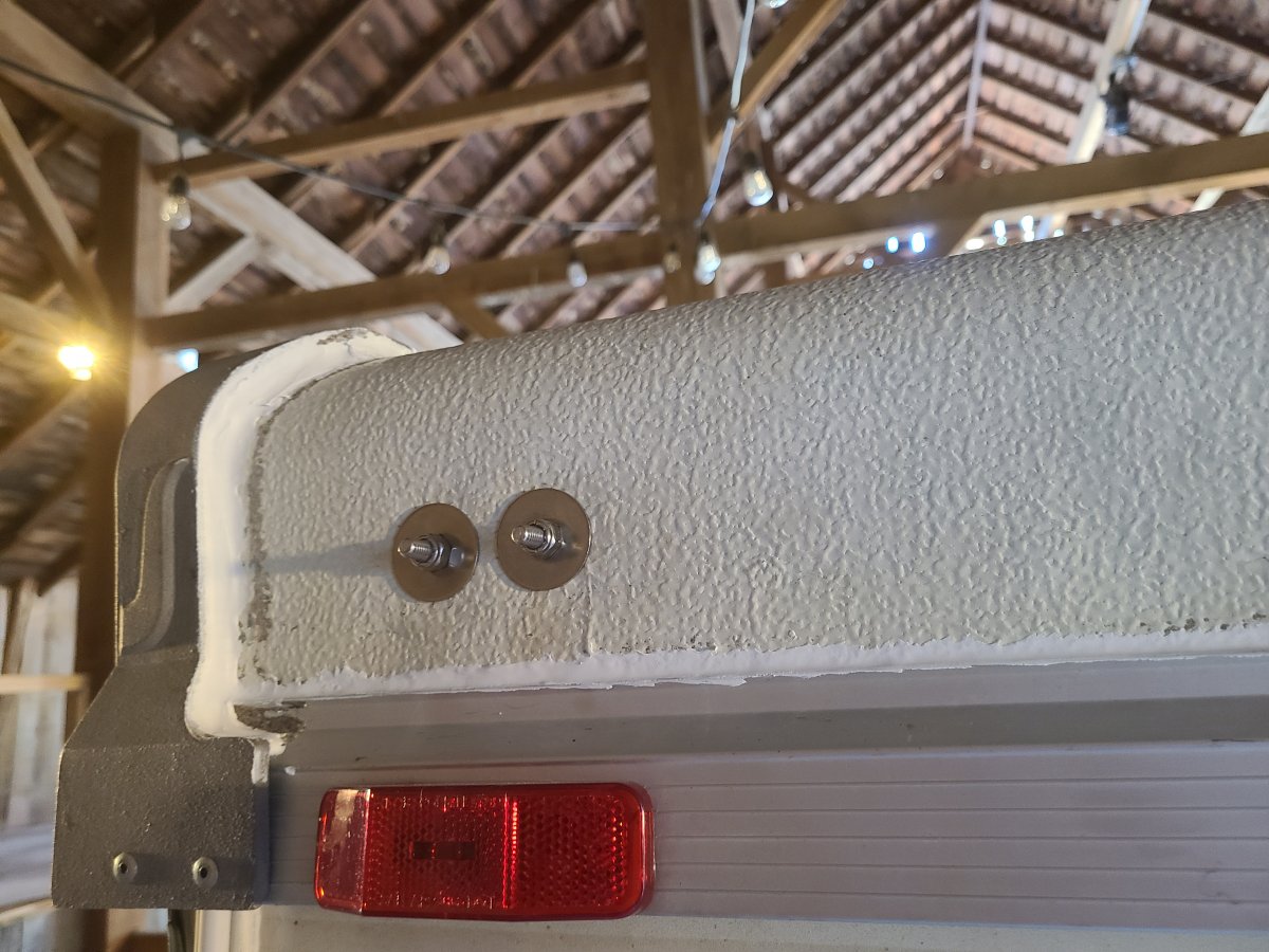

Updates!
Roof is caulked!

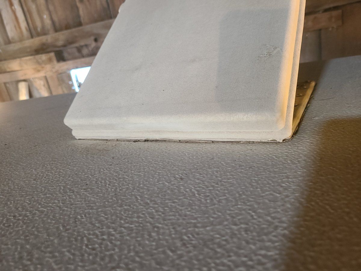

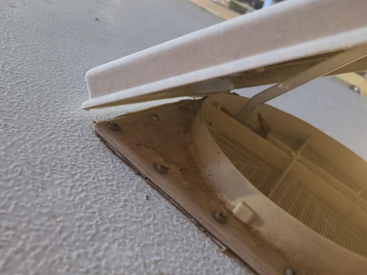

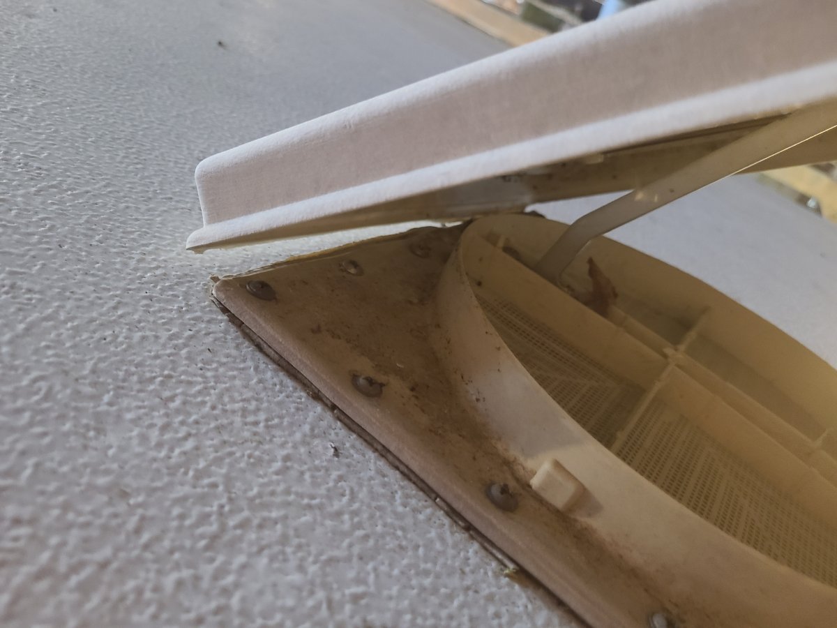

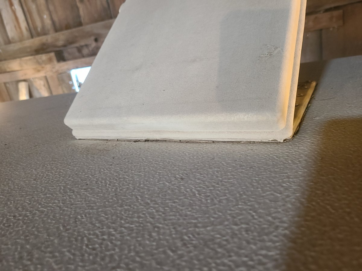

I was thinking about trying one of those vents with the low draw led fans built in as a crutch for not having A/C anyway. Blowing the hot air out the roof is supposed to make a big difference for helping with circulation. Power is literally an inch from the vent via the "kitchen" light.
Still hoping to take it out this year, it's only like 4 miles to my favorite Campground.

Updates!
Roof is caulked!
Not to worry, not done yet!
I will say the roof fan is probably the best money I spent as far as comfort when I rebuilt our popup. No AC in that thing and honestly we have never really needed it. We aren't in the camper much during the day when it's hot, and it cools off very quickly with the fan at night. I don't remember what the brand was, but it had a cheesy name, like something you'd expect Billy Mays to be pitching on late-night TV. Our is just a basic one with a few speeds controlled manually, but they have more complex controls, like sensors that will shut the vent if it senses rain. An unintended but kind of nice benefit is it collects the bugs that get inside the camper. They end up there and land on the screen, then can't take off again due to the airflow. We have a little cordless vacuum that we suck up the bugs with.
The neat thing about the fan is my vent is a weird size (yeah, didn't see that coming either) so for a modern fan/vent I have to enlarge the hole.
Of course, why wouldn't it be. Mine probably was too, but since I was redoing the roof it didn't matter for me. If you can do it, I still think it's definitely worth doing even if it requires some surgery. However, I know what a can of worms these campers can be.
Hopefully there is enough reinforcement material around the opening that you don’t have to start from scratch.
