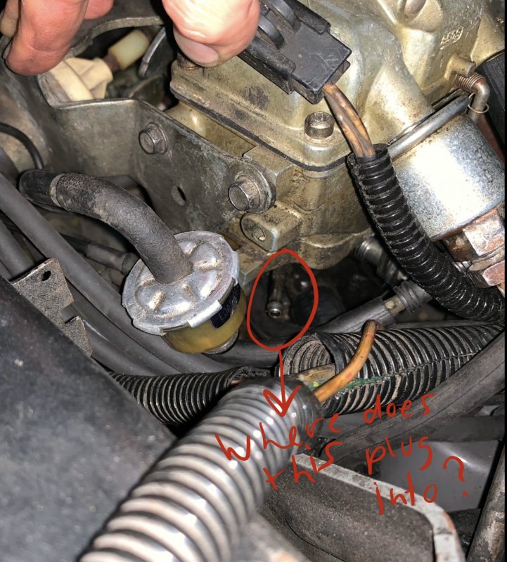

First, this nipple on the carb is connected to nothing, it’s the 3rd one counter clock wise if you start on the left side of carb. On diagram, I think it’s supposed to be a yellow line going all the way to the vacuum reservoir..
30355

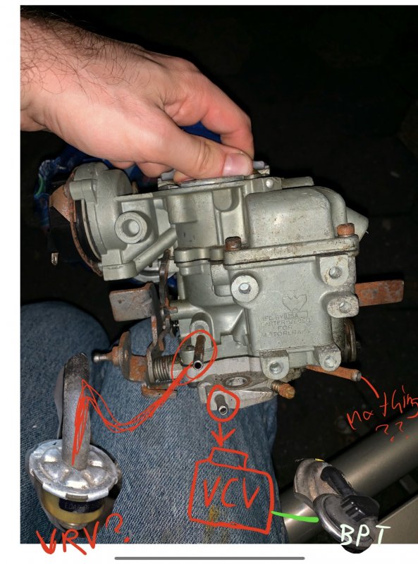

And here’s a better view of what’s connected to what (left side of carb), used spare carb for clarity
30354

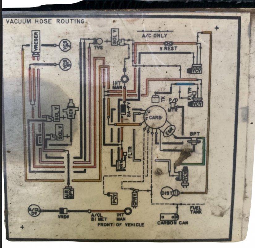

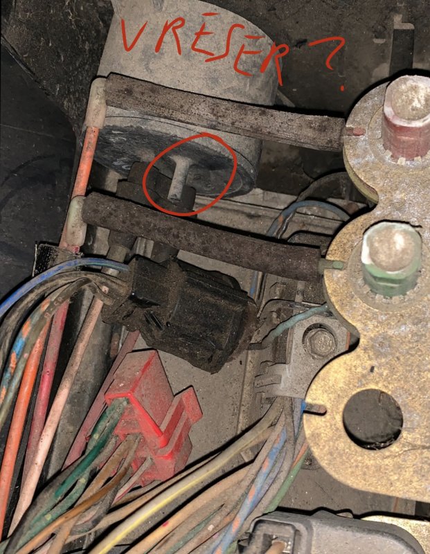

Looking at the vacuum diagram under the hood, it seems like that’s the yellow line that goes to VRESER, but there’s nothing, and what I think I identified as the VRESER doesn’t have a yellow connection:
30356
30357

That is definitely a manifold vacuum source. vresver… Vacuum reservoir... run a vacuum line from the port on the carb to the reservoir... or put a vacuum cap on the port of the carb.
Not sure it will start after that... but it probably run really bad with the vacuum leak.
