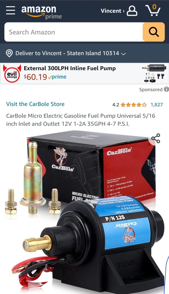

I put an electric fuel pump in my 1985 Boat engine. It's a Chevy 3.0L with a carb. It works great. My mechanical pump shit the bed so I tried this one shown

CarBole Micro Electric Gasoline Fuel Pump Universal 5/16 inch Inlet and Outlet 12V 1-2A 35GPH 4-7 P.S.I. https://www.amazon.com/dp/B01B7DCQA0?tag=959media-20
35GPH(gallons per hour) can support up to 300HP Carb engine
Carb float bowl valves are OK up to 10psi
That pump I posted would do it. I'd probably go electric too in this posters case. No brainer for $22.
