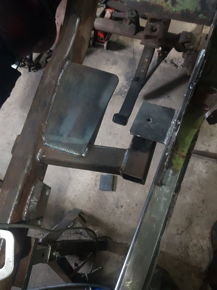

Next i decided to remake the factory body mount out of some tubing and double as a reinforcement for the front suspension rear mount. I just xopyed the factory style mount but made it out is square tube for simplicity again.
37780
37781
il
It's made plenty heavy but using scrap metal you take what you can get.
