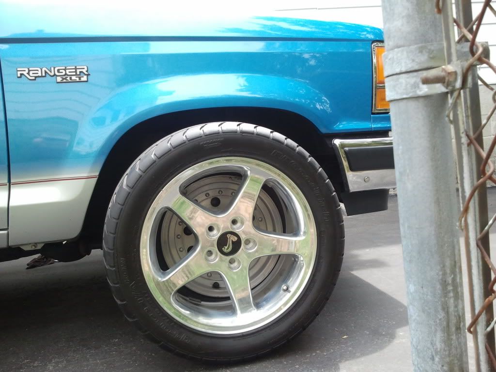

Hey Mark, mine fit:

I had to machine down the last 3/8" or so of the hub to fit them... no the center cap wont fit, I reshaped the dust cap so it was squared off and flat, then painted it black.
