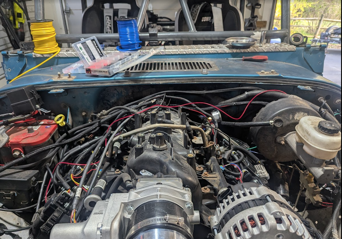

Was starting to work on finishing the wiring and one thing that's been bugging me and I'm not sure what plan makes most sense.
I kept the chassis wiring harness in the jeep because it has the fuel pump relay and the starter relay, but I'm wondering now if I should bypass all of that and put in a new box just for those circuits and just not use the original wiring at all to run the jeep. I can thin it out then just to keep some of the lights if I want to, but I think that it would make everything cleaner and easier. Any downsides to doing it that way that I'm not thinking of?
Lean and clean is good. Makes troubleshooting and repairs much easier, especially in the field.
K.I.S.S.
K.I.S.S.
That was my thought as well, no digging around a loom, just two relays and two fuses and call it a day. engine management is all standalone, accessories like lights and radio are on a separate one as well. Converting to a push button ignition. Just my inexperience makes me nervous that I'm forgetting something critical.
You'll remember, eventually.

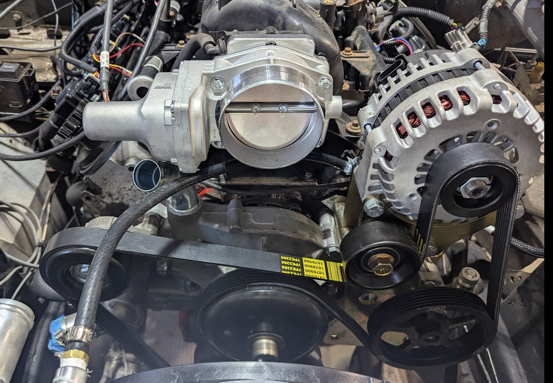

Is the passenger side idler pulley smooth?
If so that is strange to have the ribs running on it.
Yes, that's the stock one. The alternator and PS pump have been moved around on the driver side

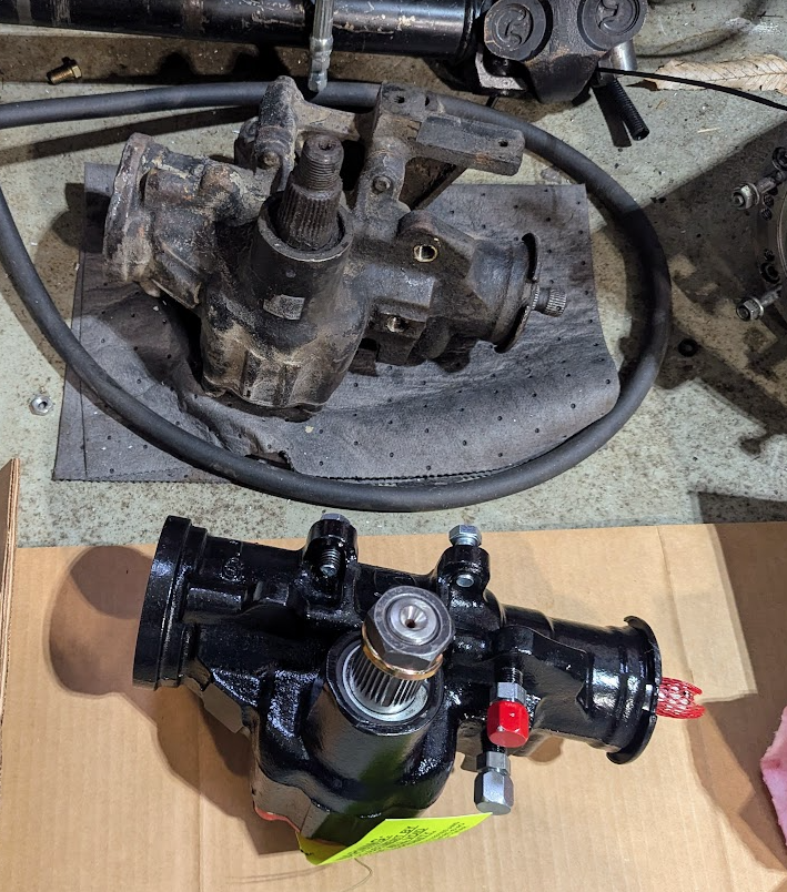

New steering box came in from Redhead steering gear, curious to see how well it works vs a PSC box. Price was MUCH better. This is their rock crawler mode with ports for hydro assistl, but they've got stock replacements as well

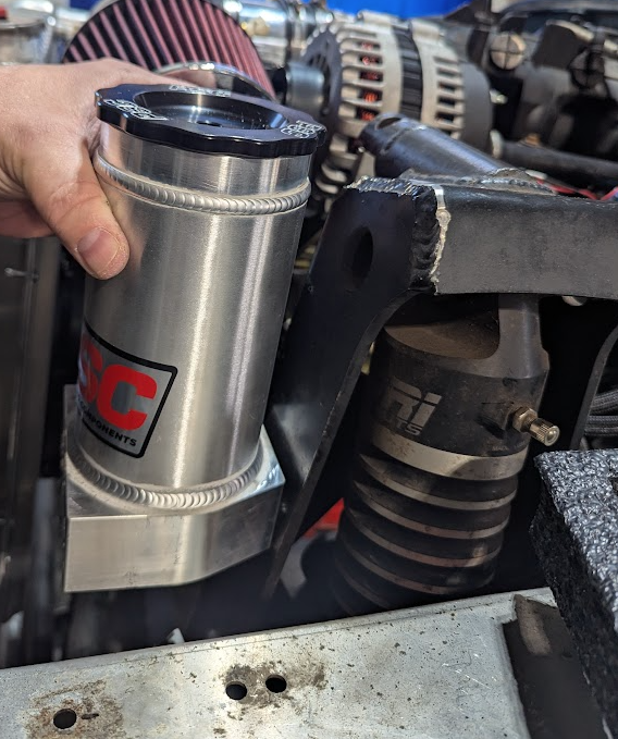

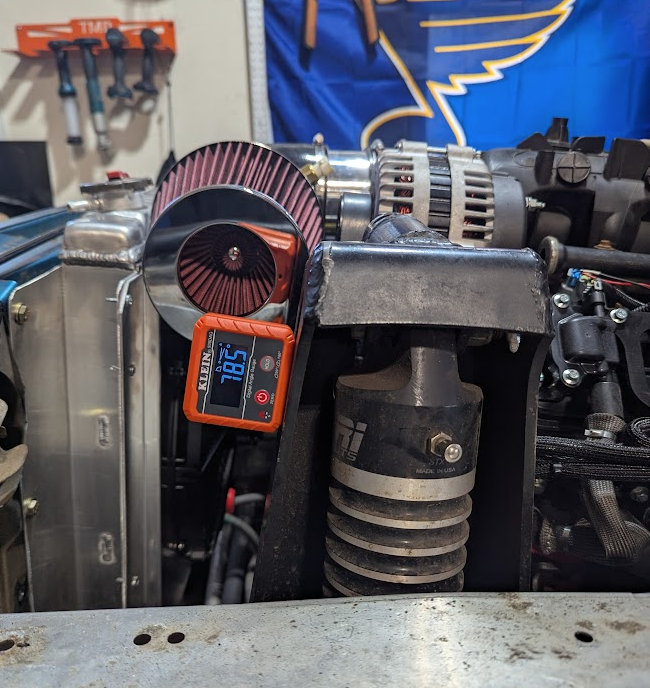

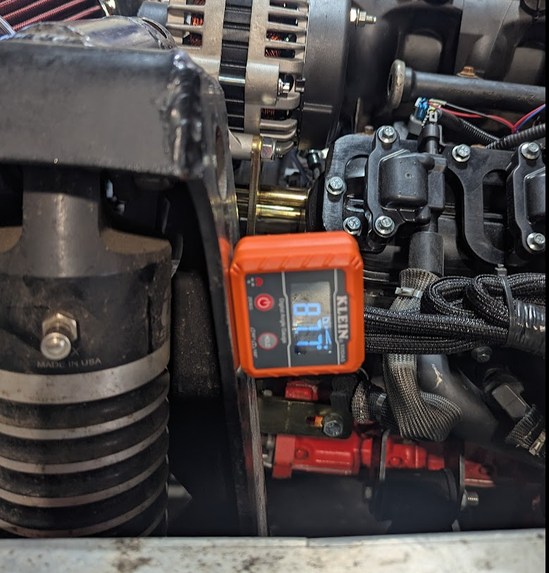

Going to mount my psc reservoir to the back of the strut tower, it's almost vertical. Just a little concerned about the lines between everything but I should have a decent amount of space

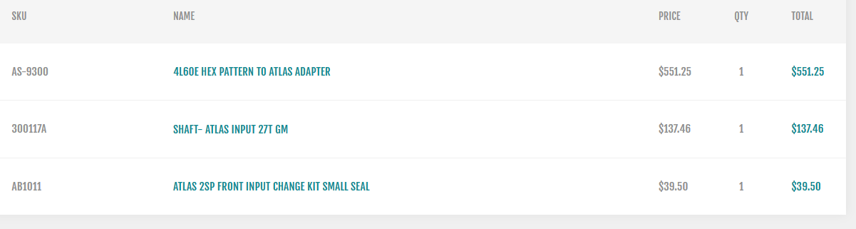

Got the new steering box in, need to find a local place to make me some new high pressure lines. Fit in really nicely though. My atlas stuff should be here today, but my shifter is delayed now for another two weeks.

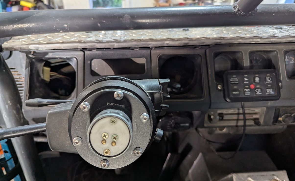

Started getting the wiring finished this weekend, all my sensor connections were in but the harness does have some basics like 12v power, a few grounds.

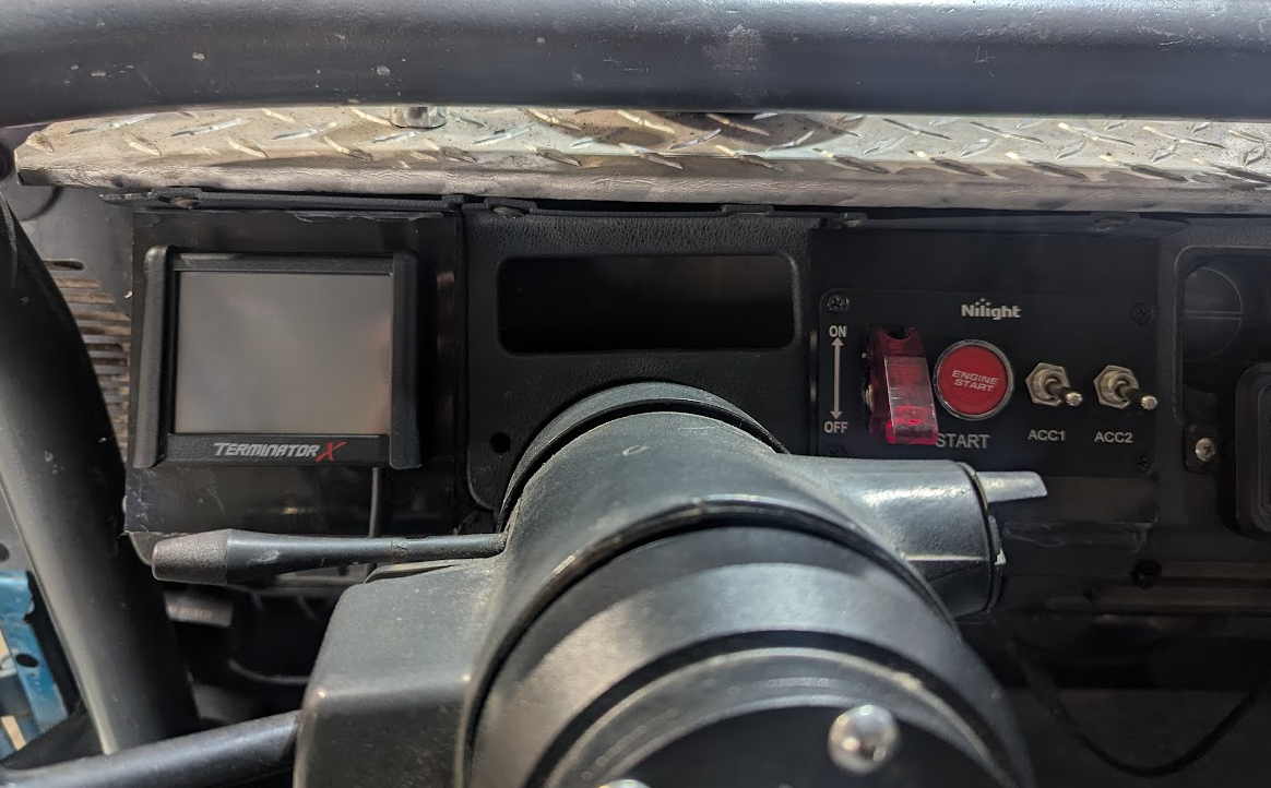

Decided to rip out the gauge cluster to make room for the handheld engine management thing and the ignition/fuel pump./efan relay controller
Ended up with this to control the motor and those couple of circuits that aren't controlled by it. Will have a push button start, separate switch for the fuel pump and the efan. The Holley harness will start/stop the fan with a ground trigger based on the engine temps, first time I've used a system like that and I'm slightly skeptical, but we'll see
