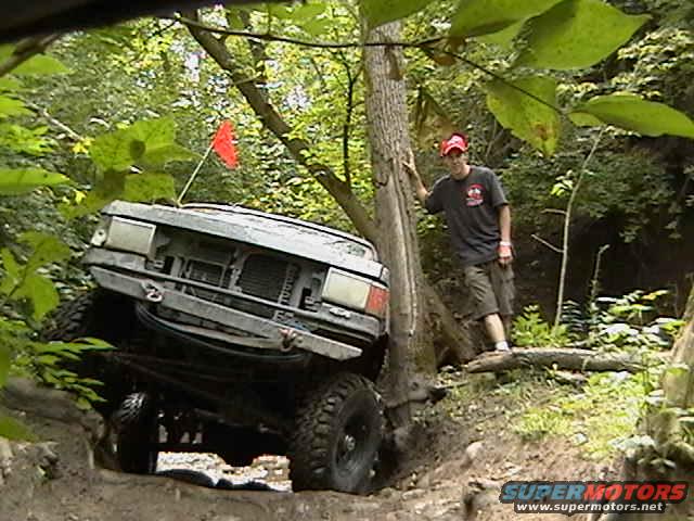

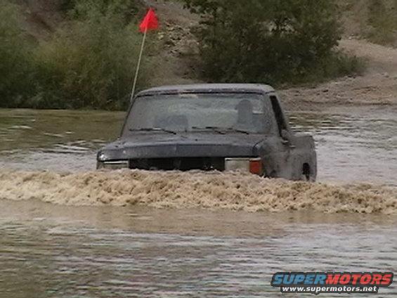

Truck history....first wheeler I built was a 88 bronco full size w/ a 302, started by cutting fenders, building bumpers, then got some 34" ltb's then after the TTB front started giving me shit I threw in a hp44 with some stock 79 f150 radius arms, springs, just the basics. Wheeled the shit out of that for a while until the body started to pretty much rust in half, and I destroyed the electronics with water.

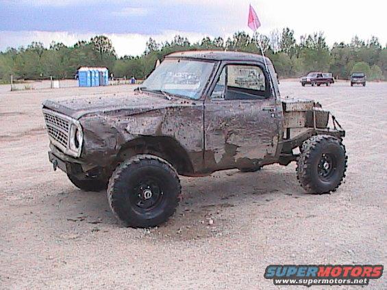

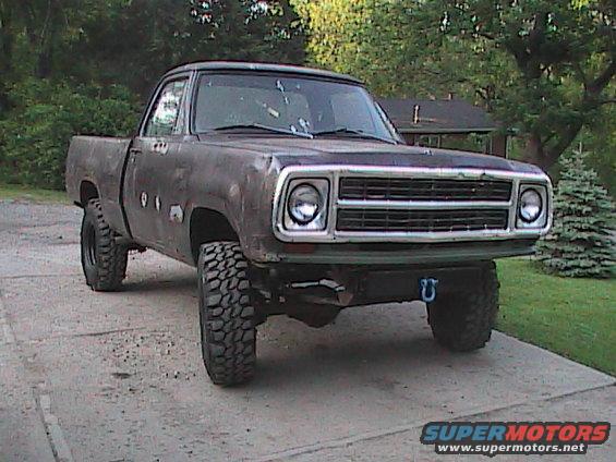

Then I acquired a 80 dodge short bed for free....drove it home, kinda scary drive, but oh well....Threw my 34's on it, cut the fenders, wheeled it, blew it up then decided to build it a little more, newer roller 318, removed bed, moved rear axle forward, bumpers off bronco, welded rear, and a little more. Wheeled it for a while then decided I did not like crawling with a carb.

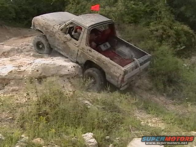

And my old mans truck that ive been tearing up since I was 16...
This truck is pretty much the whole reason i got into wheeling. When I was 16 my dad let me drive it when I wanted...it was alot nicer back then tho....Still love this truck....

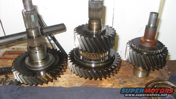

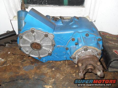

First thing was to rebuild 205 case. I got all new gaskets, and prolly should have gotten new bearings but this looked usable and this is still a budget build.
Toor it down, cleaned it, ground down the shift shafts so I could make it a twinstick...
It was a fun time tearing into it...
shift shaft
All back together.

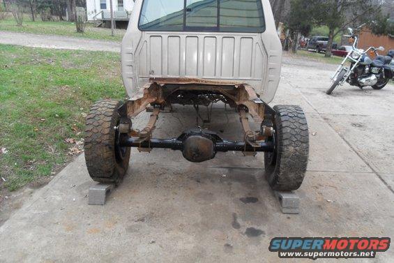

After that the rear axle, which got alot of the same treatment, shaved alot more off the rear, cut off all the old brackets, striped down and cleaned, painted....It will eventually get disc brakes also.
I had to throw the rear under if in a hurry because I sold the ranger rear and had to be able to move it around....

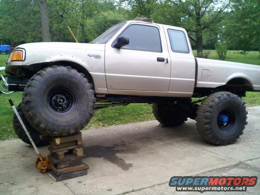

With the rear under it, stock wheelbase, springs and ranger junk....Oh yea and some dirt track front tires/wheels for now...haha
Heres one with just the 39.5s on the back before I took the bed off for the newer springs...
Then it was time to mount the rear for good and figure out my wheelbase, my front spring hangers were interfering with the rear body mount so I had to steal the hangers from my old dodge because they were shorter and stronger.
Made the rear spring hangers.

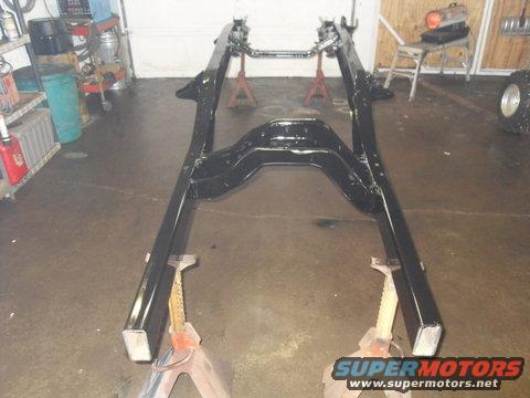

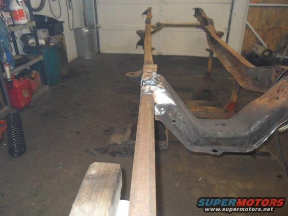

After that was all done I chopped the front part of the frame just before the engine cross member, If I was going to do it again I would have just made my own engine cross member also, but oh well its done now....
Cut the front frame to make it easier to mount my steering box, radiator, front bumper and what nots....plus 2x4 tubing is stronger than stock stuff...
After it was welded/braced I finished wire wheeling the whole frame, removing extra crap that I didn't need I primed and painted the frame with some black Valspar tractor paint. Sprayed that on and wow it looks good...

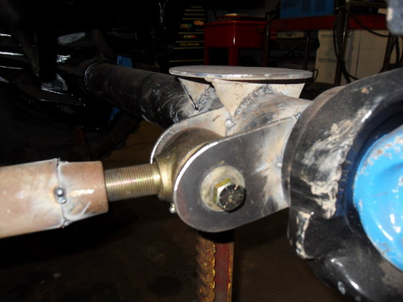

3rd link mount....it will be boxed...and braced as the same location will be my track bar mount.
Picture of the rear of the link mounts....these are mounted to a peice of 2x4 tubing...thats welded to a 4x5 peice of 1/4 inch will be bolted to the frame from sides and bottom....
Added a little more bracing to this
Full bump link to frame clearance.

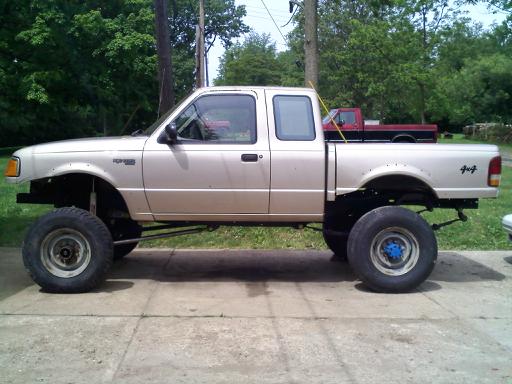

Then it was time to cut the bed.......
Cut about 13 inches(cant remember now) out of the bed right behind the cab to get it to fit the frame/wheel wells...
Cut and ready to weld...
