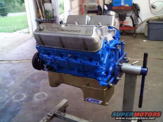

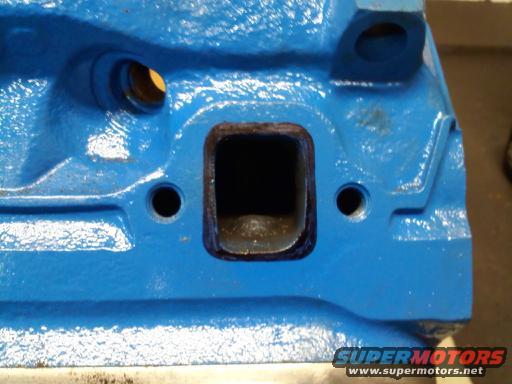

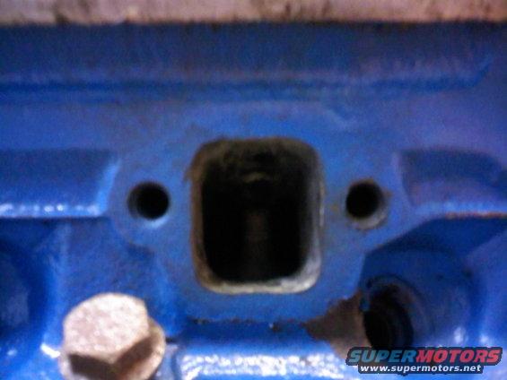

Well after getting the pinion angles close I removed the engine to finish cleaning it up. Honed the cylinders, new water pump, HV oil pump, longer pickup tube for 7qt pan, new timing chain, new timing cover, polished valve covers, ported the heads as much as I could without removing valves, cleaned engine and heads and painted ford blue. Still needs finishing but im making progress.....It is already bored .060 over so It is actually a 362ci
Before Valve cover polish
Head before (exhaust)
Head after (exhaust)
This pic is of the rough porting....is alot smoother now.
