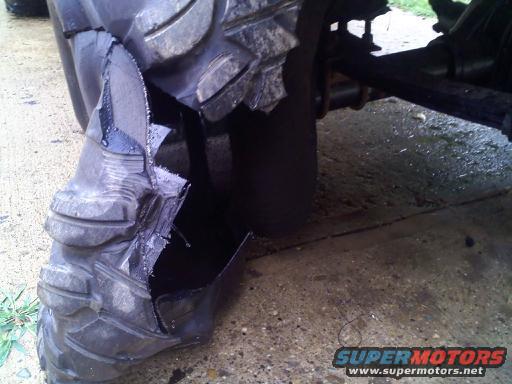

Ill start with a funny story.....funny because I only spend $75 dollars on my bald 39.5's....About 2 weeks after my back accident, I was filling up my tires because 2 have slow leaks, well I have a clip on chuck, clipped it on, walked away went and changed out some laundry and my dad asked me something upstairs so I totally forgot about my tires at this point......so were standing on the deck about 50 feet away from the truck and BOOOOOOM!......truck jumps and well.....tires junk.....So from about 10psi to whatever it got to took about 4 minutes....so probibly 150ish PSI if your ever wondering how much a tire can take. This is what pain killers can do, maybe this is why they tell you not to drive or operate heavy machinery on them....Anyways ENJOY a laugh on me!!!

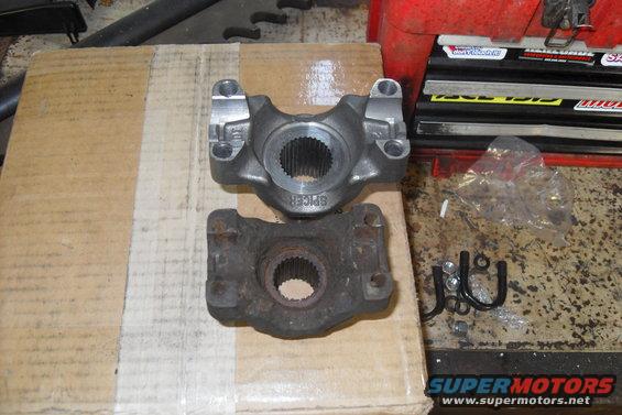

Got my 1410 np205 yokes thanks to onetoncv on pirate or high angle driveline
This is next to a 1/2 ton 8.8 yoke if I remember correctly...

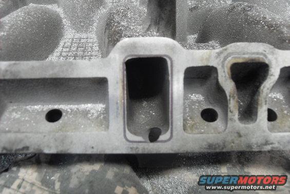

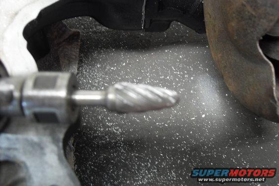

Used for aluminum intake porting.

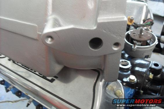

Lower before(Dident take an after picture for some reason)

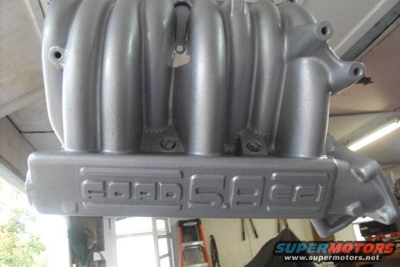

Upper after port and cleaning and silver paint...I almost painted it black like the lower but changed my mind last minute.....

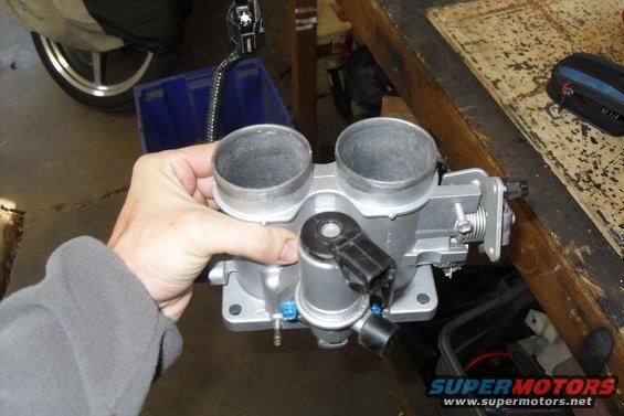

TB

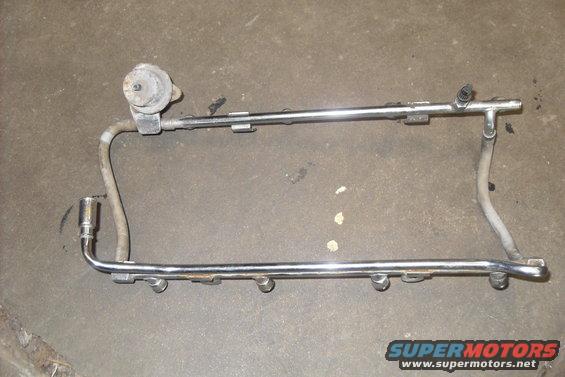

Injector rail

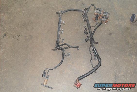

Injector wiring
Rest of wiring....up to firewall....
Pretty much up to the wiring part. Found good free 19lb injectors, ported upper/lower intakes, cleaned all the years of shit out of them so they should flow pretty good now. From what I've read the lower intake on these truck setups is the choke point so that's been opened up a lot, mostly to match the head porting. Probably wont help much now since I still have stock TB and stock 19lb injectors, but from what I've read with the right tuning 19lbers are good for 310hp. I will never know exact numbers but I just want a good clean running engine.

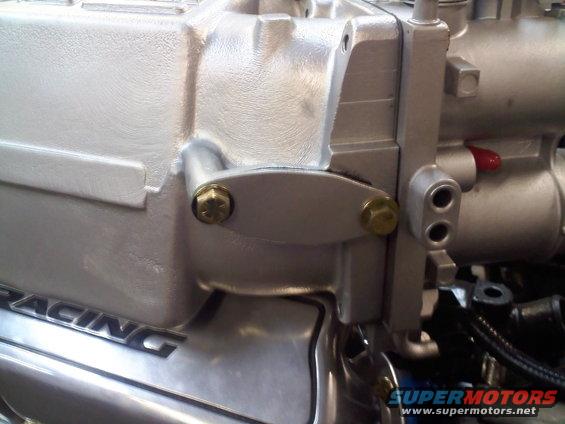

EGR delete plate for the intake is done, also plugs in back of head were installed a while back before painting.

Also waiting for a buddy or two to come over and help me remove the trans/tcase again so I can install my new 1410 tcase yokes and trans filter and maybe a little trans pan beef.

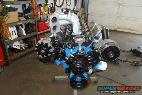

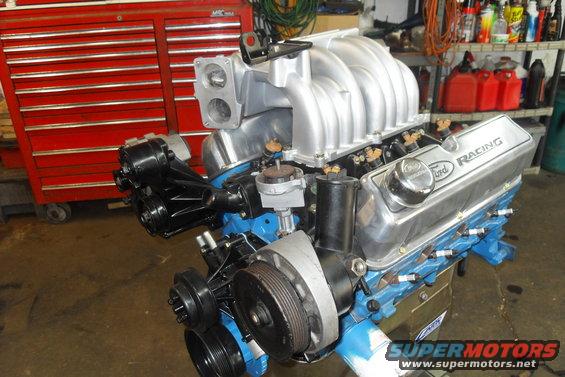

Currently engine is in and pretty much complete
Trans is complete with some updates
Tcase is complete with some updates

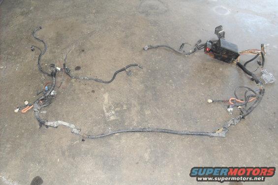

Currently working on the wiring....getting the engine harness to work with the ranger harness...should be fun
