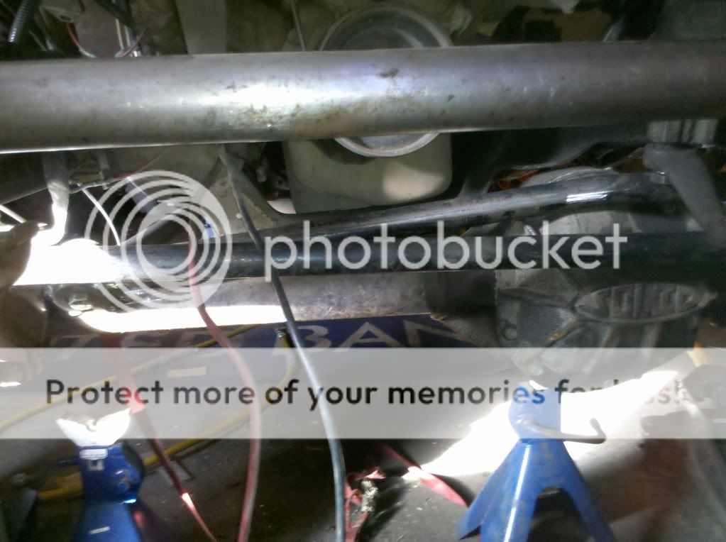

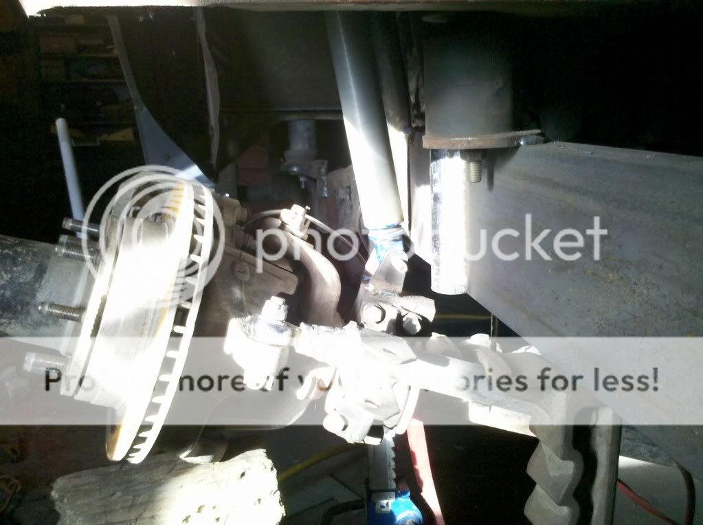

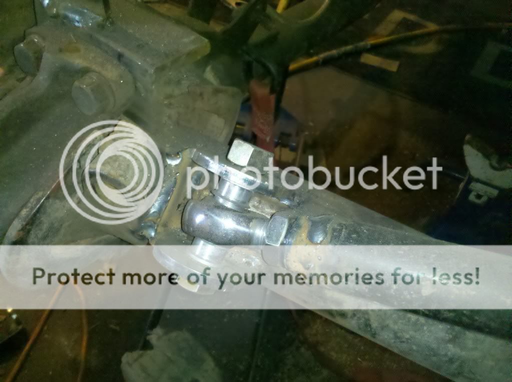

Got out there a bit today, no pics. Got my newer radius arms mounted, lower fox shock mounts to the radius arms. Built the RF shock tower.
Mounted the gear box today, about 3/4 done on that. Radius arms are under it and attached.

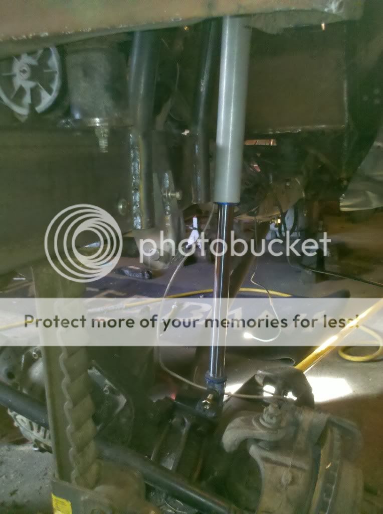

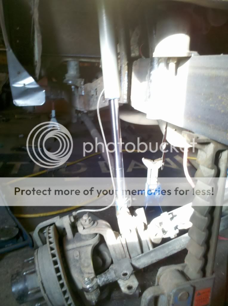

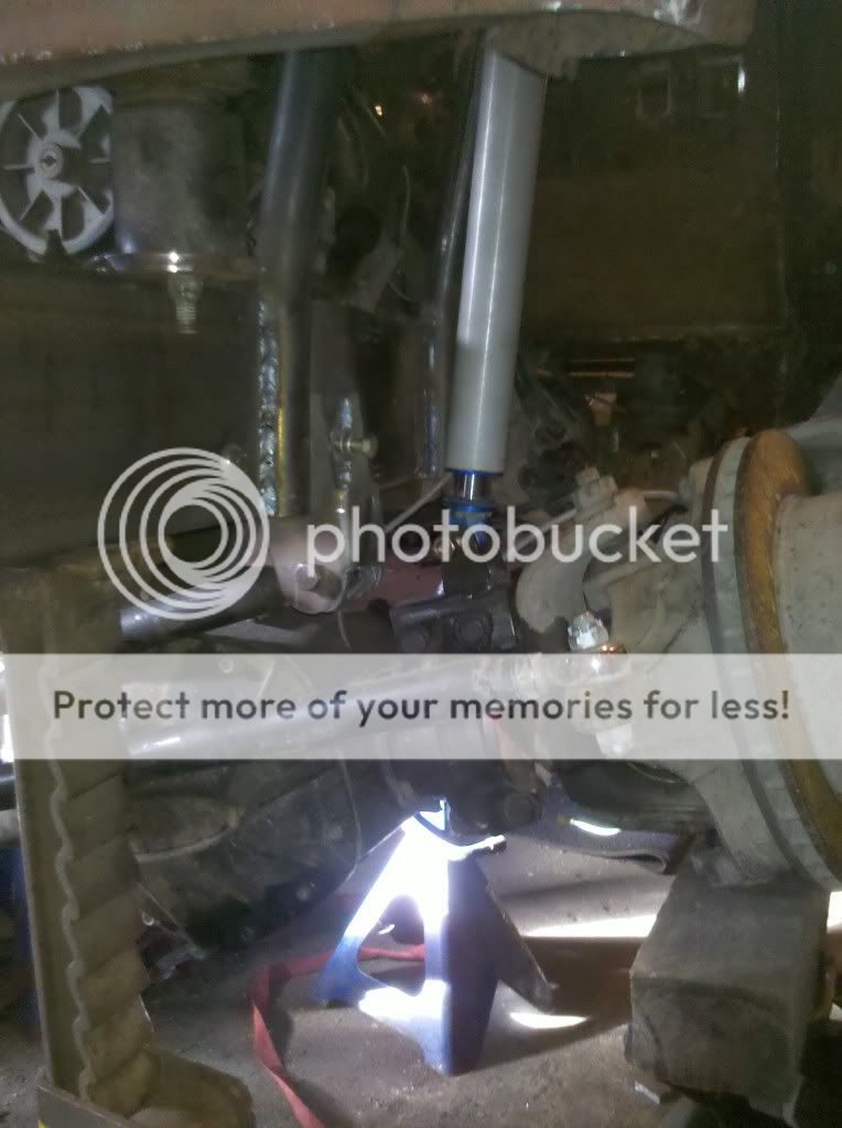

some more pics of checking clearances and what not at droop and compression. I DO NOT have my bumpstops installed yet.
Rear shocks mounted

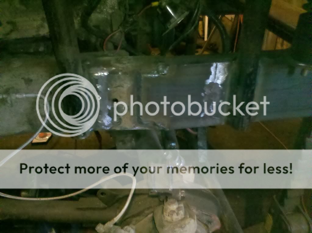

Start of the rear bumper

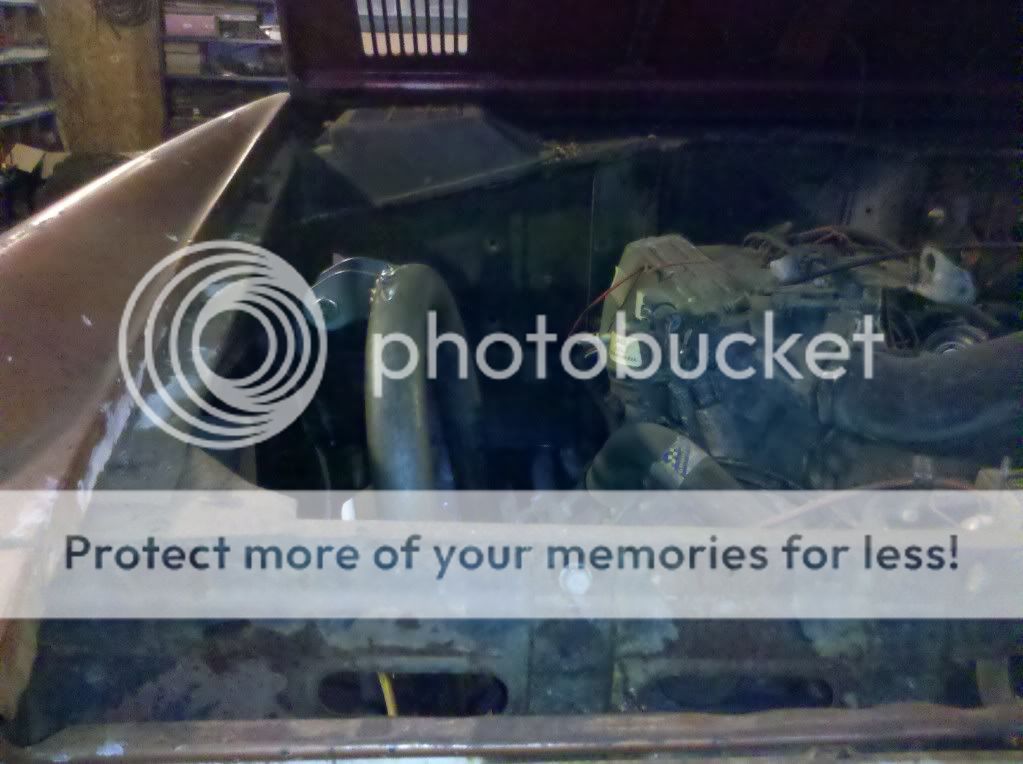

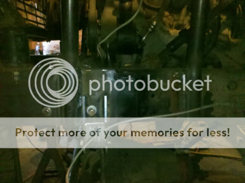

Crossover bar so far, notched it for the throttle linkage. Without the notch the throttle in sweep was a 1/4" away from it. But obviously the motor is gonna twist and move a bit so I wanted a little more "just in case" clearance. Need to make it removable next. Its just "in place" at the moment.
