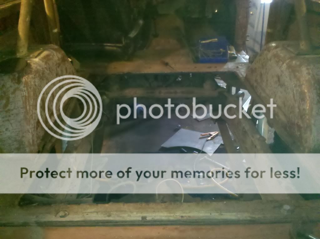

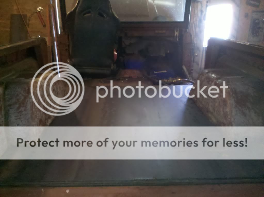

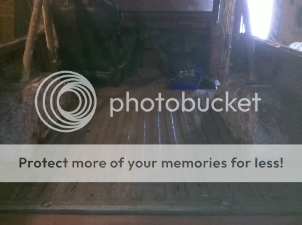

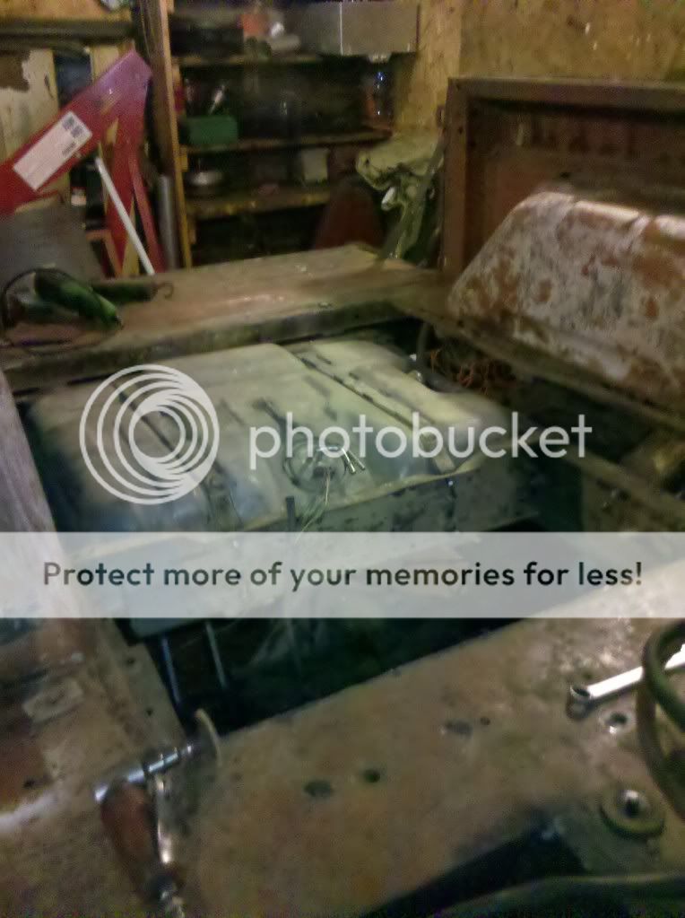

Well got my fuel tank mounted in the frame rails, just need to extend the lines about 6"s. Also welded my traction bar brackets to the 14B while the floor was out. I was told today my cage was ordered and I am hoping to see it by next weekend. Should give me plenty of time to wrap up the dash and get it final installed and the int. wiring as well. Then once I get the cage I can finally mount my seats.

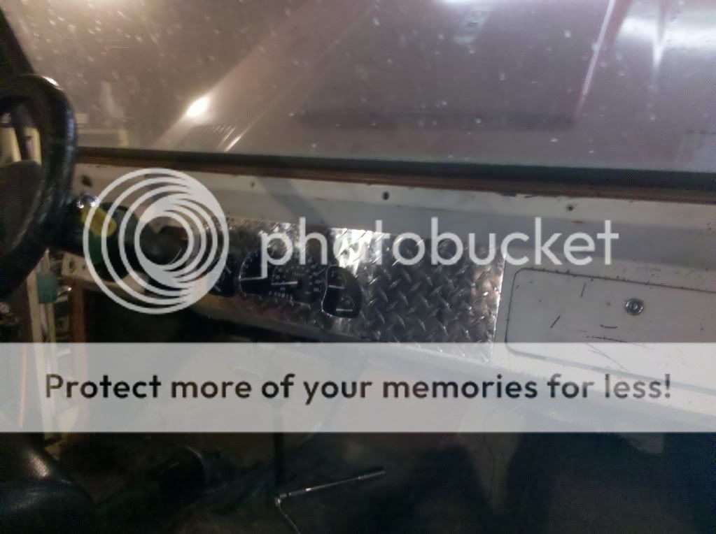

Think I got the dash harness pretty much squared away, Gonna paint the dash tomorrow at work and hopefully get that done and finished aside from the wipers. Laid some paint on the front half of the interior as well, hopefully it will be dry by this time tomorrow.
not leaving the blingy diamond plate eh?
