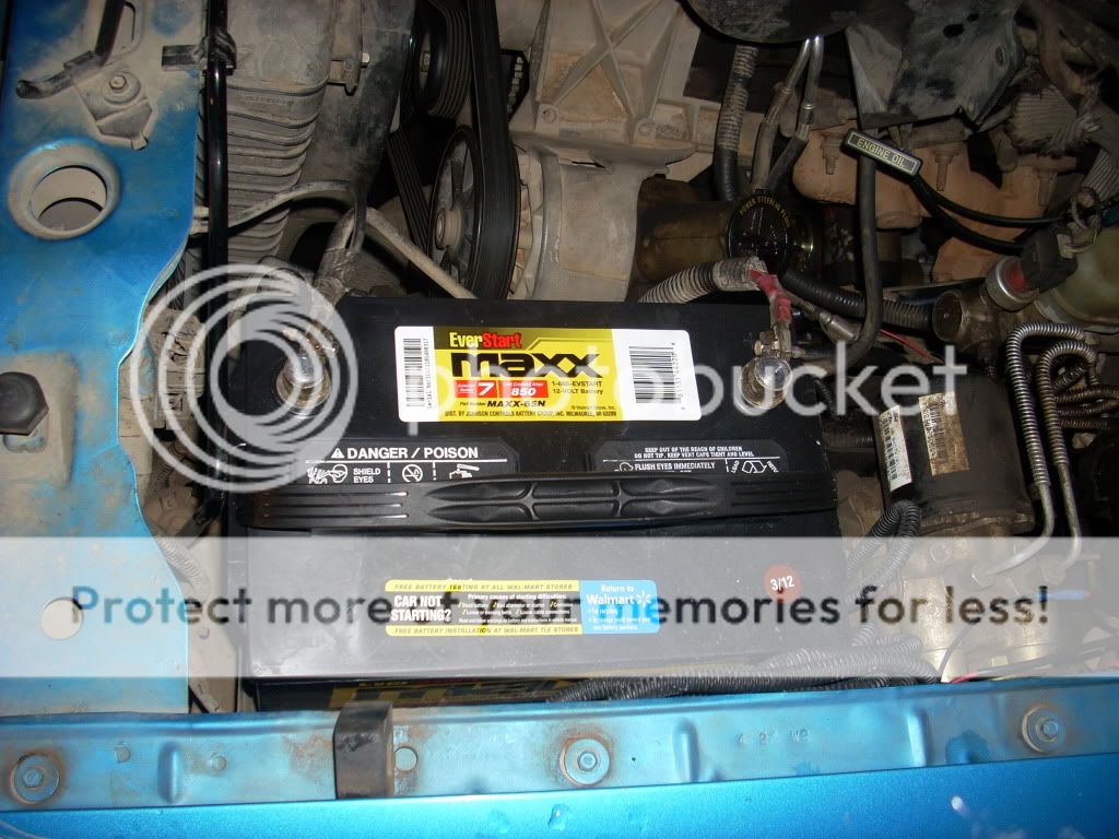

Well, my truck died on the way home today. Turns out a free battery out a parts truck is not very reliable.....
New battery...
1 ton, caged ranger
Did you get the rest of the electrical issues fixed?
Love those everstarts. And those battery terminals are less than desireable.

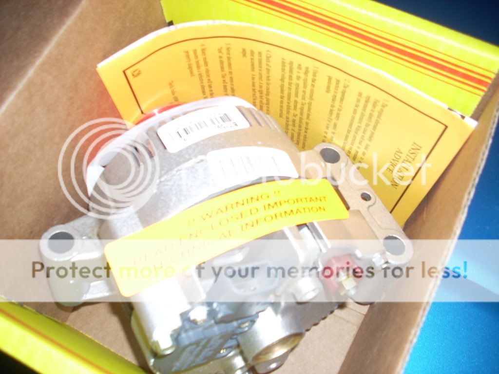

So we thought maybe that it was a bad re-man. Switched it out and same story, no charging at all. We used an excide tester, re-tested it with a d-tach and no dice. Still said bad alternator.
Summary, new battery, new alternator in the past 24 hours. Still no charging. I am taking it to a shop tomorrow for them to try to figure it out, we had no way of testing amperage output of the alt.

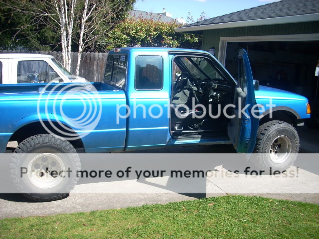

Thanks for the offer but I am gunna build an aluminum dash
Sweet!
That cage is looking good. I want to put one in mine, but my cab has a bit of rust. I need to find a cleaner cab first then i will put a cage in.

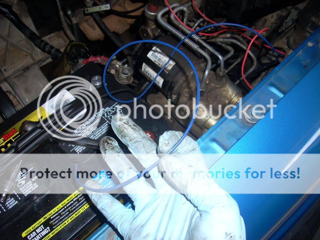

Well I got the brakeline fixed. We ended up just cutting the end of the brake line off right after the hole and re-flared it with the stock fitting and it still is long enough. I have a new sensing wire most of the way ran, I should be able to button it up and bleed the brakes by the weekend.....I hope...
There! I finally was able to rep you for the shock towers (and for having a killer truck):icon_thumby:

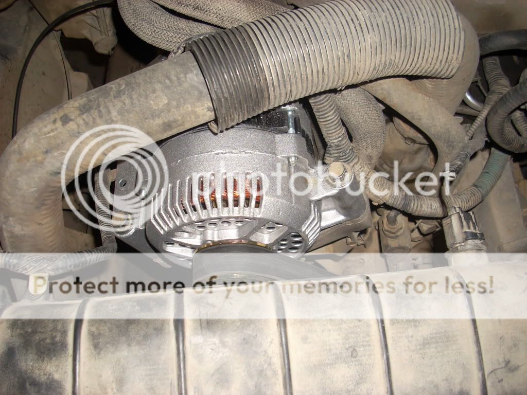

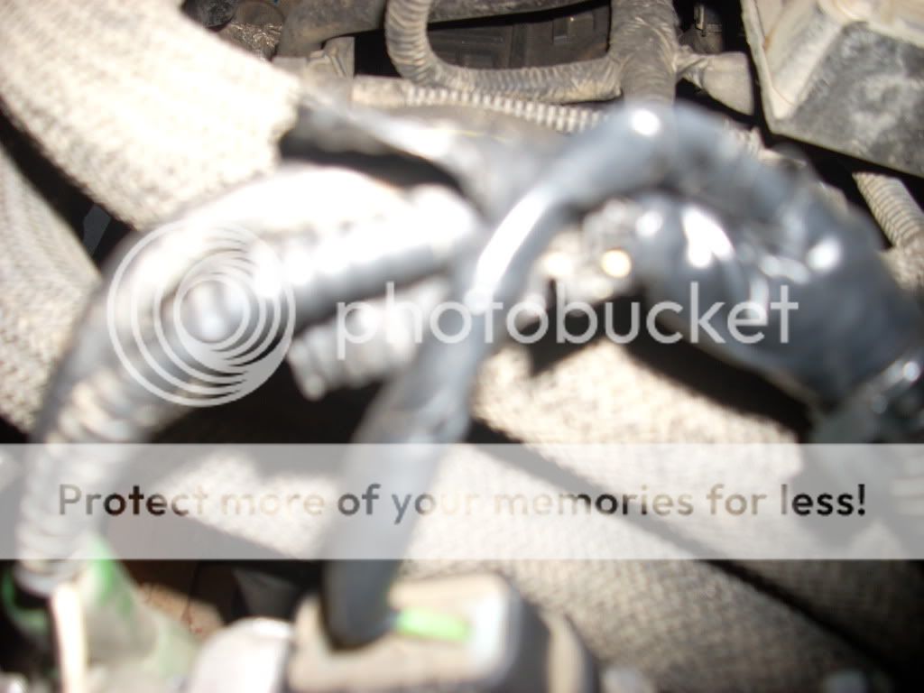

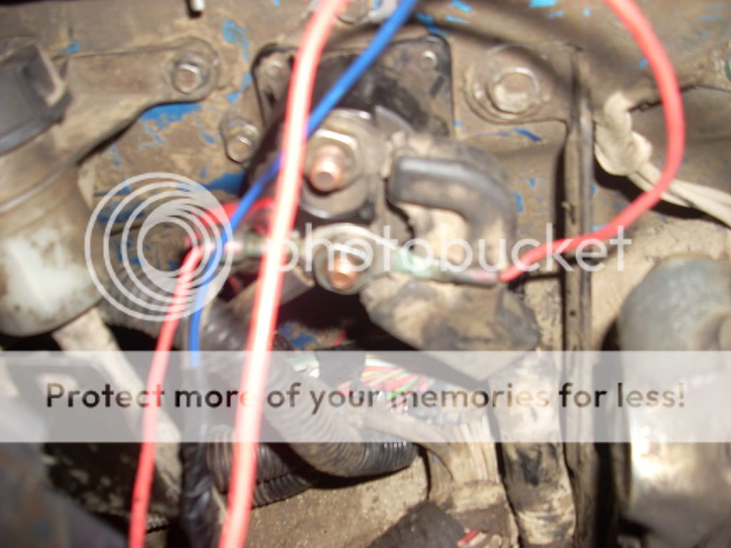

Got it all together and wired up. We were gunna bleed the brakes today but I drove it and don't notice any change from normal which is actually kinda weird. But I had ran out of time anyways so I will take it back to the shop next week and bleed them. Here are some pics.
1 ton, caged ranger
New sensing wire
1 ton, caged ranger
1 ton, caged ranger
