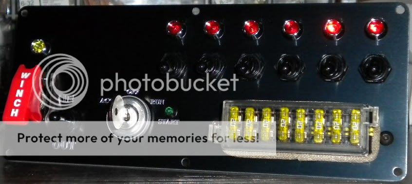

Talked to Dave, Im gunna put a switch in it. Then on thursday (I think) I will order this 12volt guy switch panel.

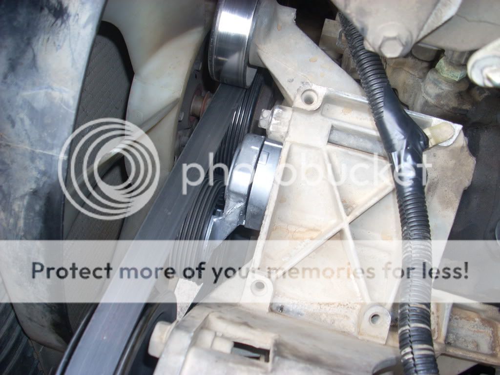

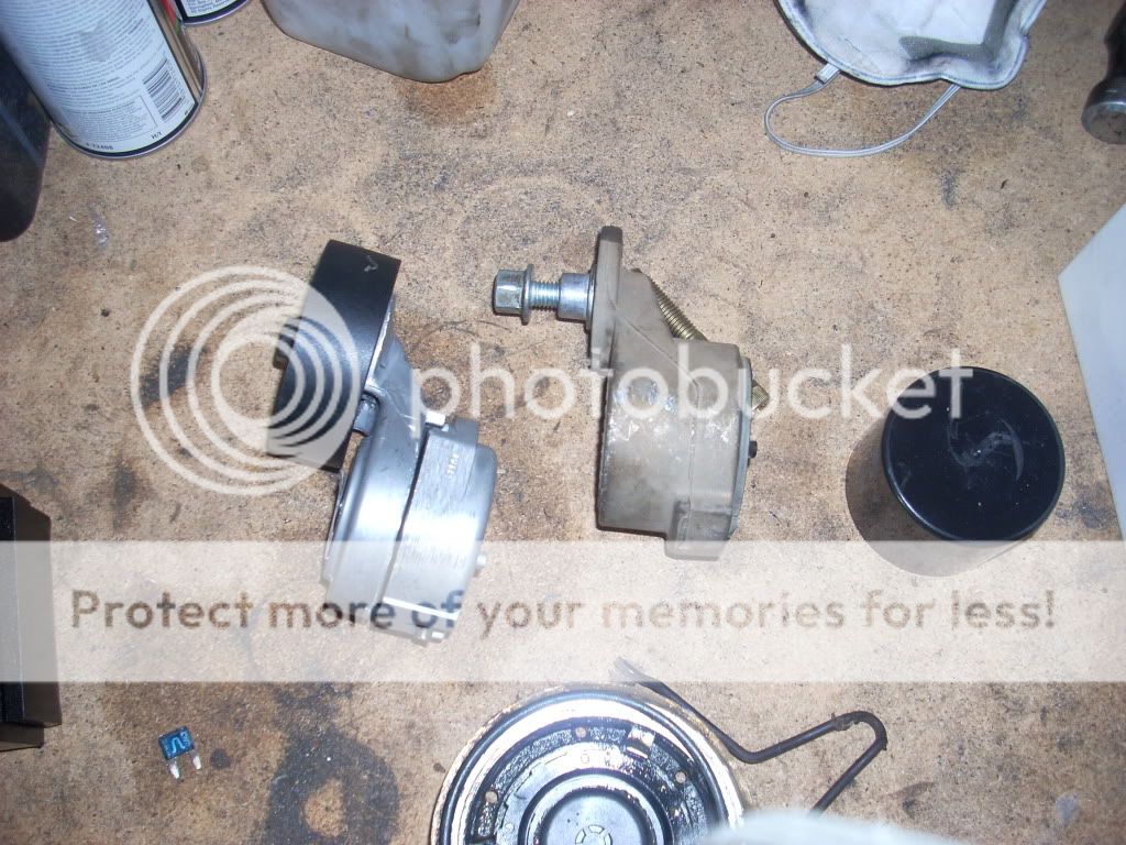

Belt Squeal problems: So my belt was squealing very loud after ~2400 rpm. It started when I put in the new alt. I figured out that it was from the tensioner being bad and the pulley being the wrong one. The belt had about 1/4in hanging off of the pulley. I got a brand new tensioner and pulley and I got them to take the old pulley as credit. now it still squeals but only at ~3500 rpm.

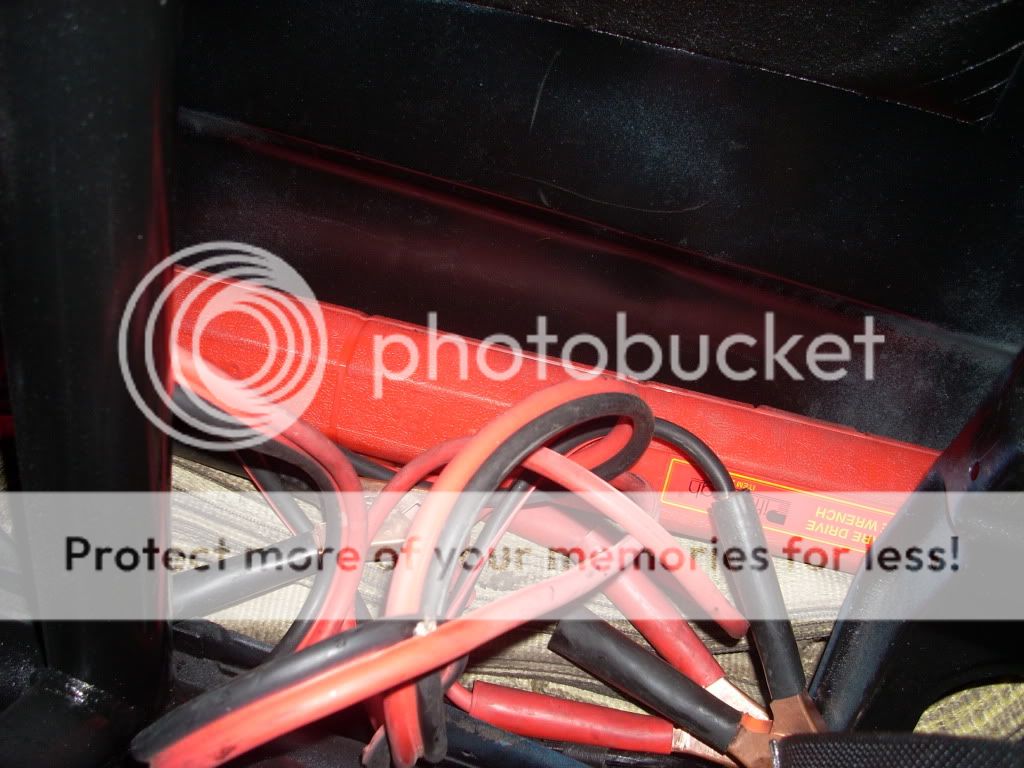

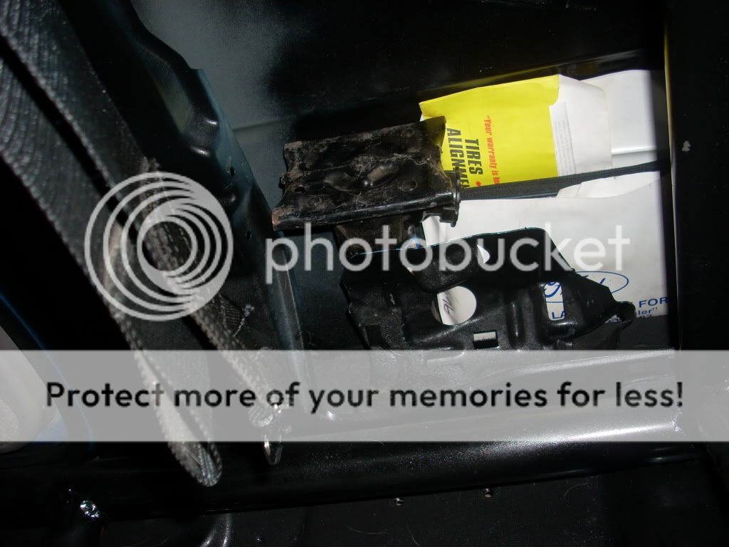

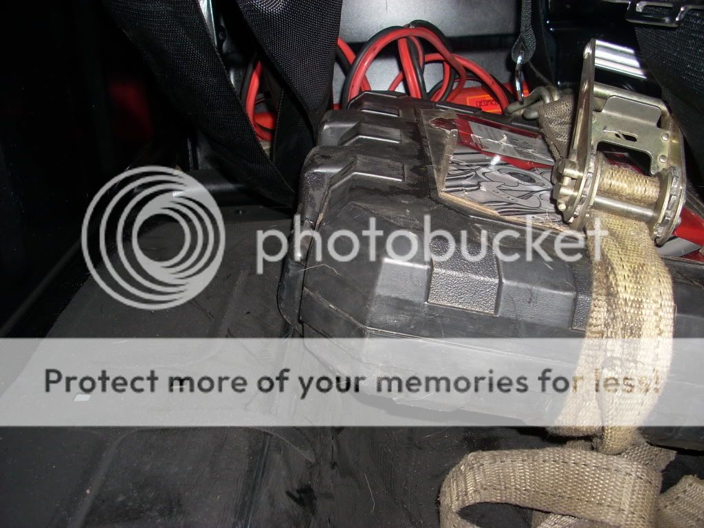

Crappy pics of how my tool box straps down and my other tools fit where the jump seats used to be

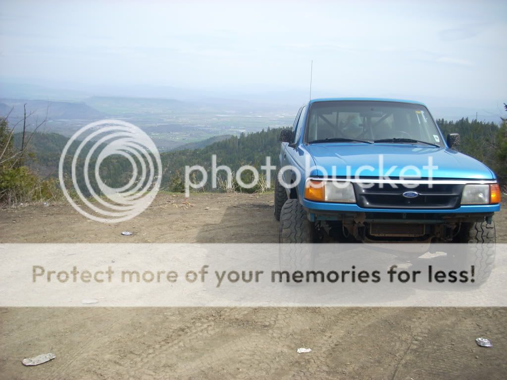

Just got back from a little jaunt up in the hills, no real trails just some dirt roads. It feels great being out again and I am going to try to make more time to just get out for a while.

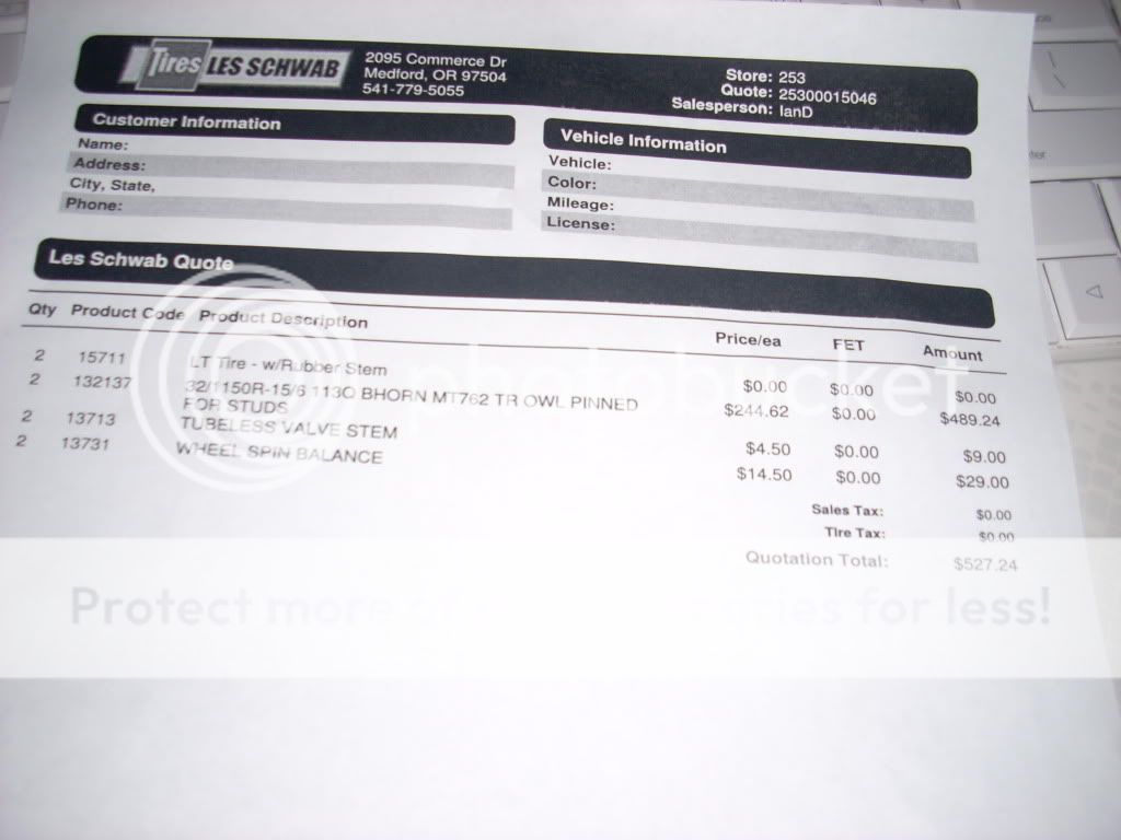

I also got a quote from les schwab for two more maxxis bighorns to replace my swampers and it will be about 500 bucks. I think I will do that and use my one good swamper for a spare. It should ride way nicer, be quieter and I will be able to sell the set for more when I do the SAS.

I think that's what is wrong with my truck too, the belt squeals like no other when it is first started in the morning, especially after it has been cold the evening before.
