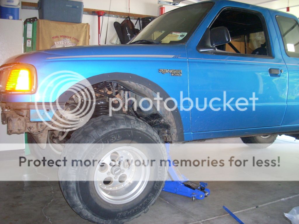

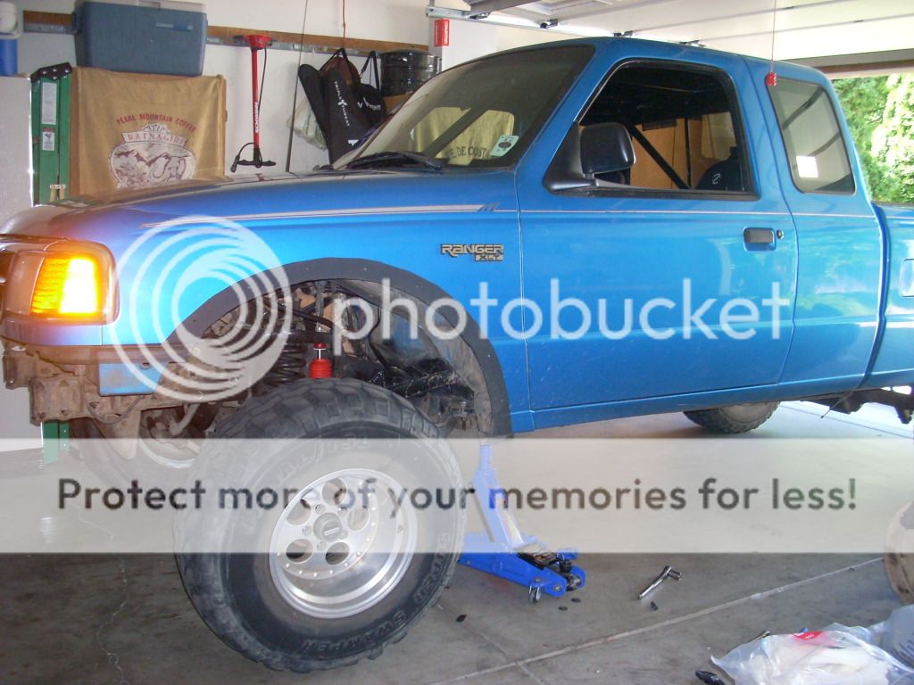

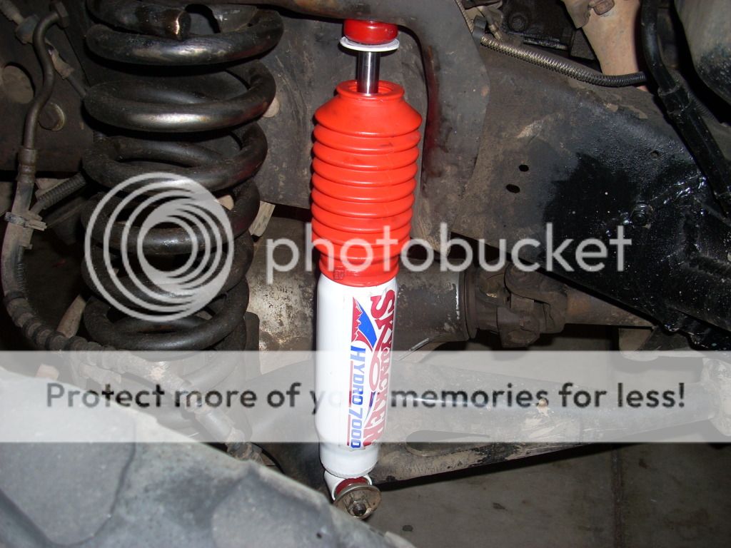

New shocks in, went from 41 1/4" to the fender lip at full droop to 42 1/2". I only drove my truck a couple of miles on smooth roads after putting them in but I hit the biggest bumps I could and already it is way smoother and has less rocking back and forth when I hit a bump because the shocks are actually long enough.
The shocks are skyjacker hydro 7000's, well worth the money IMO.
Full droop before:
1 ton, caged ranger
and After:
1 ton, caged ranger

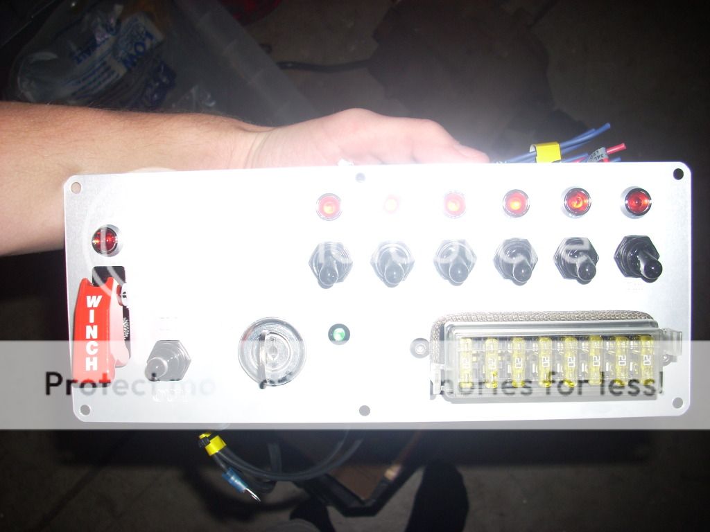

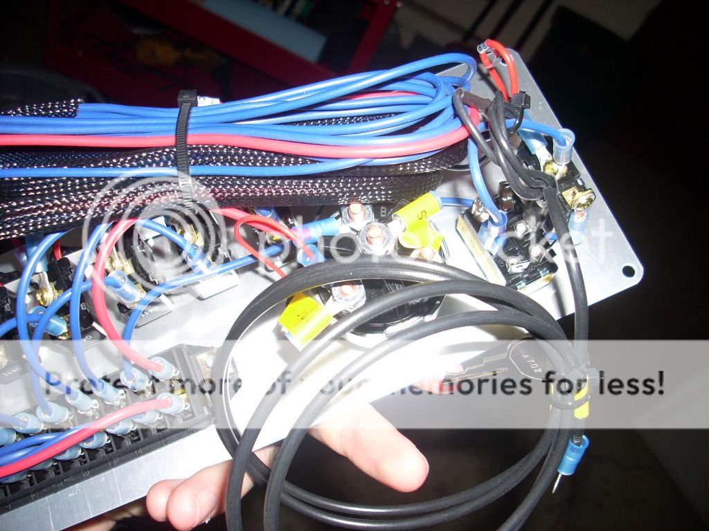

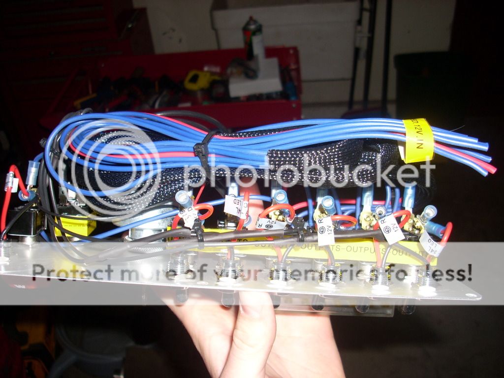

Also I finally got my switch panel from 12 volt guy. I am VERY pleased with it, very high quality parts and everything is labeled ect. My engraving got a little messed up though, they got some words mixed up but I am attributing that to me just adding a note of what I wanted and not drawing it out. IF YOU BUY A SWITCH PANEL FROM 12 VOLT GUY MAKE A DIAGRAM OF EXACTLY WHAT YOU WANT SO IT COMES OUT RIGHT!
1 ton, caged ranger
1 ton, caged ranger
1 ton, caged ranger
1 ton, caged ranger

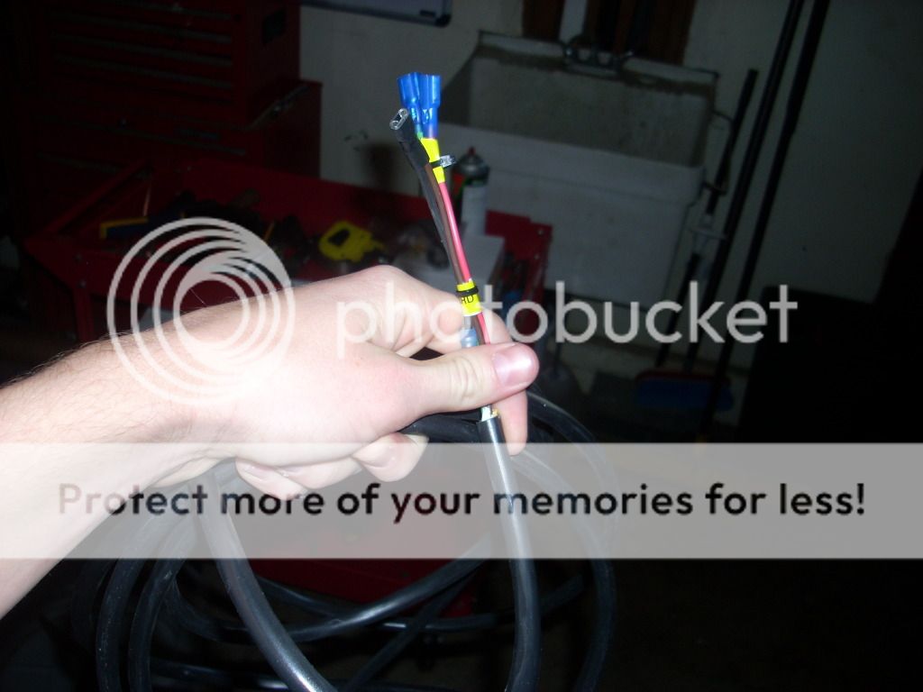

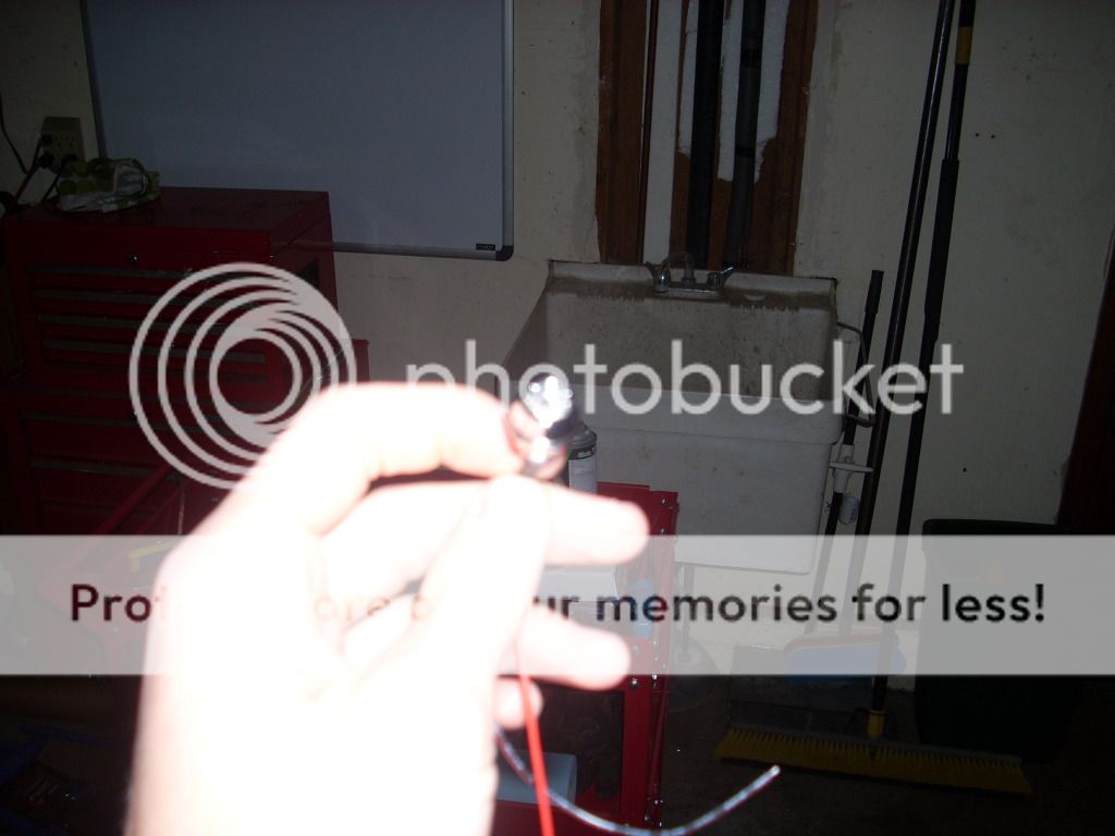

Also I ordered two of these LED's from them for cab lights
1 ton, caged ranger

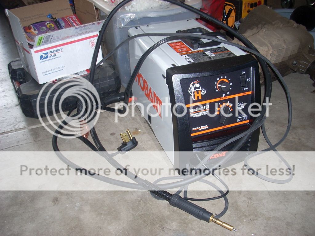

Also big R had to order my welder from Klamath falls, but it should be here tomorrow or wednesday. I am going out of town though so I will post some pics at the end of the week

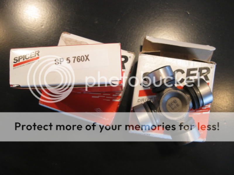

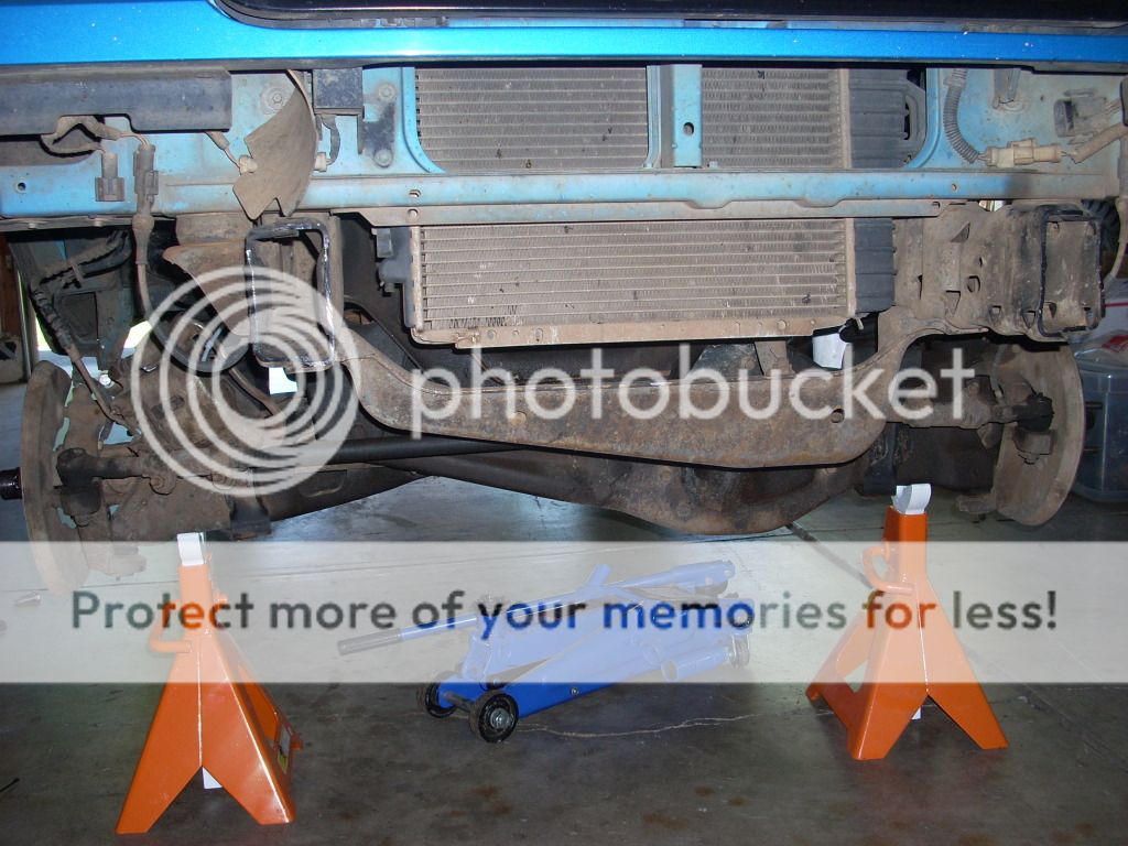

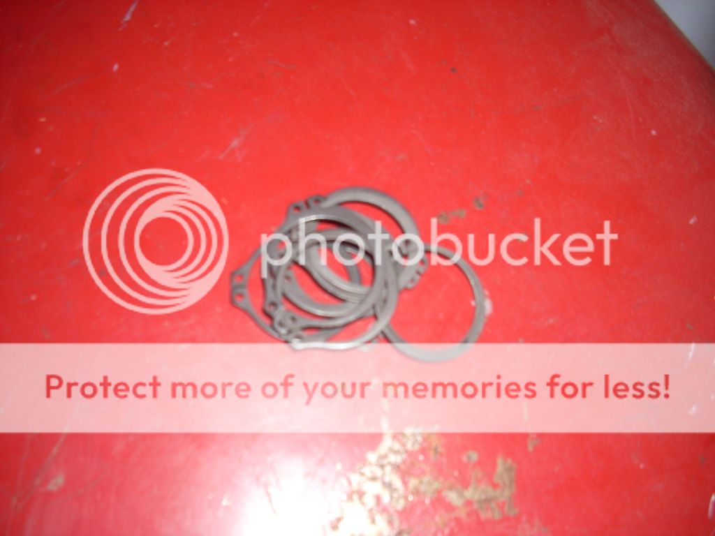

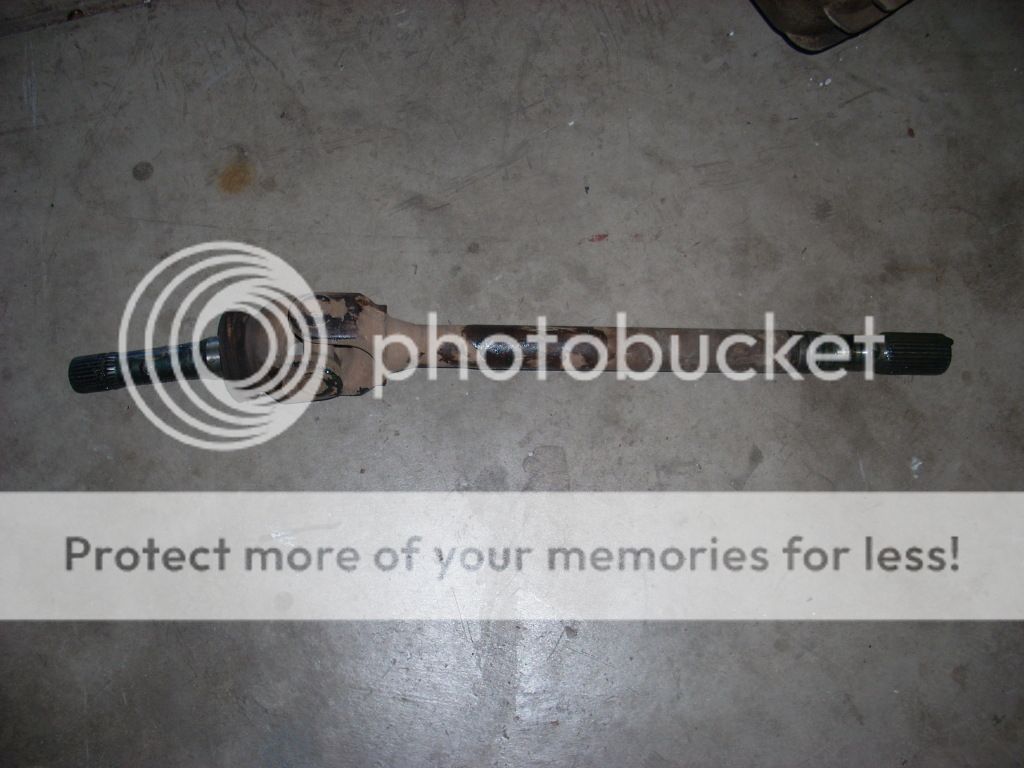

Got some 5-760x u joints and full circle clips. I have another truck to drive until we sell it so I am tearing down the front end of my truck in the next couple of days to do a c-clip eliminator, swap in the joint and weld the front
Hahaha weld 'er up buddy. Don't run bigger than a 33 is my advice. With a 35" tire, you will EASILY blow shit up. My opinion is that a Dana 35 shouldn't see bigger than a 33 to stay reliable. The old front axle in Rangebe 2.0 was the 28/35 hybrid. So it had a Dana 28 center with 35 shafts....welded up the spiders and used 5-760x joints. I was running 31" swamper LTB's that measuered to 32", and beat on it HARD. You shouldn't have a problem. Just don't bounce off the rev limiter with the wheel turned all the way in one direction. These rigs become whole new animals with 4 wheels churnin' :D

I had one side completely torn down on the ranger today, and started pulling apart the other and I had to make a parts run. The truck I am driving blew a head gasket (99% sure) and I jacked up a brakeline in the ranger. So I put one side back together and the other side is getting put together tomorrow when the new brakeline gets here. So basically no mods were done to the ranger. But we are planning on busting out the jeep in the next two weeks, then I can have a second set of hands and we are going to bust out all of the mods on my ranger in a weekend. Hold out for some updates!

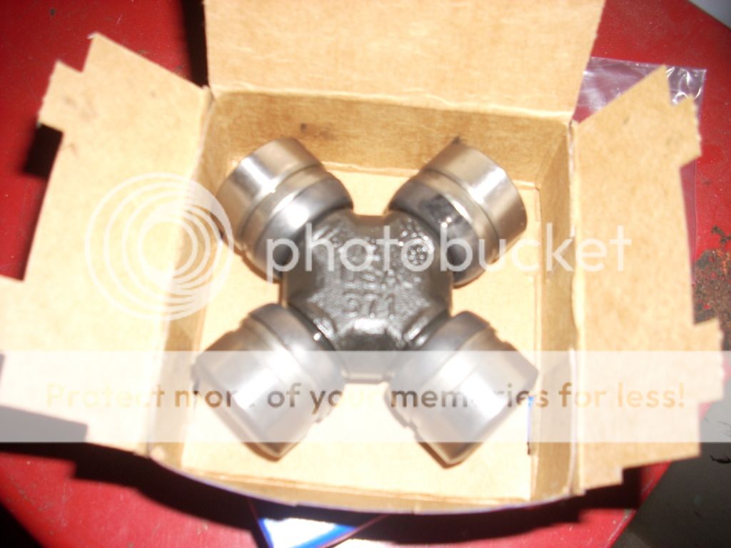

just noticed...those ARENT 760x's....heres an old pic of mine....
1 ton, caged ranger
I talked to the people at napa, they don't get spicer joints anymore but these cross directly over and have the same reference numbers as the 5-760x joints. Do you happen to have some dimensions on hand of yours so I can figure out if these are going to work?
They will work fine. I used to run them.
