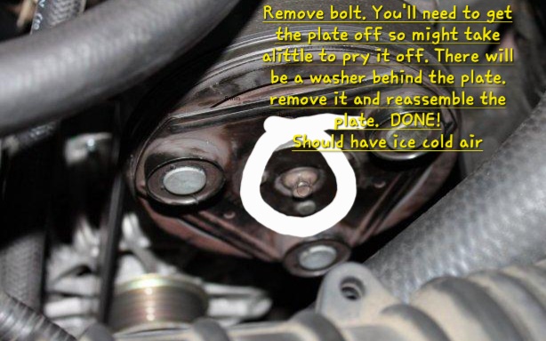

Mine did the same thing, I have a 2001 also. This is what I found to do.
Find A/C compressor, right bottom side of serpentine belt. Get the plate off, takes some prying. There should be a washer behind plate. Remove it and reassemble the plate back on . Should help and have ice cold air always!

As said by Kaylynn the AC Clutch may need to be re-shimed
AC clutch works by making the "coil" behind it into an electro-magnet, this pulls in the metal clutch plate engaging the compressor
If the metal plate is too far away then magnetic field can't pull it in or can't hold it in, engaged

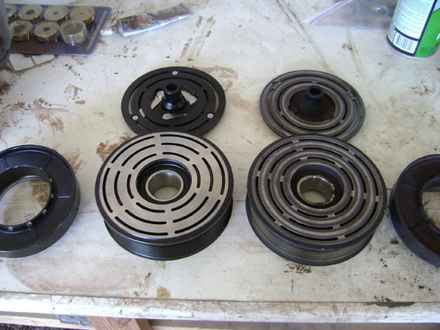

On the clutch matter only, seeing as you live in Florida it wouldn't be out of place to take the position that you use the A/C on a regular basis.
The clutch surfaces do wear, if they cannot *mate* together cleanly then the clutch plate gap will open up & the clutch will not remain engaged.
one needs to remove the clutch to examine both mating surfaces to see if they are both flat & smooth.......
