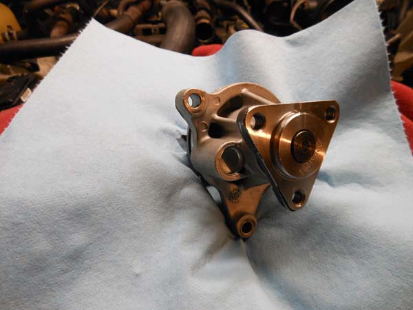

Just for illustration...
Here's a photo of the new pump. That little freeze plug is toward the bottom when the pump is installed. After driving when I would look up at the assembly from below there would be a drop of coolant visible on the bottom of that contour.
Thanks, Again!

Since I wasn't there to take a look, I am guessing you got a bad "new" pump. Now a days, you are the manufacture's quality control department. They make them, box them and send them out. New no longer means good.
That is why most mechanics don't buy from the corner auto parts stores. They can't stand to be out the extra labor of doing the work twice.
That said, keep a close eye on the old pump. There is usually a reason the old seal failed. Like a worn impeller bearing.
