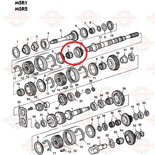

There is a bearing inside 3rd gear itself - part 15 is the bearing, 16 is 3rd gear. It also could be related to part 13/14 assembly too if the springs & keys are missing or damaged. Since you can feel it through the shifter it would make sense in my mind. I guess it could be something broken or loose inside the top cover (shift rail, fork, etc) but that seems less likely.

Thanks for the diagram, that helps too.
