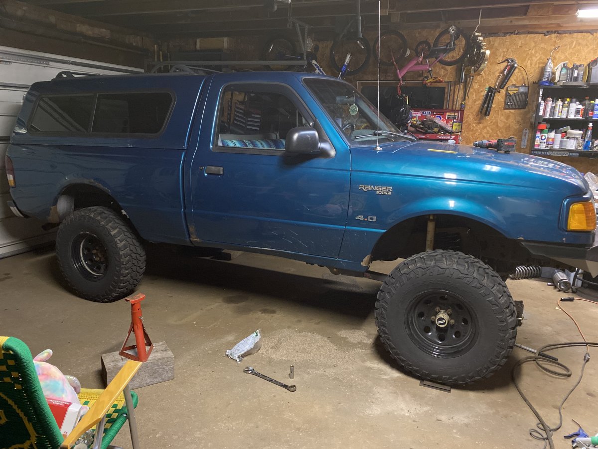

I’m 6’0” and the hood is nipple high. I hope the skyjacker 134’s settle a fuzz. Camber is positive 1° on both sides with the tuff country 2” brackets at full negative camber.
Worst cast scenario, I’ll run a Chevy drop shackle in the rear and run it until either the springs settle or the tires die. Topper comes off tomorrow so I can haul drywall.

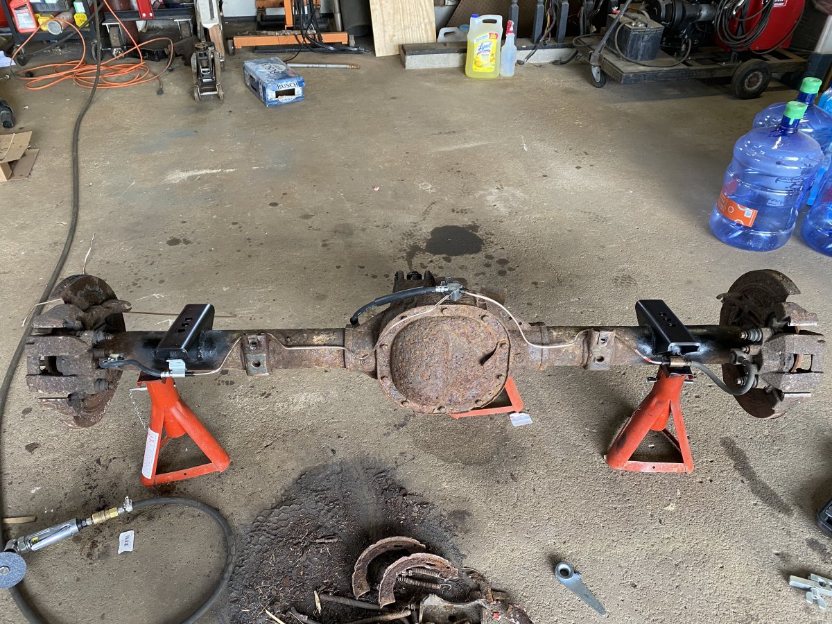

Anyone have a source for new disc brake 8.8 dust shields or just lose them and forget it?
41934
The rear brakes get all the splash and road spray from the front wheels and need to be protected as much as possible. If you know what year or year range the axle came from, you could check Tasca or Ford parts for replacements.
I need to replace one of my front ones because connection broke where one of the bolts attach it to the knuckle.
Fawk em. If you drive it .....they stay cleaner with a powerwasher. Have not had any on mine ever. You can fab better ones that just pin on anyway If your weary about it.
The bronco is drums front and rear....they got covers obviously but you can't wash the dirt out.
Of course I have full width axles on my ranger. it's full floater and the rotors are right out in the wind... At least your wheels offer some protection.

I’m not afraid to run less the dust shields, but in winter, when it probably matters most, the truck sits while the van serves daily status. I don’t want to throw a set of pads and rotors at it yearly. I bent up nicopp brake lines for a reason and plan to use AG paint on the axle when I get it wire wheeled because I want it to look good for more than 3 months. Welcome to Wisconsin. Corrosion sucks.
The axle came from my old ‘99 explorer. I haven’t found a new replacement yet. Would be easier if a part number was easy to find :LOL:
