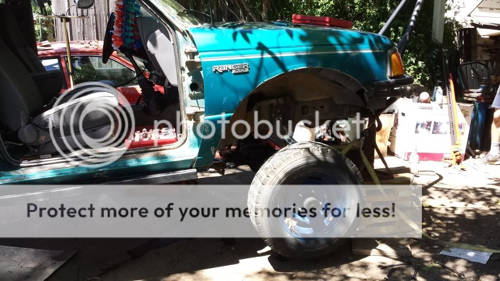

cutting and reinforcing the frame:
I cut the top and bottom of the frame back a few inches because the stock frame isn't straight and I plan on running some plate about a foot back along the frame since the frame has so many holes for the crumple zone. Don't mind my crappy welds....

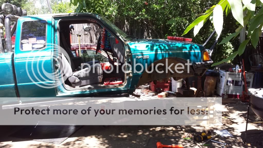

Couple more odds and ends.
Kinda hard to see: rocklights.
also a little bit more progress on boxing in the frame.
planning on bolting the winch plate to the frame. I like the ability to take stuff off (within reason) just in case it doesn't work out.

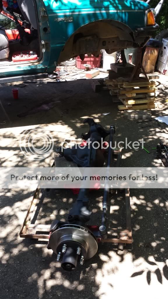

Got a little bit more done today:
Now I need to cut my front body mounts off so I can plate the frame back aways.
So far I don't think that the amount I have extended the frame should interfere with my approach angle too much...
