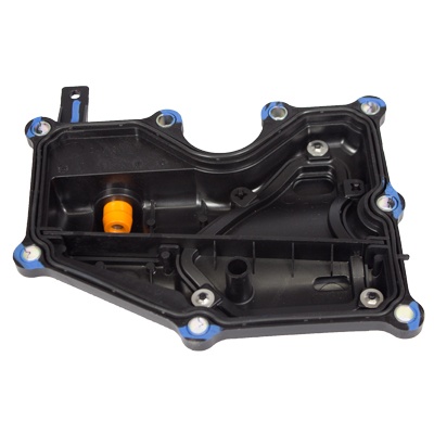

With regards to the existing "oil separator" on the late model 2.3's - where does the collected oil go? Does the operator have to empty some type of reservoir? Have not heard of such a thing.

It drains back into the crank case. It’s either built into the base that the oil filter screws on to or right next to it. I tried searching it and only came up with catch can results for the ecoboost and only one video about it for the duratec. Being that I’m on cell data, I can’t dig into if further.

Separator Assembly Oil - Ford (4L5Z-6A785-AA)Separator Assembly Oil - Ford (4L5Z-6A785-AA)
Mounts on the drivers side of the motor down low just above the oil pan.
