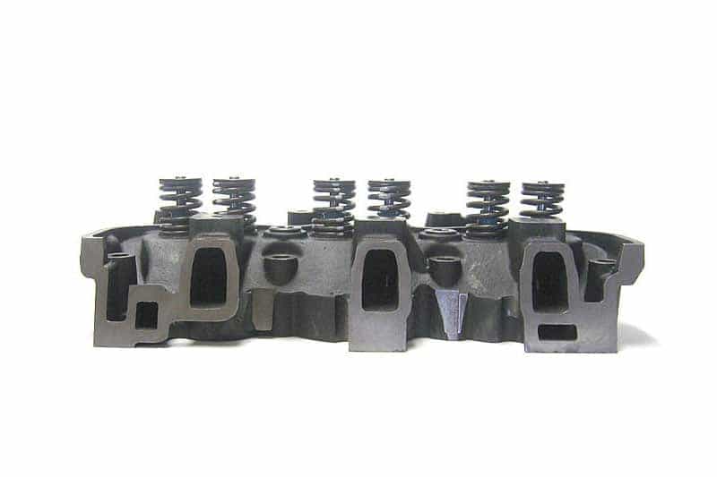

if im going to pull the heads i may aswell just put on a set of updated ones. and sure they make max tourqe below 3k but they dont run out of power until 5400 rpm my 2.9 is very rev happy with a couple degrees of extra base timing, hell i towed about 9k lbs at 45mph at probably 4k rpm. which is probably what started this hell. i could probably pull the heads and send em over to Kidd Perfomance here in idaho but they will probably be to damaged for me to want to repair them and it would probably be cheapest to just buy some new 89TM castings

I got 2 new ProMaxx Performance heads for my 2.9 and am happy with the results.
