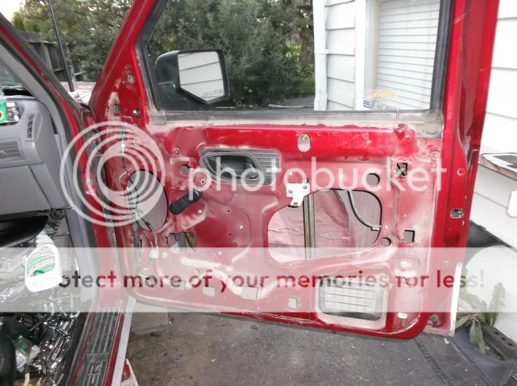

And the inside of the door. Still gathering stuff for this conversion. Still don't have door lock solenoids and related stuff. Haven't been near Princess Auto lately. Cheapest there, like half price...
No plugs for the 08 switches either.
