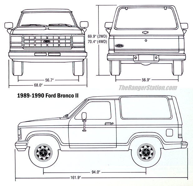

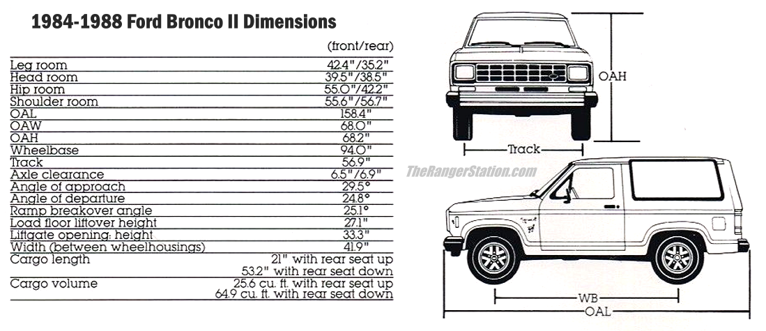

1966-1977 Ford Bronco Dimensions 1966 Ford Bronco Dimensions 1984-1988 Ford Bronco II Dimensions
1989-1990 Ford Bronco II Dimensions

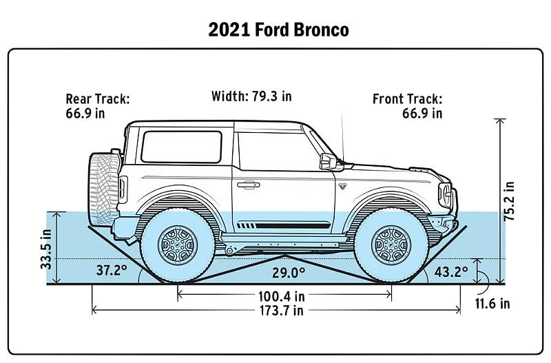

2021 Ford Bronco Dimensions
