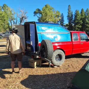

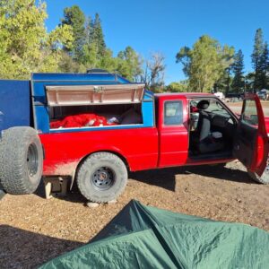

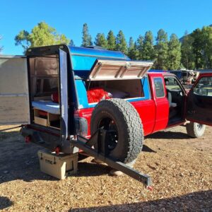

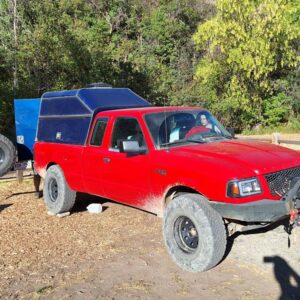

Brian’s Ranger is far from stock. Out back, he swapped in a 31-spline 8.8-inch axle from a Ford Explorer, now running 5.13 gears and an ARB air locker. Up front, the torsion bars have been cranked, while Explorer Sport Trac leaf springs help make room for a set of 33×10.50×15 all-terrain tires. Power still comes from the reliable 4.0L V6 paired with a 5-speed manual transmission.

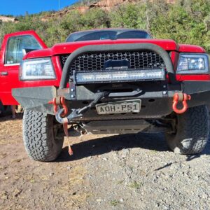

The armor is functional, too. The rear bumper with swing-out tire carrier came from Affordable Offroad, while the winch bumper up front was an Amazon find. From the looks of it, it appears to be the Ecotric winch bumper. It’s equipped with a Nilight LED light bar and a Zeak winch with synthetic rope. I couldn’t find the Zeak online, but a solid and affordable alternative is the X-Bull 10,000LB winch with synthetic rope.

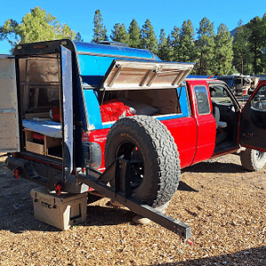

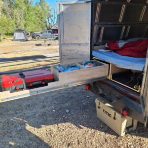

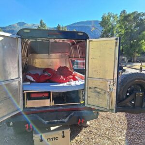

The real star of Brian’s build is the Leer DCC aluminum cap. Inside, he built a sleeping platform with removable slats so one side can be opened up for extra space. There’s plenty of storage underneath, including a slide-out drawer with room for his propane stove and camping essentials. He even cut a hole in the roof and added a fan with an adjustable motor for ventilation. The side lift doors make it easy to access gear—or just open them up for a nice cross breeze.
