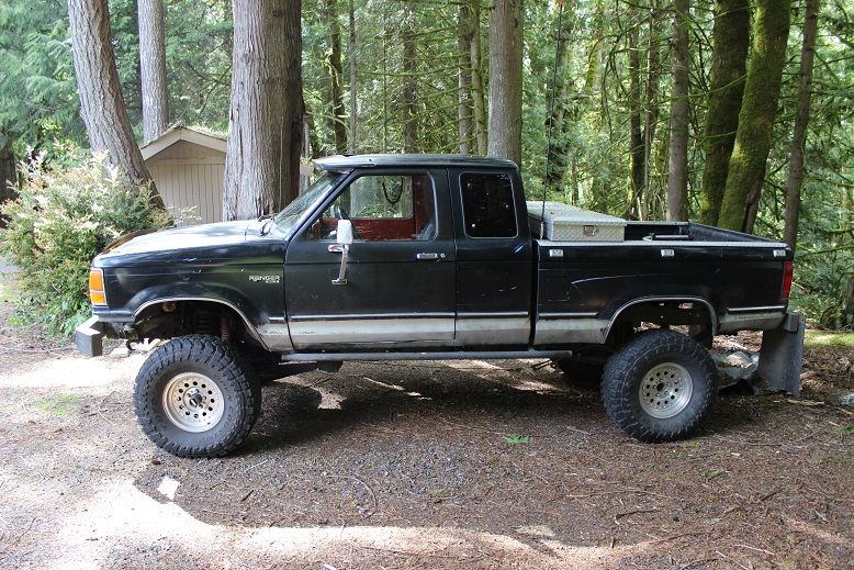

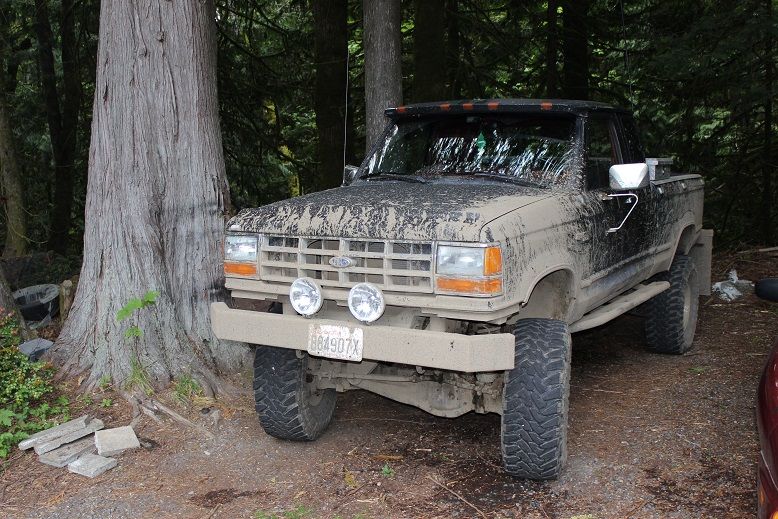

I don't even know where to start on making a comprehensive and legible build thread, so I figure I'll start with what I have now and make posts when I change something (that's how it's done, right?).

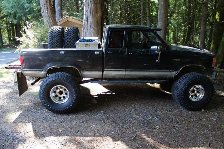

As it sits right now:
Suspension and tires
Skyjacker 6 inch lift up front
Chevy 64in shackle flip with Belltech 6400 in back
Skyjacker shocks

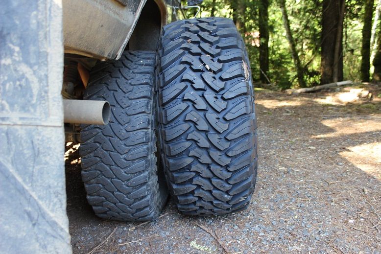

33 inch Toyo MTs
3 inch body lift
Engine and drivetrain
All stock except for 1 piece driveshaft
Axles
D35 4.56 gears
Ranger 8.8 with 4.56 gears and ARB
Other stuff

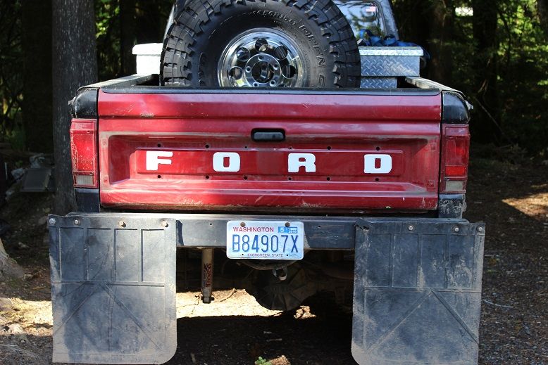

Red tailgate (Red butt). Reason my buddies call it the Baboon!
Hella 500s
Rock Sliders
Booger welded bumpers
New driver side door with electric window delete
Custom window switch
Bunch of small stuff I'm forgetting

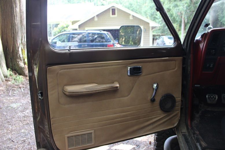

My driver side door got smashed on some rocks so I installed one from a brown 88 ranger. I tried to match the paint.

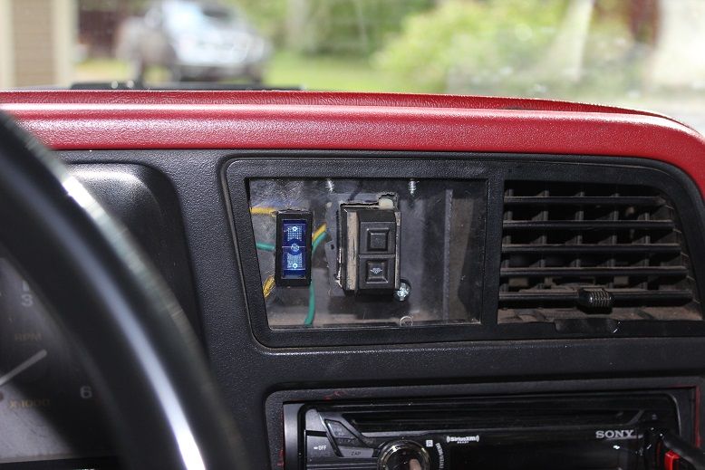

Interior is still brown and manual, so in order for my passenger side window to work I had to jerry rig the driver side switch.
Custom...

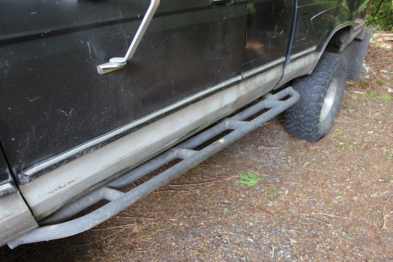

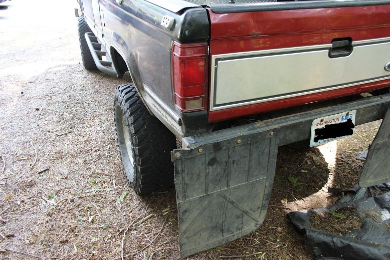

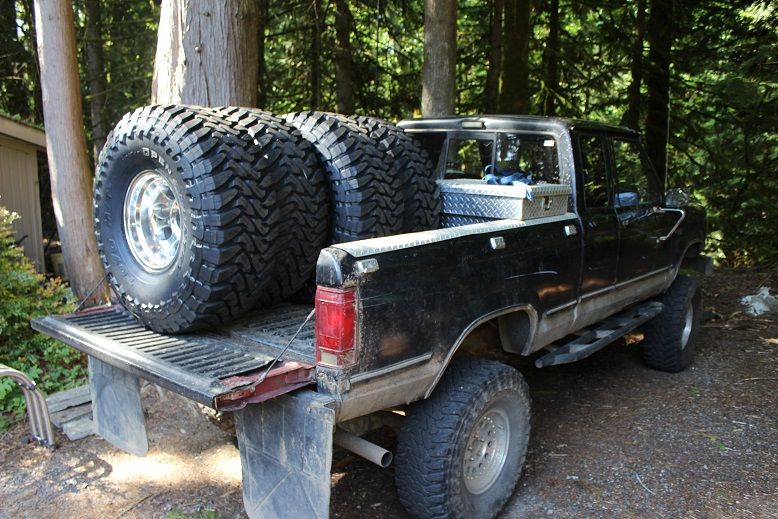

Found these sliders on craigslist. They're for a 1998 or later Ranger, but I made them work by chopping the rear mounting leg off. It was pointing right at the leaf spring mount.
You can also see my body lift in this pic. I'll probably end up lowering it from 3 inches to a 1 inch lift.
Due to the body lift, my 4x4 shifter sat too low so I booger welded an extension together.

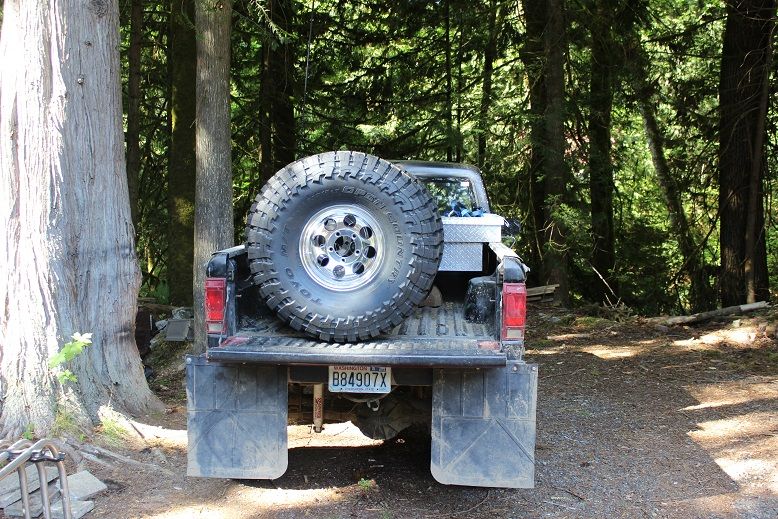

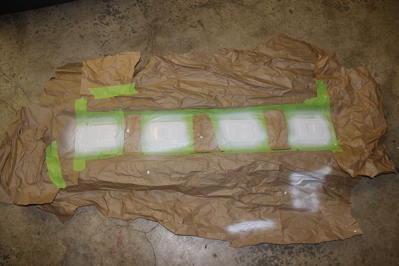

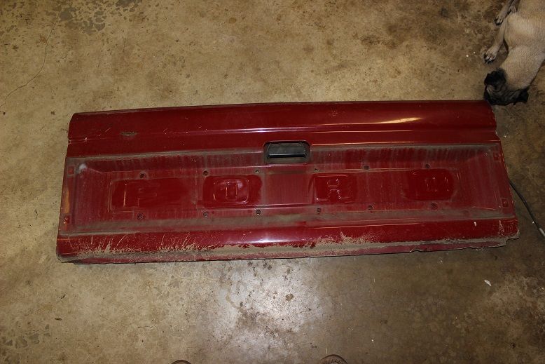

My red tailgate. My tail gate collapsed after a heavy load was applied, so I switched it out for this one.
So that's how it sits now, but I have plans for this beat up Ranger.

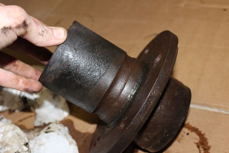

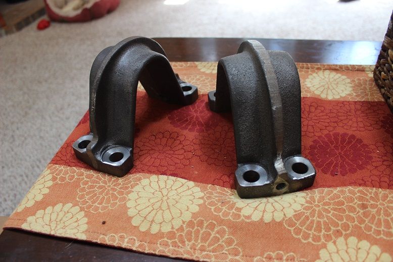

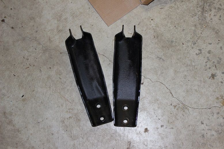

I'm sure some of ya'll recognize what these are...
Skyjacker shocks
33 inch Toyo MTs
3 inch body lift
Axles
D35 4.56 gears
Other stuff
