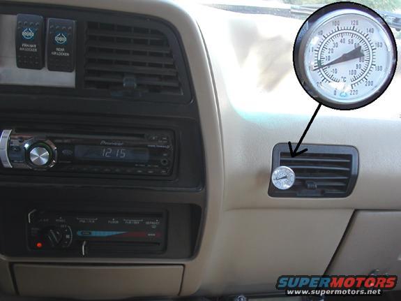

Stick a thermometer in your center-right vent... With the blower on Hi the air coming out should be between 38-45°F. With the blower on Lo, it should be 35-40°F (this while you are moving... it's normal for the temps to rise maybe 10° or so if you're stopped or are stuck in traffic).
If it's a lot warmer than that, I would suspect the refrigerant charge is low or there's some contaminants in the system.
(was about 95°F out when I took that pic)
