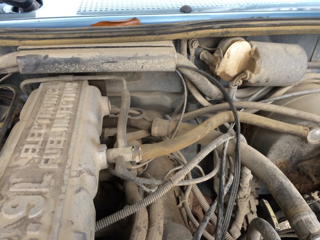

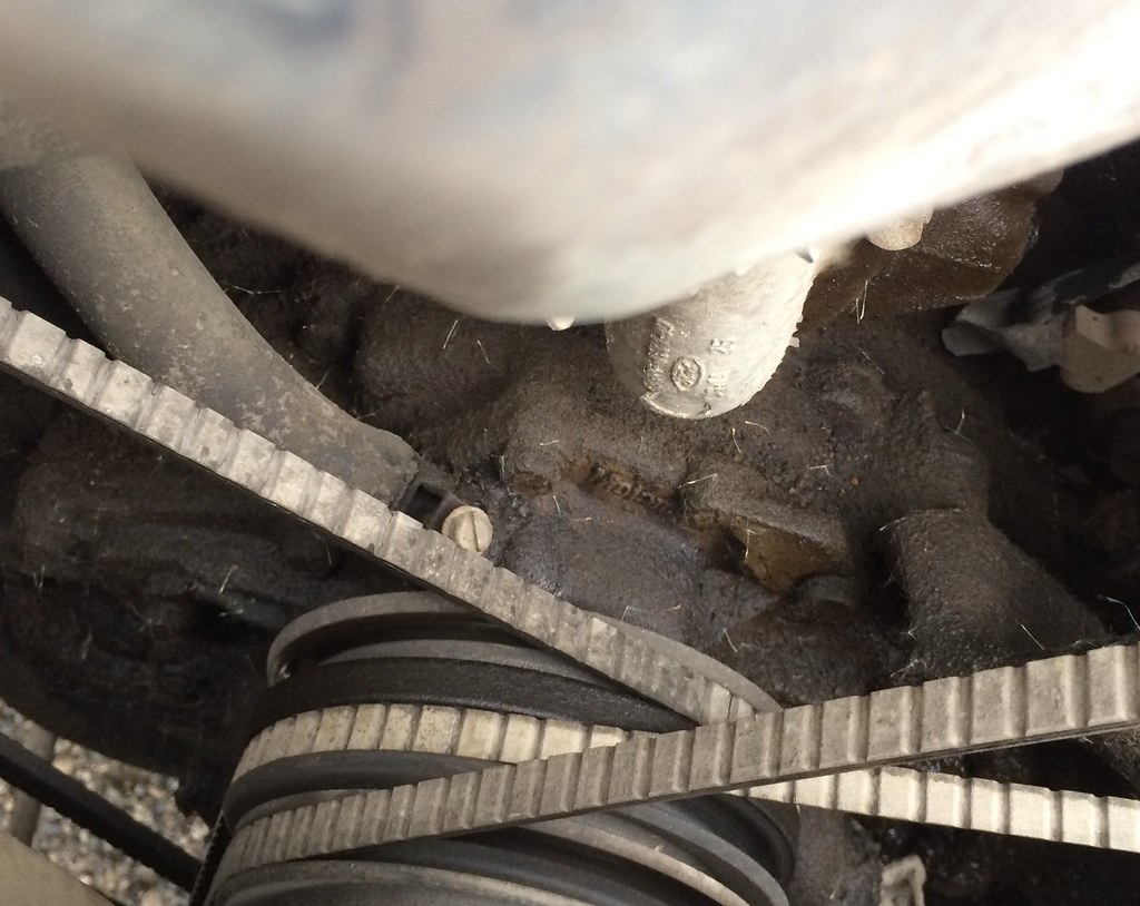

In this picture, you can see where my block heater is, as mentioned in my first post. It's a little hard to see, but it's just about on the right hand edge of the picture, there.

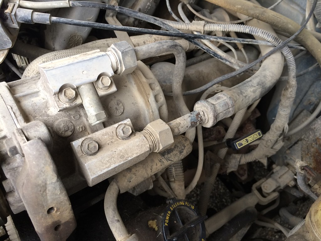

Here you can see the cord coming up behind the AC compressor. It has always come up there. It used to go from there up to the rad support and then out. Now, as you can see, it routes back to the fire wall.

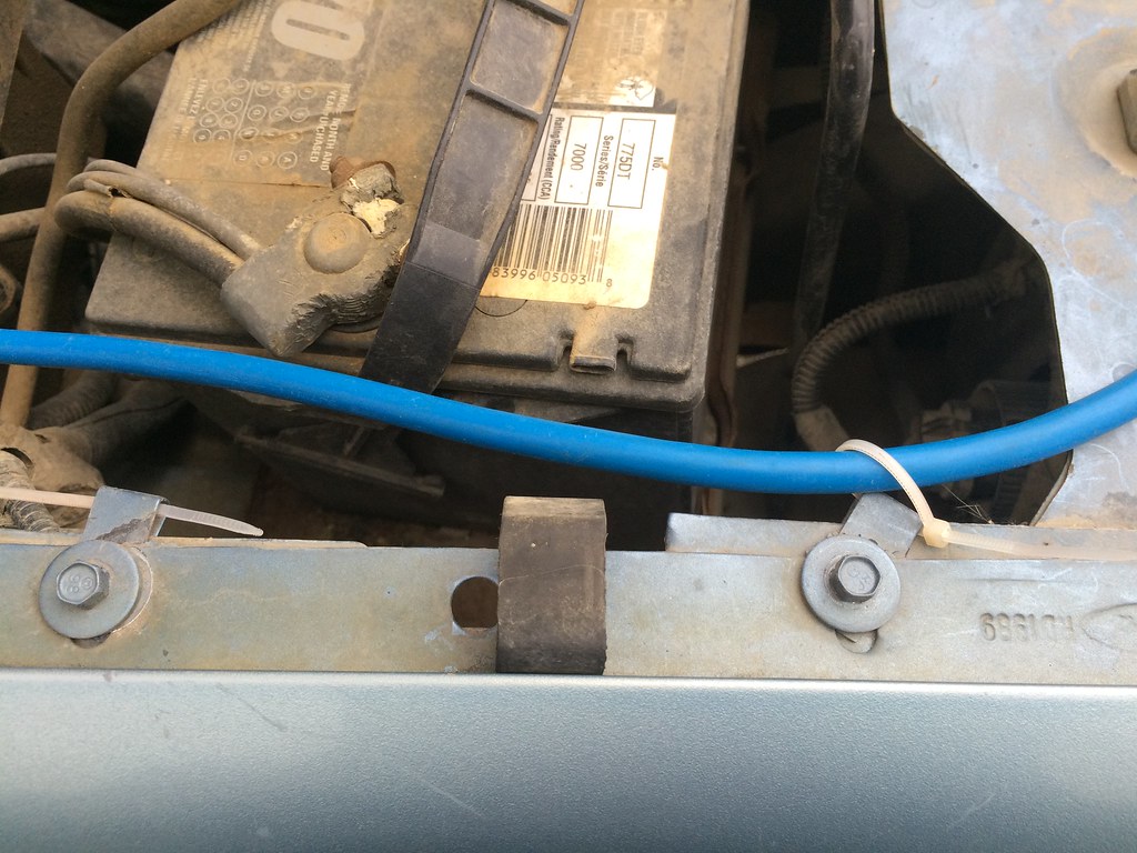

Ford was kind enough to add clips to the fender bolts. I don't have all of the zip ties done up yet (I'm waiting until I have the battery blanket installed), but the plan is that the extension cord will run to the front along the fender here, using the clips to hold it in place. The battery blanket's cord will run to the back of the engine bay using these same clips.
The cord goes through a hold in the rad support (not pictured), and comes out under the grill, beside the right head light assembly, as shown here. I thought about moving it over under the light, but there's a gasket in my way, so it's fine where it is. Besides, here I can pull it back inside in the summer.
