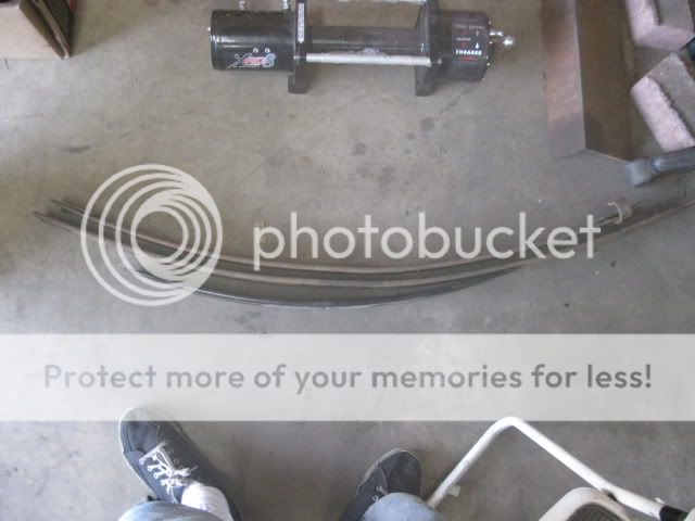

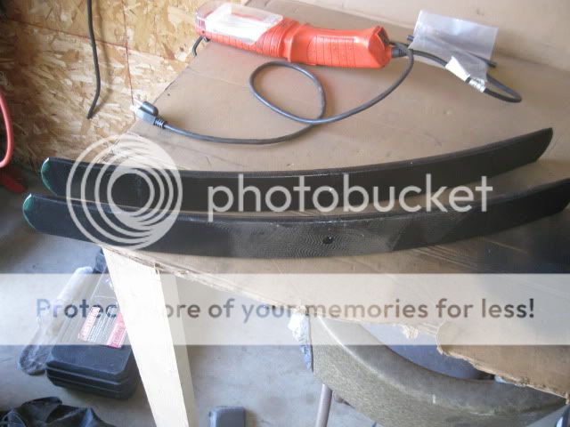

After the axle was buttoned up, I turned my attention to the Wagonner leafs. These packs are stock (at this point). But they’re setup for spring under in the stock configuration, so I had to swap the pin around. Easy as pie, just remember to clamp the packs down so they don’t pop on ya.
Leafs:
Swapping the Pin:

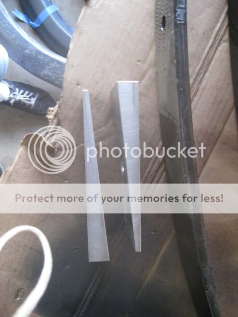

Now that I’ve got this fancy used axle and used springs, I need to mount them to the truck. For the front-rear leaf mounts (mounts close to the firewall) I came up with a boxed in leaf mount. This mount will be somewhat outboard of the frame in this area. The mounts were made out of scrap ¼” material that I scrounged from the work dumpster.
Parts:
Pre weld:
