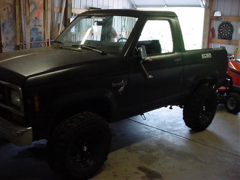

mine is the one on the left, cut the top off at the front of the windows and bottom corners, took the hatch off. cut the rear pillers off just leaving a sheat of metal for later use. moved the rear pillers up to the existiong cab and welded togeather, then re mounted the rear hatch after some trimming, bolted down with angle iron and a little welding, then filled the gaps with great stuff foam sealer, then long strand fiberglass. and the rest is history, but if you need to know anything let me know. I just moved up my wheel wells too, but i havent taken pics yet. will show them to you when i get them done all the way.
