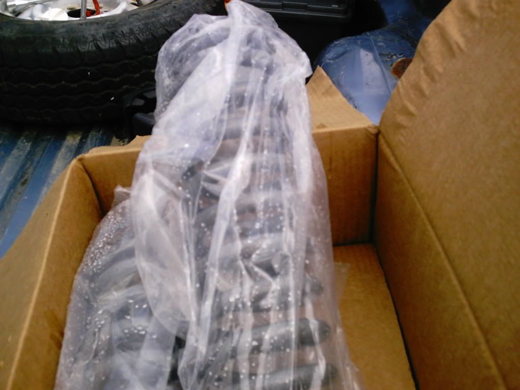

Heres my 1990 ranger xlt i just picked up for 450 dollars, only thing ive done is put a billet grill and a sound system in it so far.... im wanting to make a prerunner out of it... any suggestions?
4" lift coils for front, shocks are coming in the mail and i have a 3 inch lift block for the rear....

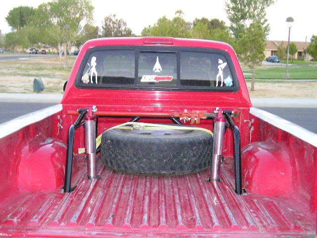

yea im in the process of making a cage similar to this, and could you direct me to a link for long travel coilovers for the rear?

yeah, i ment just long travel shocks, mybad. but heres a quick bedcage plan that i took a few measurements and drew up, tell me what you think...

I would wait till you get you're leaf spring pack that you are going to run, and cycle it before making a bed cage/shock hoops.Along with what shocks your going to use.Not every 16 inch shock is the same length from manufacture to manufacture
fox, king, sway a way(SAW), radflo are the big name's in shocks.
buying used can be a great way to save money too if your on a budget.As they are pretty easy to rebuild if just in need of soft parts(seals) but hard part's shafts, rod ends, etc can add up quick.
