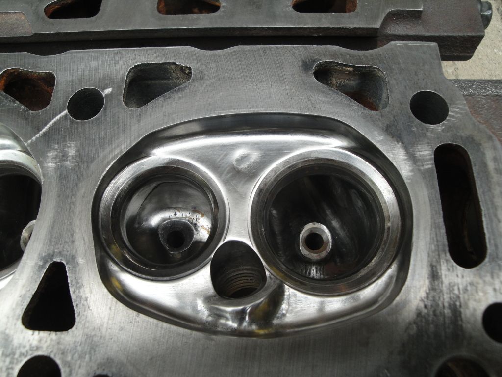

Hey mates, I have the pics of the semi finished heads. How do I post them up?

Made some more progress this morning, I had the short block these heads came off of. I pulled a piston/rod and measured the stack. It calculated out at 8.645". This is using a 1.535 CH piston, measured rod length of 5.535 and stock stroke.
Then I did some looking, using a Ford mod 4.6 self flattop, and a 4.6 mod stroker rod on stock stroke. 1.220CH, 5.85 rod and stock stroke. I have a couple sets of these stroker rods.
All I have to do is narrow up the rod width, and grind the crank from 2.125 to 2.00. I'm not that much afraid of losing cross section, especially if Morana is stroking to another .3 of a liter larger.
My current plan is to buy a new block and crank. I have a timing cover and timing set. I'd only need lifter spider and a good roller cam core. I'm also thinking about scoring a pair of later model aluminum valve covers with coil mount, because when I do the intake swap I need a place for my single coil.
