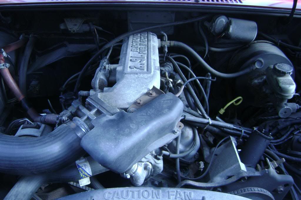

Alright now I have to get the parts together. Here's a before photo I guess of that sad 2.9
