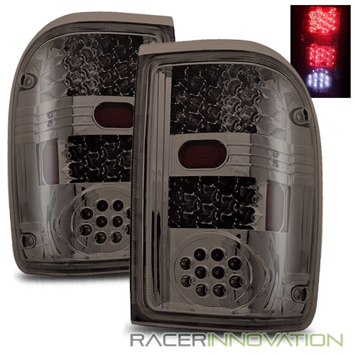

so my cruise control quit working at first it was intermittent now not working at all, after plenty of shotgun approaches and second guesses and trouble shooting, its come full circle to my newly place aftermarket LED lights not bulbs but the whole assembly,
NOW the question is does anyone else have this issue?? and where and how would i splice or place a load resister to get my cruise to working again??

UPDATE TO THIS POST, 05/15/2020
Got my cruise issue repaired,
found out that speed control cutoff switch was issue (the recall fire issue)
here is what I found
part number# Motorcraft SW6350
which says fits and works for the 1995 ford ranger 4.0 engine is "INCORRECT"
(after replacing this part three times)
part number# Motorcraft SW-6349 which says fits and works for the 1995 ford ranger is "CORRECT"
(after replacing this with CORRECT part one time)
SHOTGUN $ wasted to find this out
Cruise is working perfectly AGAIN after 2 years .......
hopes this helps someone else here searching for speed control (cruise control) issues
