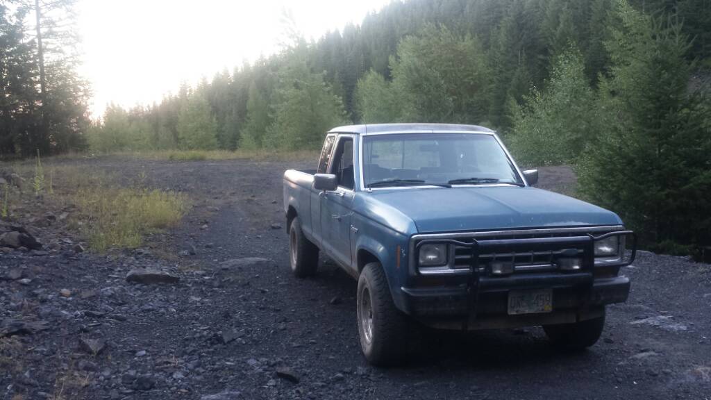

I've never done this before and just want to know the simplest way to do this. I don't wanna screw it up lol
Its just a couple of little guys on the brush guard.
