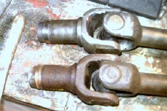

The TTB Dana 35 axle used in most ’90-’97 trucks shares many major components with the Dana 44 axles found under full-size trucks (such as the 5-297X axle shaft u-joints) and uses a hi-pinion gearset for added strength.
The overall strength difference between the front Dana 35 and Dana 44 is quite small, as these axle u-joints are normally the 1st failure point on either axle if pushed too hard (the stock Dana 35 locking hubs excepted, check out: AVM Xtreme Performance Hubs For The Dana 35)
Some Dana 44s are not even AS strong. The early Bronco Dana 44 with its smaller 5-260X u-joints is a good example.
