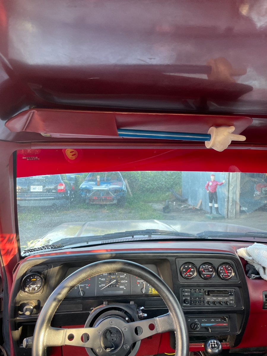

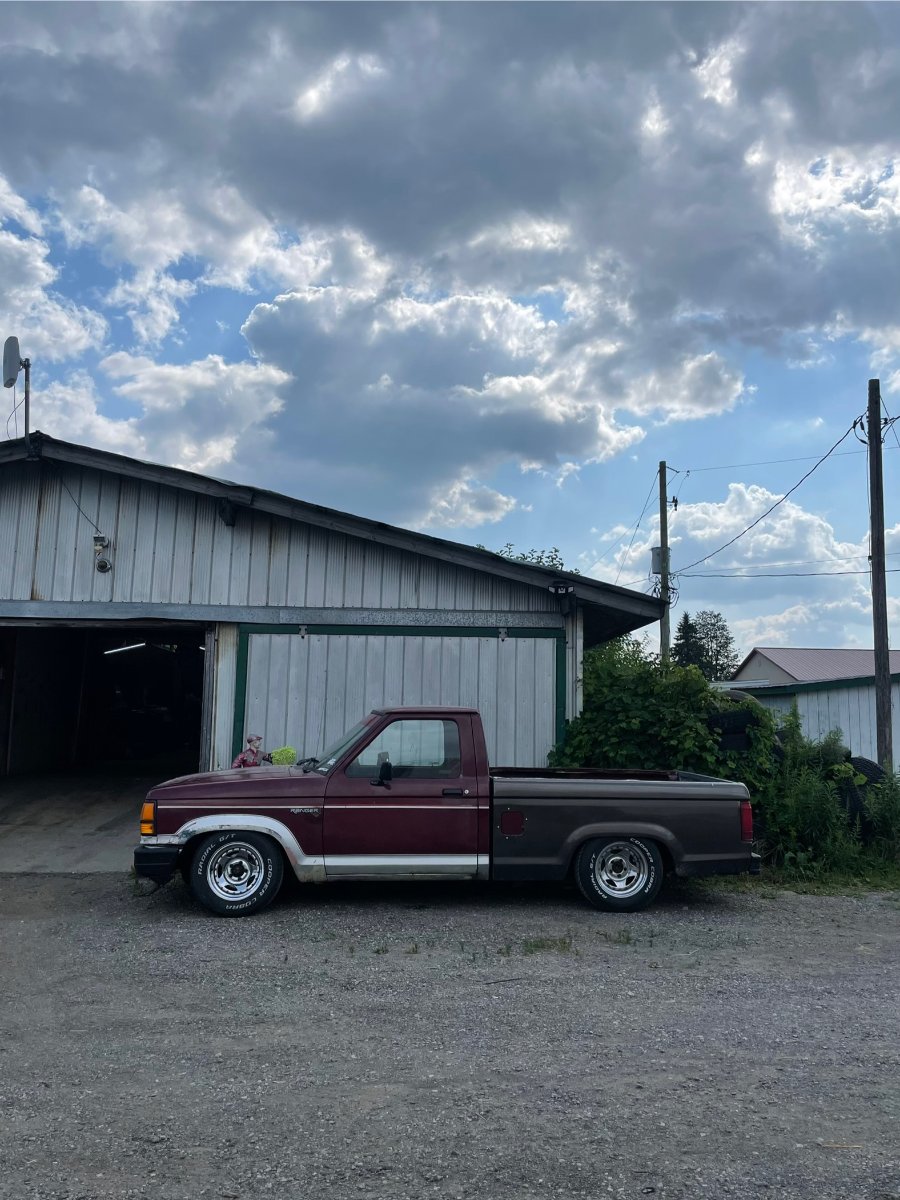

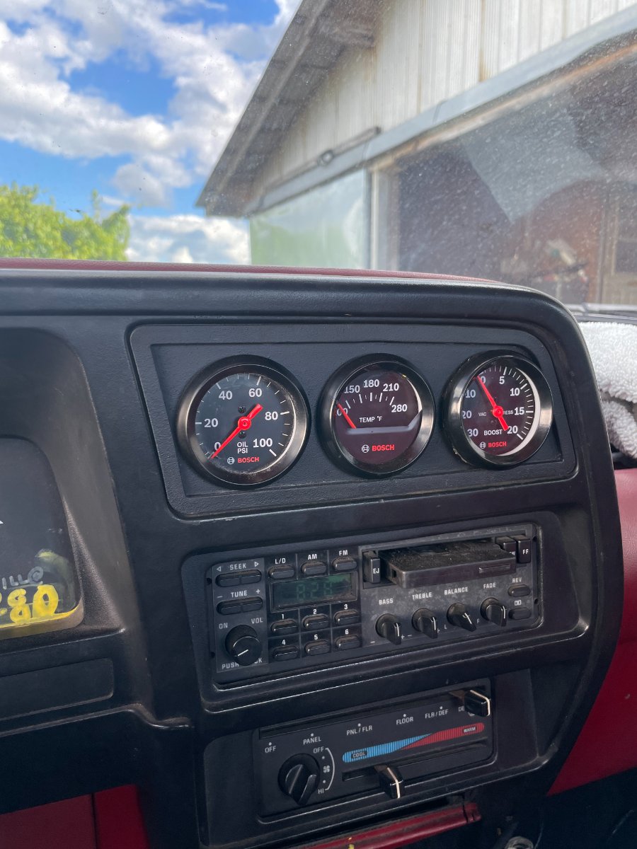

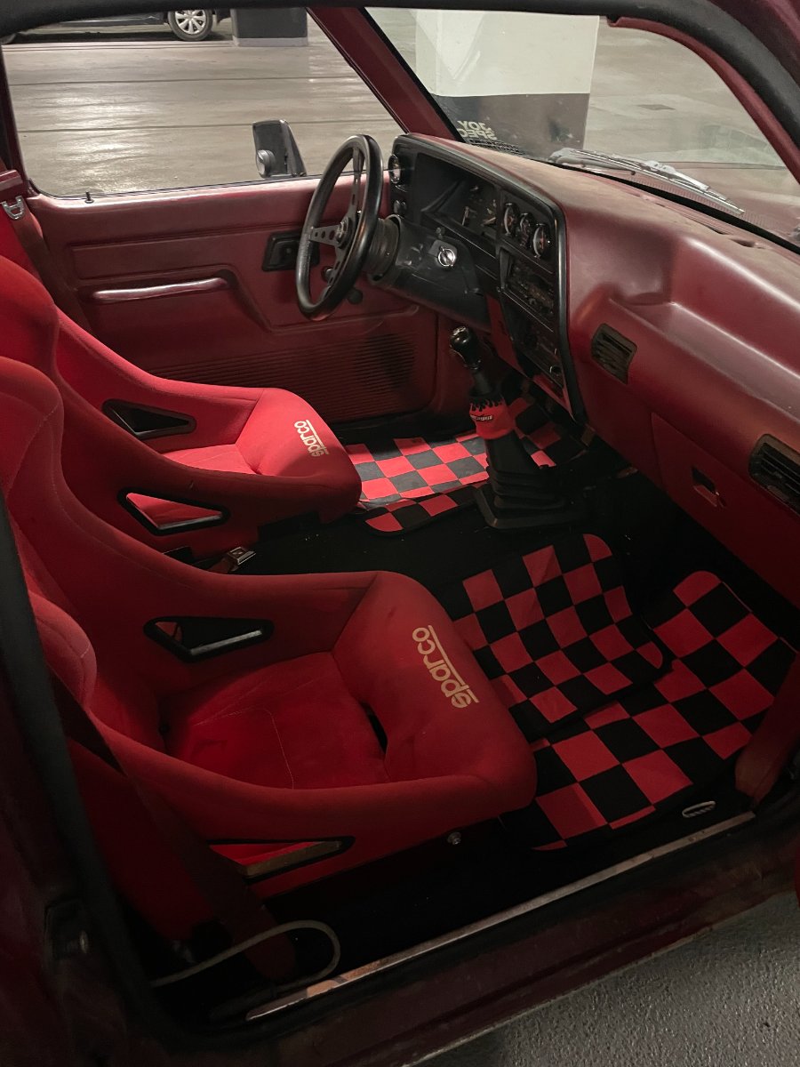

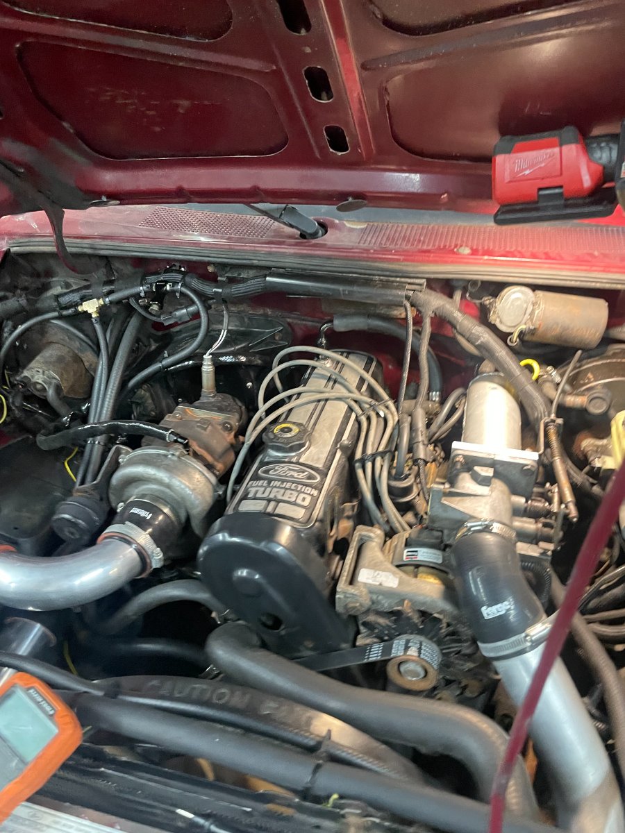

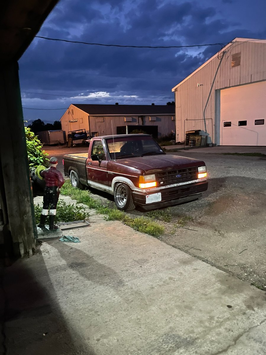

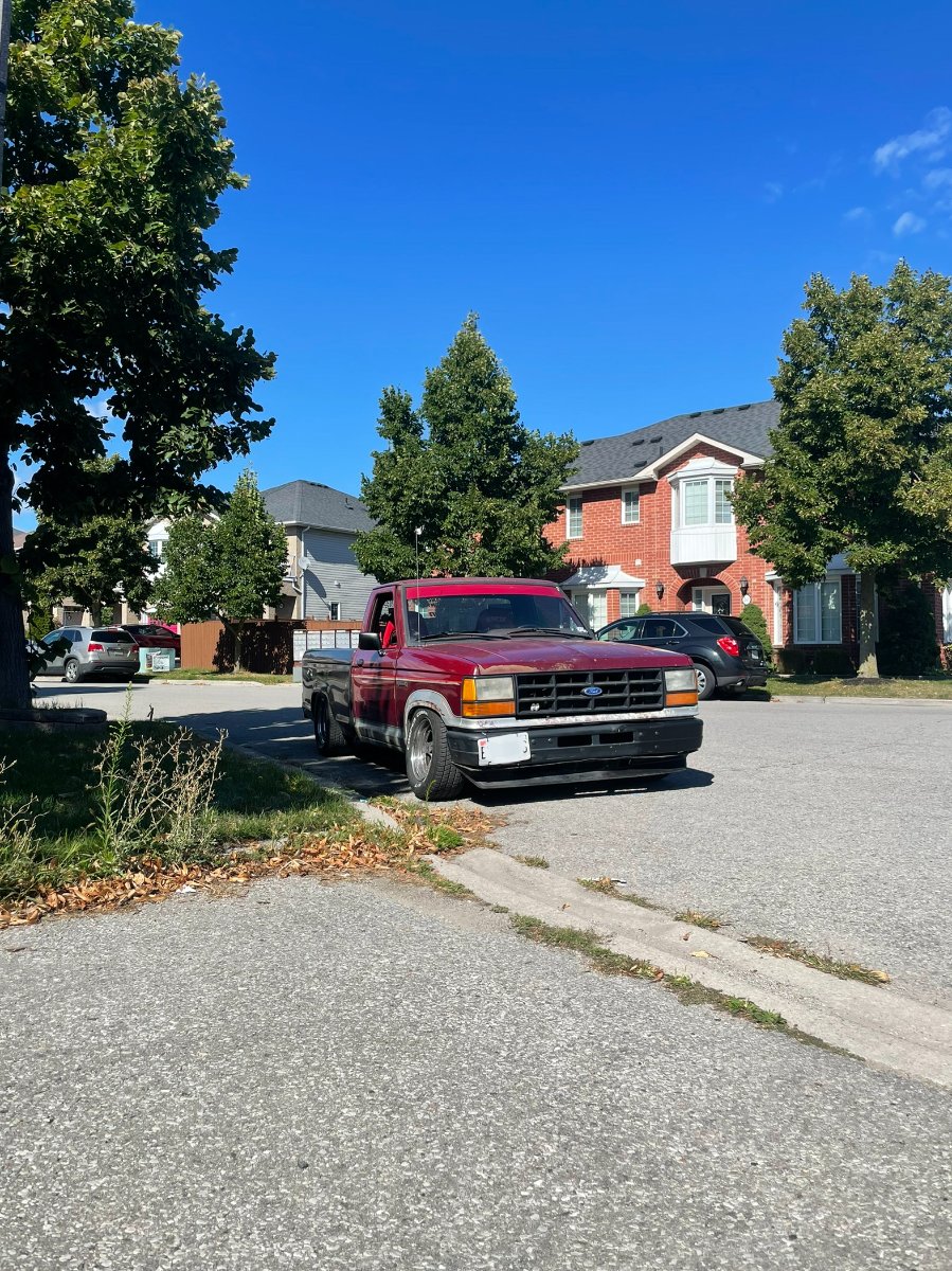

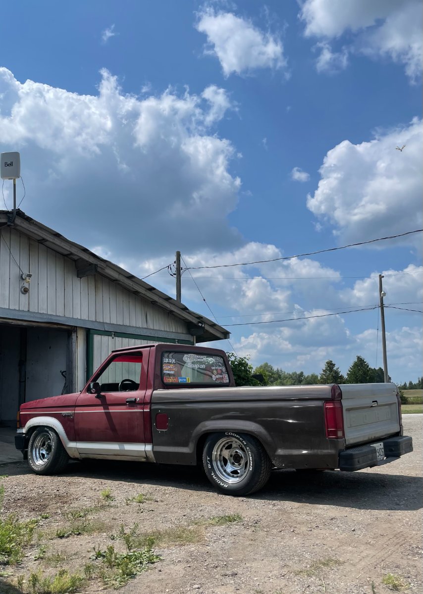

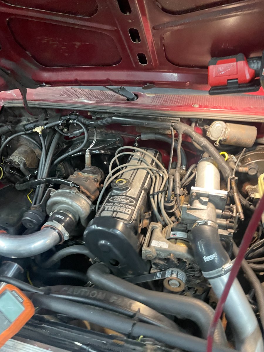

this is my turbo ranger
88 thunderbird engine
GM8 turbo
front mount intercooler
forward facing upper intake manifold
ebay manifold (#2)
3'' exhaust
sectioned oil pan

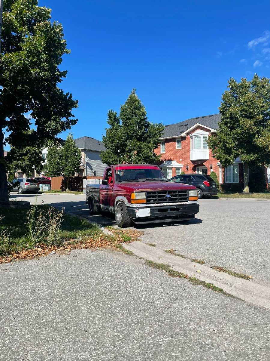

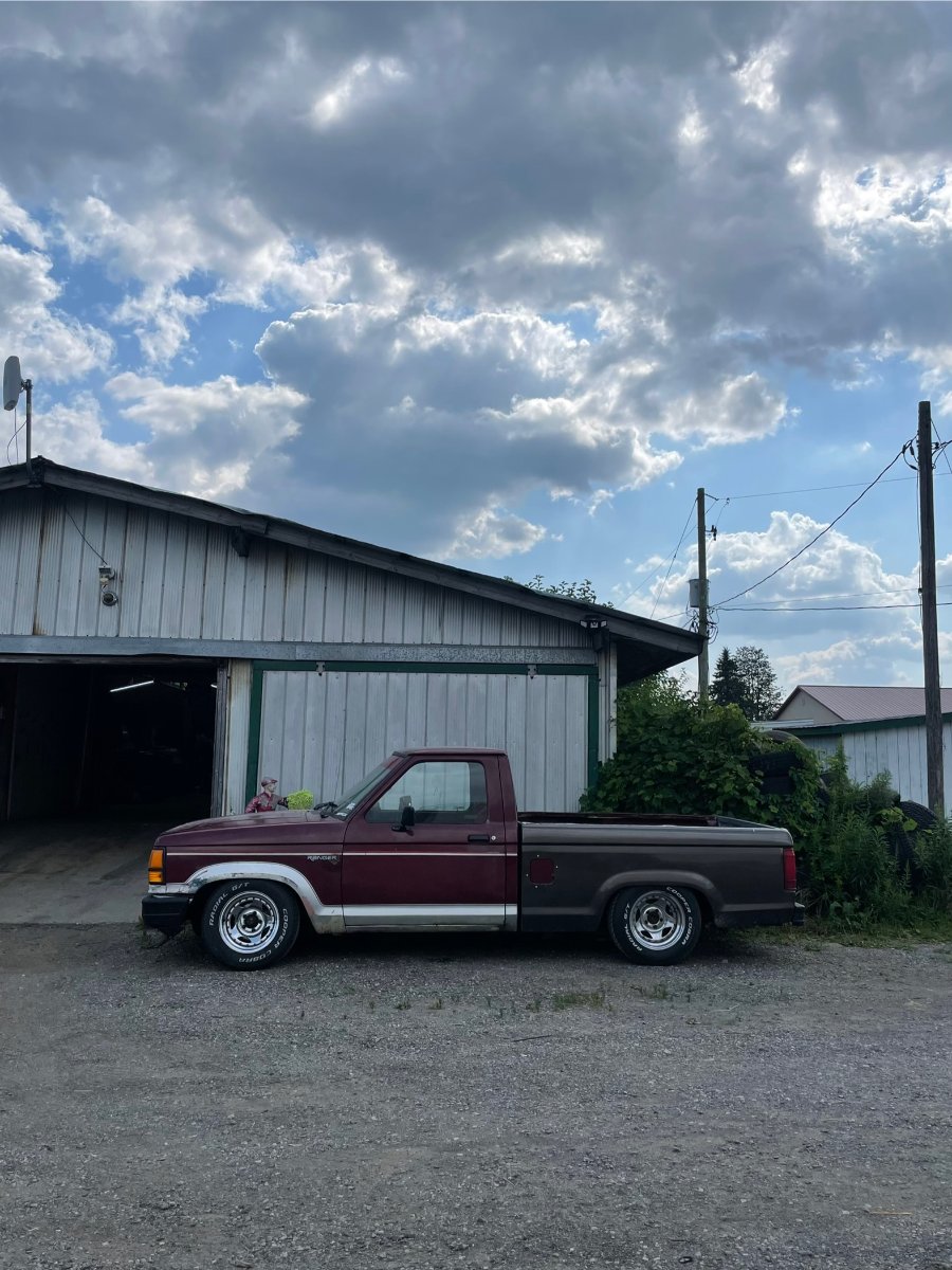

QA1 front shocks w/ lowering springs
Ricks Rangerz Frame Notch
Billstein rear shocks
F150 leaf springs
235/60/14
Volvo lip
fiberglass bed sides

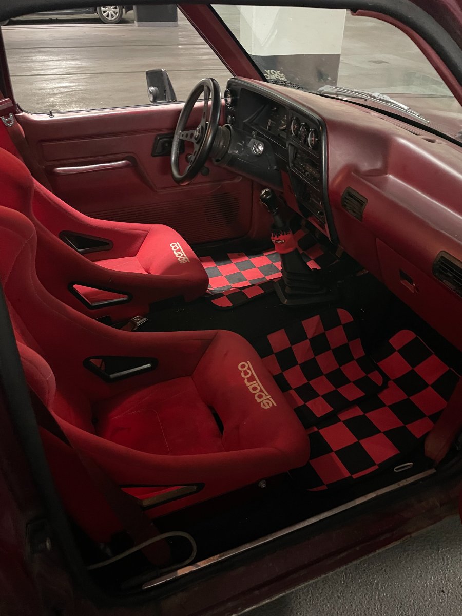

Sparco racing seats (expired last year)
Manual boost controller
Catch can
Roof leaks
mirrors fold in on the highway :/
transmission sounds like rocks

Welcome to TRS. Thats a rad little trucks. Bet it's a blast to drive.
gm8.... i can see it being useful for a 2.3.
not so much for my 6.5.
I like it.
Welcome to TRS.
I dig it, probably would have done a couple things different but I like the '89-92's! Good ol turbo 2.3L's!
For the mirrors if you take them off and grind off the pot metal peened over the spring then drill/tap the posts for like a #6 or #8 machine screw to tighten up the pivots that will take care of that.
If you set all that up rebuilding the M5OD is fairly trivial, kits are cheap or find a replacement from a ~87 through '97 2.3L and you'd be good...
welcome!!! sweet truck
Hi! Sweet truck! 😎

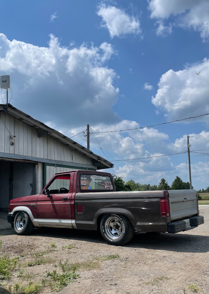

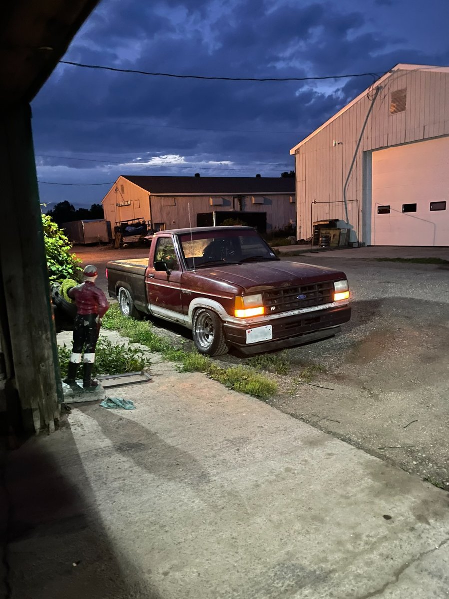

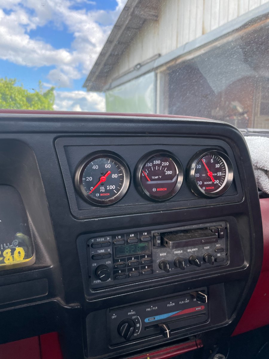

GM8 turbo
ebay manifold (#2)
3'' exhaust
sectioned oil pan
F150 leaf springs
235/60/14
Volvo lip
Catch can
Roof leaks
View attachment 140481View attachment 140482View attachment 140483View attachment 140484
Way cool!
But one question…
….will it GO?
